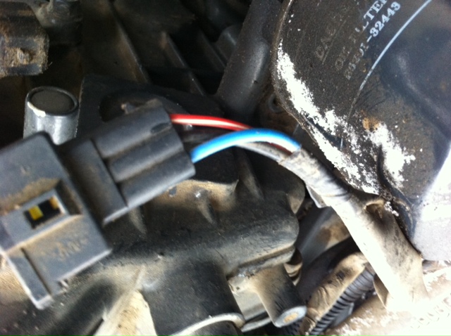

Ok so I removed the connector and it has 3 wires (see pic), which one gets bypasssed?
one is blue, one black and one red with a white stripe through it

Seeing there are three wires going to the solenoid, the pull in one is likely the blue wire as it is larger.
The black would be ground. The test light would confirm this easily.
Invest $10 in a 12 volt test light available at Canadian Tire, Princess Auto or NAPA.
Disconnect the solenoid connector, perhaps heating with a hair dryer to reduce likelihood of breaking it.
Step one would be to determine if Black is ground. Connect alligator clip to + terminal on battery and then touch black wire on the side of the connector away from the solenoid.
If light comes on then I am correct.
Step 2. Connect alligator clip to battery negative terminal. Hold sharp probe end against first the blue and then the red with White stripe.
Try this with someone turning the key switch to see if you find which one wire is getting power when in the key switch start position.
It is likely that both non ground wires are powered in the start position.
Step 3: Find out which wire gets power with the key switch in the ON position.
Once this information is determined it will be possible to say if the problem is in the key switch or a relay or, in the solenoid itself.
Before jumping anything, you need to know which color wire is the ground.

So I went to Case in Winchester to get some info on the wires for the solenoid.
I got the wiring diagram and the black is the ground.
I picked up a tester, like Dave suggested and came home and tested the plug.
1-connected the clip to the positive and the light came on, you were right Dave, but then I connected to the red and the light came on as well. This is with the key off.
2-key on, same thing.
All of the above steps, there is no power to the blue wire.
By the way the diagram is as follows
-Blue-hold
-Black-ground
Red-pull
3-Cranked the engine with the clip on the negative terminal and the probe on the red, light went brighter and flickered on and off. Hmm, something must be not connecting properly somewhere. I could hear a sound, as I was turning the key from on to start, on the firewall in the engine compartment near the cab, as I was alone I couldn't`t check it. It was as if something is connecting and loosing connection. So I left it alone till my wife got home so I could check it. There was no power to the blue wire in any of the steps
Then later I charged up a battery, and used it to get more cranking amps, because its so cold that the tractor battery would not crank very long.
I rechecked the blue and now it was getting power, so I plug the connector back in and fired up the tractor, which started after a short while of cracking, Praise God, for that.
I used all afternoon yesterday, but didn't shut it off.
So now I will go and try it again.
This leads me to think that this may be more of a connection or key contact as was mentioned in this forum before.
Will keep you all posted and thanks very much.
