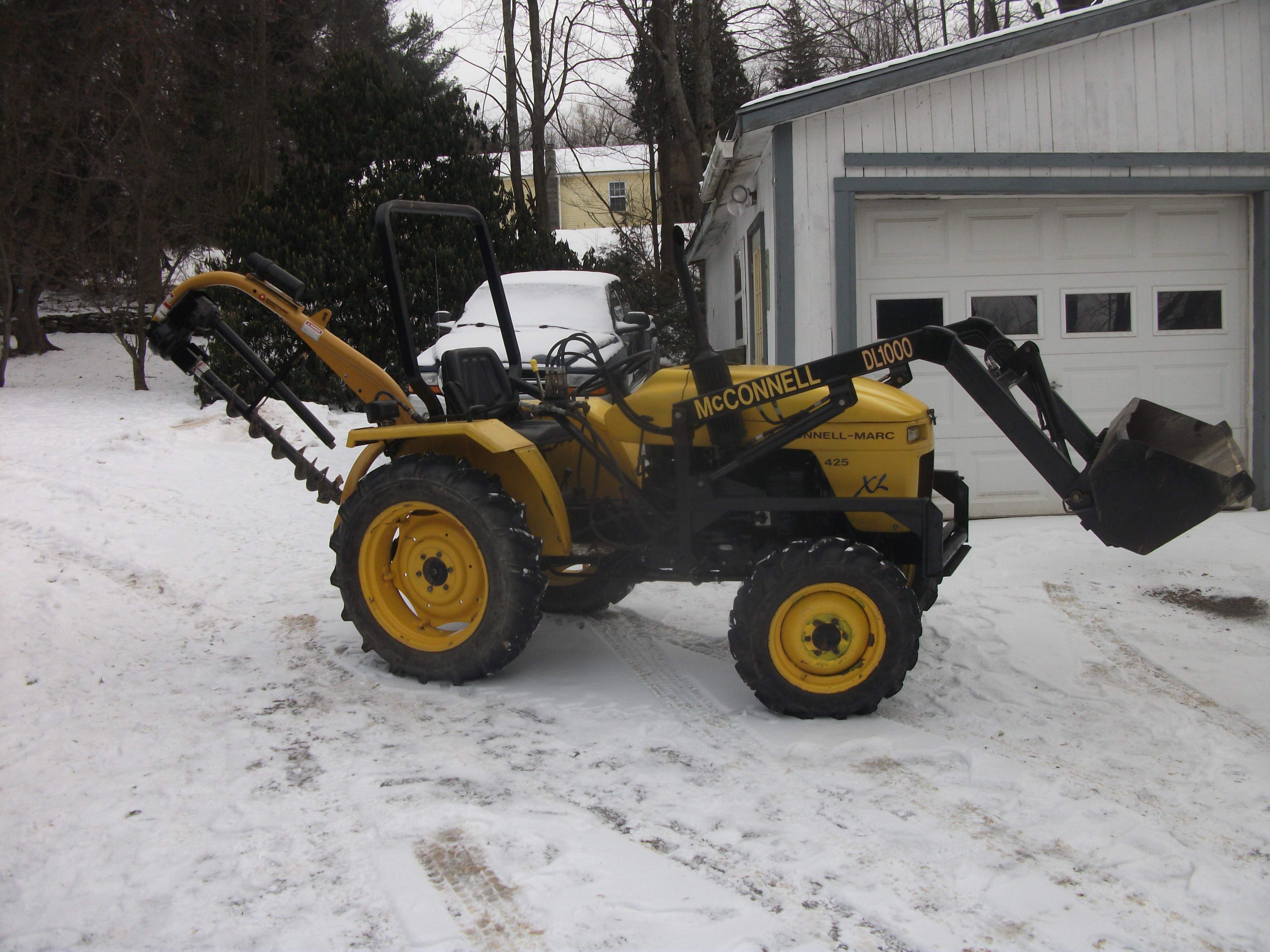

Hi ,I have a MCconnell Marc 425 XL , I think it is built by Jinma and nearly the same as Jinma 284. The tph has issues lifting when it feels like it, Also today after using fel for awhile the engine started sputtering and smoking when revved up. then all at once it blew oil out the breather on the right side of the engine. Shut it down quick. oil was over filled. Drained out more than 2 gallons filled up with 6 liters and seems fine now. Coollant level is normal , Fuel tank still full, Maybe Hydro fluid in oil, The fel and steering is slow to not working when cold. I need to get this tractor working proper.I need a new oil filter, and the filter under seat in hydro sump.Would like info and ideas on getting this tractor working.Thanks.
ps The hydro fluid looks clean, The hydro oil in the rear sump for tph looks cloudy and aerated, Are there seperate pumps and sumps for thp and fel ,steering? The only time the tph worked was when I filled it and then it bubbled out arond lift arms and plug.

Sounds like a Jinma. Jinma's have a tendency to blow out the seal on the hydraulic pump, which results in hydraulic fluid entering the engine sump. Sounds like that is what happened to you. The usual cause is restriction in the hydraulic lines, there is no pressure relief and if the pressure is allowed to get too high the pump suffers.
The most common cause is the quick disconnects for the FEL coming apart.
You need to find the cause of the obstruction. Then you need to find out if your pump is blown or just the seal. Then the hydraulic fluid level. Both the steering and the FEL rely on the hydraulic pump so once you're hydraulics are working those should shape up. In cold weather the hydraulics on mine tend to be slow until the fluid warms up a little.
The balky tph lift cylinder is a common Jinma problem and probably not related to everything else, it's usually fixed with a new seal.
/ MCconnell Marc 425 XL #3
It's the same old issue. Get rid of the quick connect fittings and replace with swivels. Then fix the pump seal, change engine oil and hydraulic fluid with filters.

Yes, they can be restrictive internally. The Chinese QC leave a lot to be desired.

I traced out all of the hydr lines and find a line coming out of the spool thru byd port and one out the output port . the one from out goes to a tee. the tee connects to two hoses .one goes to back of tractor to a qc that is connected to the hose back to byd. the other side of this tee goes to the divider valve,then out of divider one goes to steering and one goes to ift control, and a 4th goes to return to tank which is teed into return from steering. there is a relief valve in the spool but do no under stand where relieved pressure would go? the spool is feed directly from pump. thanks Ric

I traced out all of the hydr lines and find a line coming out of the fel control valve thru byd port and one out the output port . the one from out goes to a tee. the tee connects to two hoses .one goes to back of tractor to a qc that is connected to the hose back to byd port. the other side of this tee goes to the diverter valve,then out of diverter one goes to steering and one goes to tph lift control, and a 3rd goes to return to tank which is teed into return from steering. there is a relief valve in the fel control valvel but do no under stand where relieved pressure would go? the fel control valve is feed directly from pump. thanks Ric
http://www.generalimp.com/sites/defa...ers_dl1000.pdf this is the loader I have.
erj ,mine is like yours except the byd port being connected back to the out port, I think there by disableing the relief valve in the fel control valve. I think it had a back hoe at one time. Today I un coupled the two lines and then it will not lift fel at all. New pump is on the way.With those quick disconnects undone do you think the pressure relief valve in the fel control valve will protect the pump.?
Take a close took at the photo in my first post and you can see the line out of byd port, then look by the back light a you can see the quick connects together. I have unconnected those two lines . It does not seem like they should be connected, Thanks Ric

Ric, I would:
1. Remove the hose that goes between the Power Beyond and that tee. Plug the PB Control Valve outlet and also that now open tee outlet. I don’t think that it is a good idea to ever leave QDs disconnected.
2. Get a pressure gauge to hook up between the pump and the inlet for the FEL control valve to see what pressure is being generated. I would do this before I installed a new pump.

thanks erj, I have very limited hydraulic knowledge and believe that the only dumb question is the one not asked, That said on my kelley dl 1000 fel and controls, should I be suspecting the four QC on the loader control valve as a possible obstuction and cause for deadhead of system?
/ MCconnell Marc 425 XL #15
The 4 QCs could possibly be a problem. First let's get done the 2 items I previously mentioned. Once a pressure gauge is on there, we can look further.

Ok I have another question. first off I am woking on taking the power behond off I had to order a plug to go where the power behond conversion plug is . Is it possible that uncoupling the quick connect with engine running that was at the back of the tractor caused the dead head? This would stop flow thru the power behond

I just removed the pump and pushed the seal back in position and put the pump back on.. First time running with new pressure gauge.The engine was overfull and the hydro was way low. I then took a video of operation of fel with gauge . What should the pressure be running at? I have a new pump but will wait to put system pressue relief check valve on before installing new pump hydraulic gage 004 - YouTube

At the end of the stroke it should have reached 2000 psi minimum. You have a damaged pump.
Replace it.

As Chris mentioned, you should have at least 2000psi when controls for FEL go into 'relief' mode.
I suggest:
1. Get that plug installed for the Power Beyond.
2. Get that Power Beyond hose removed.
3. Plug that Tee at the other end of the PB hose.
4. Repeat what you did in the video and see if there is any change in pressure.
You now have 2 outlets on the FEL control valve that are feeding fluid into a tee fitting that has only one outlet for going to drain. I don't know for sure, but I suspect that can affect the reading that you saw today on the pressure gauge.
