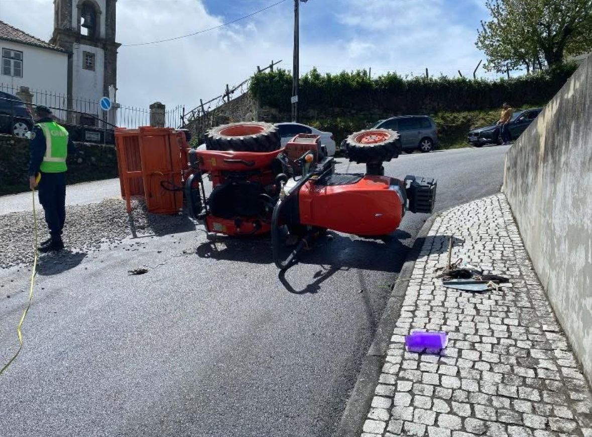

This one just happened this morning. Not a single injury as the ROPS was up as it should be.
Looks like a Kubota L2-552 pulling a trailer loaded with gravel that jackknifed on that downhill turn and ended up on its side.
Just a wild guess here, but the hydraulic trailer brakes may have never been connected to the either the remotes or the hydraulic brake valve (if fitted with one) on the tractor, which would have most likely prevented this situation.
Another possibility was not having both brake pedals locked together.

Sure looks to be a odd location for the ROP.. No doubt they worked but the use of it doesn't sound very typical either. Farm etc.. On the rd. incline pulling a trailer speeding couldn't stop On and On. Lucky the driver didn't get it UTDA.... roll over!

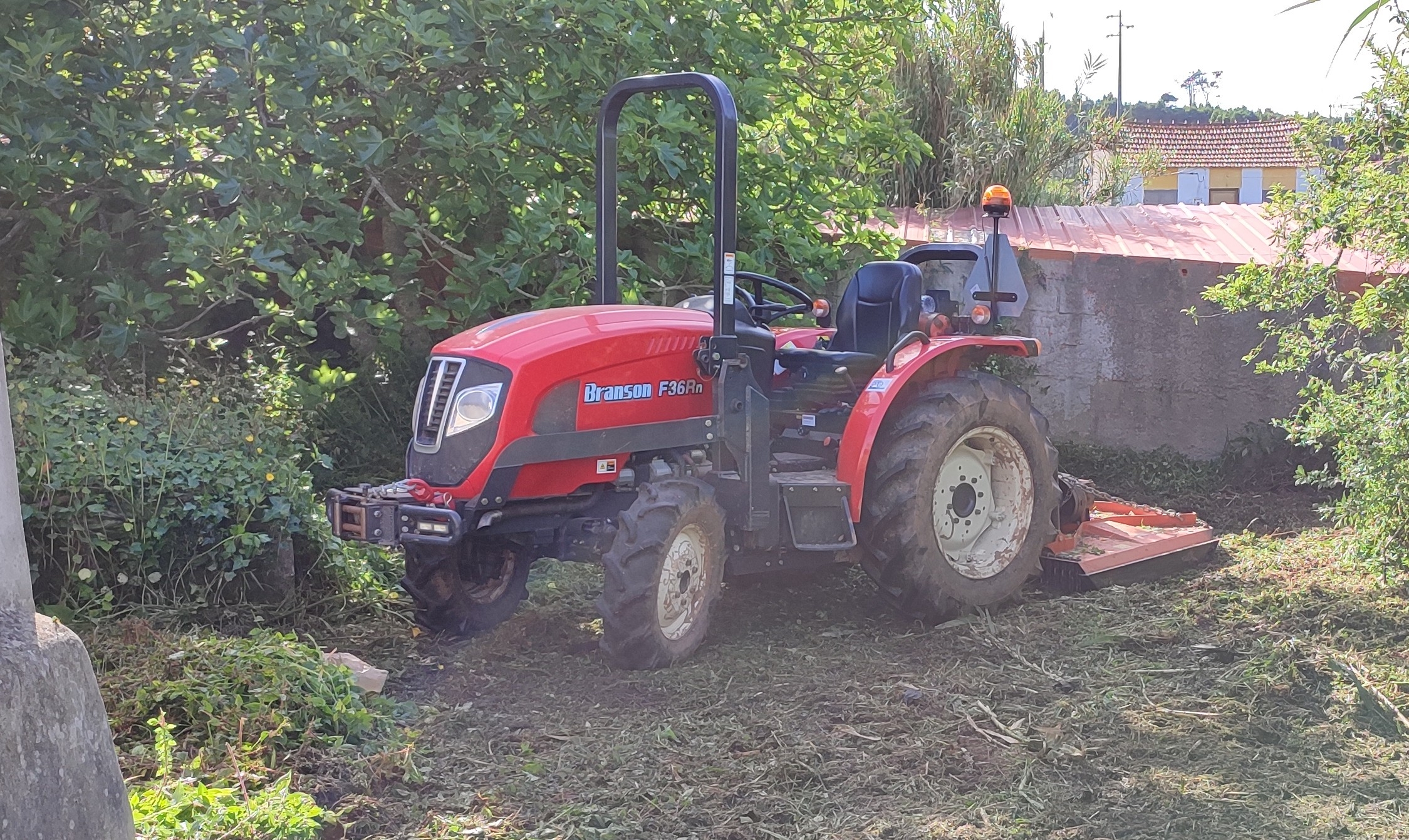

It a mid mounted ROPS. A must have when you have to work in orchards and vineyards. The way it folds, makes for a much lower profile than a rear mounted ROPS allows too.
These pictures should give a better perspective.

Easier to raise and lower was my thinking. The odd location.

Less likely to catch and backflip the tractor…

How the ROP is mounted like a FEL. no doubt impressive safety and operation choice. JS..
