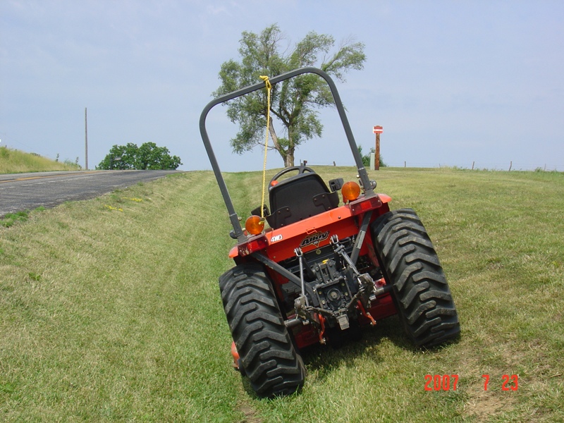

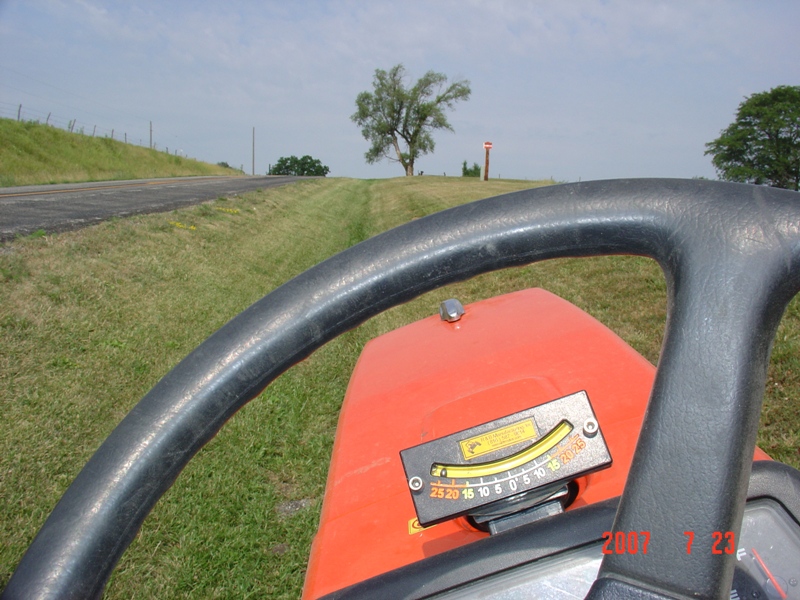

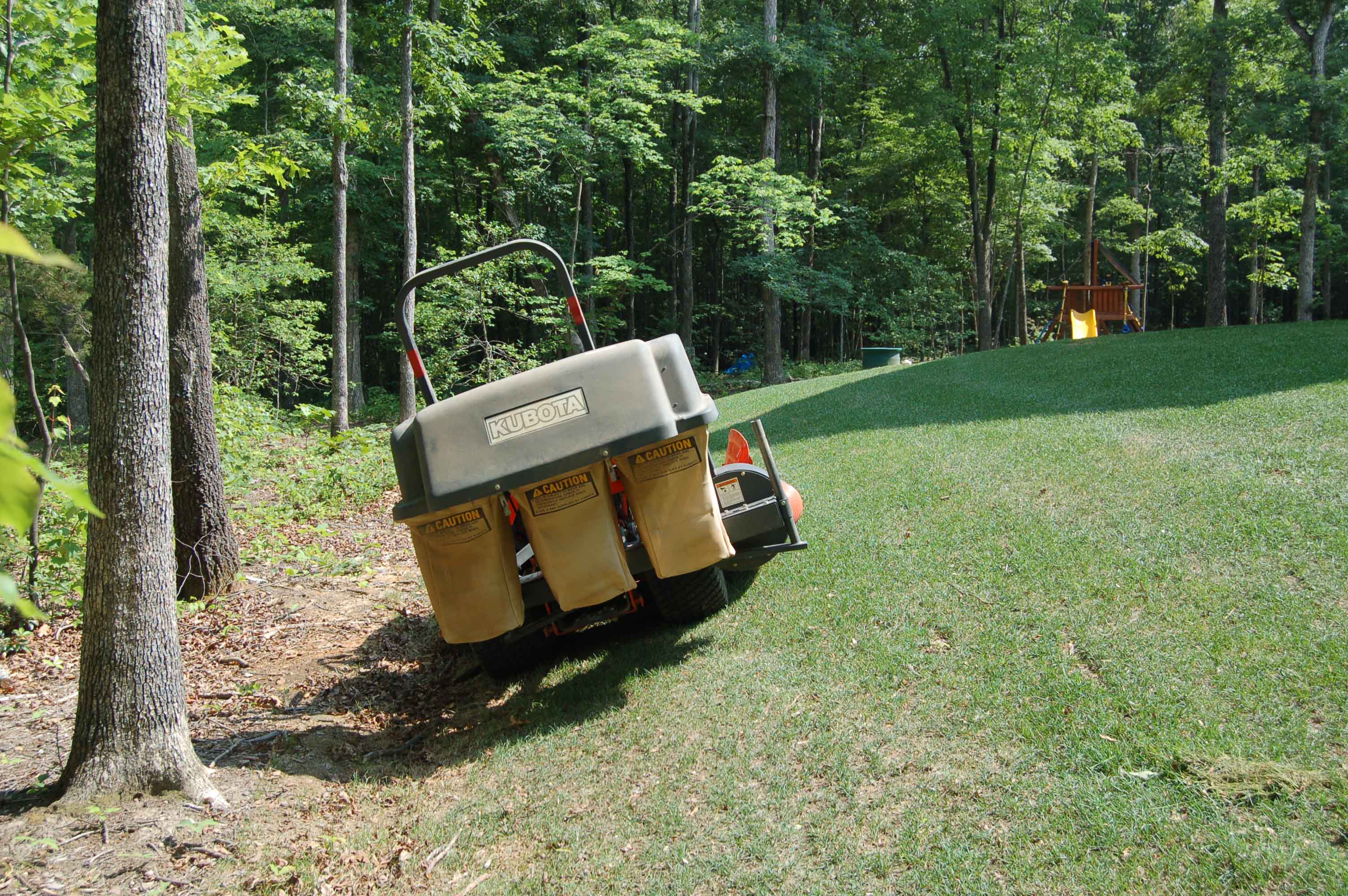

I've read several threads in the past regarding how steep of sideslope a tractor can be operated on. This past weekend I was mowing the roadbank and these discussions came to mind. I went to the house and got my camera. My Kubota B2910 has a Tiltmeter on the dash so I parked it on one of my slopes for pictures. The Tiltmeter just goes to 25 degrees so I picked a spot with that angle. I have spots that are steeper and I mow them regularly but when I do the little silver ball in the tiltmeter disappears off the window and I didn't want everyone saying there was something wrong with my gauge so I picked a spot where the ball is visible. I also tied a rope on my ROPS bar with a weight hanging from it creating a "plumb bob" for those that might question the accuracy of my tiltmeter.
My B2910 has filled rear tires and factory wheel spacing, front tires set in. It mows these areas with no indication of being anywhere close to tipping over.
My disclaimer here, so everyone don't get all crazy, is that you should always use your own judgement when doing anything that might cause injury on your tractor. For me and my tractor, 25 degrees is a cakewalk and I do it as fast as it will run in mid range. Now fire away!!! ;)

/ Maximum Hillside Mowing #2
Although my tractor has ag tires (R1), I tested it under actual mowing conditions on a much steeper bank. It will just slide down the hill, nose first. If you need some data, I can get it for you because the hill, grass and path is still there. Most tractor + tire combinations are designed to slide before rolling. The lawyers have seen to that.
In my case, I release the linked brake pedals so i can use left or right brake steer to keep me aligned with the original path when mowing.
My hill is considerably more inclined than the one you show.
If you ever get a chance to check the sidepull ratio of your tractor, do it: Use a tilt bed trailer or other mechanism (another tractor with a loader) to set up your tractor on an inclined table and measure the angle of 2 wheel lift. Use some weight on the seat to simulate your butt.
Its actually pretty steep angle. It will have a tendency to reveal the 4 wheel slide angle to you. Having weighted rear tires and spread way out is the only way to go. That ensures that the fronts give up first on grass and down the hill you will safely go. Keep some paper towels handy.
Now let's hear back from the National ***-ocean of product liability lawyers...

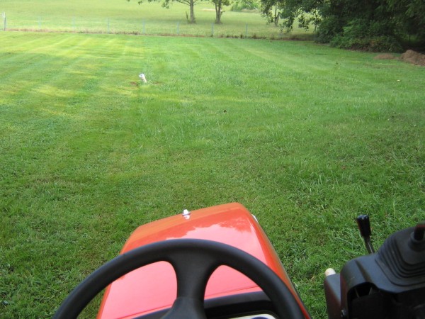

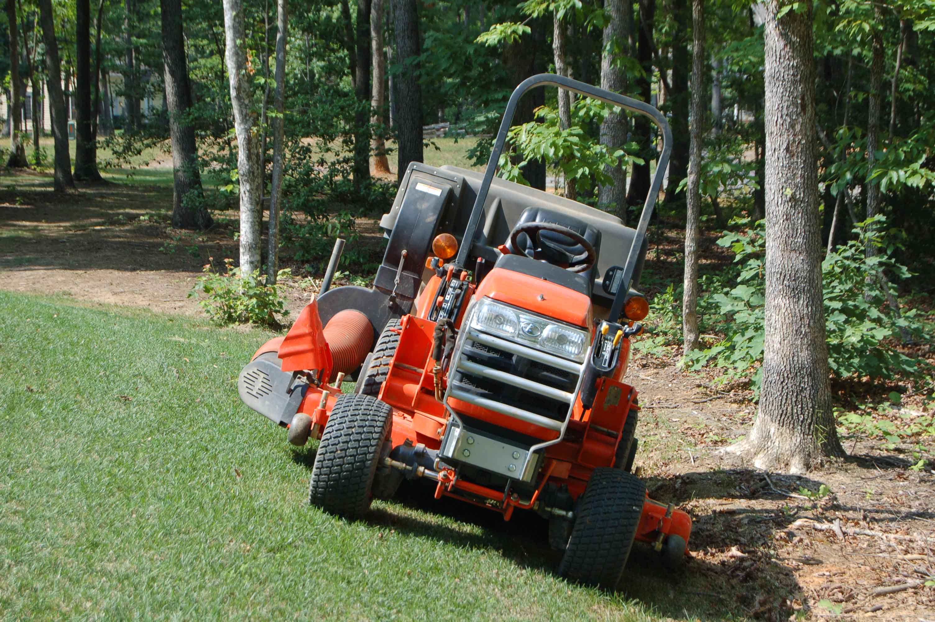

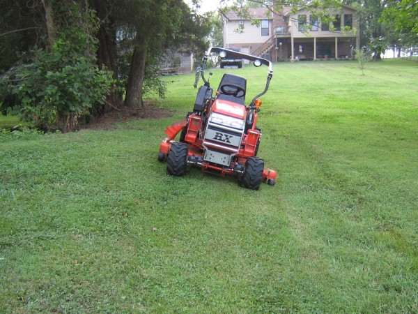

/ Maximum Hillside Mowing #3
Funny about this thread. I was planning on starting a similar thread showing how daring I was and how crazy-steep the slope was that I regularly mow on the side of my house.
Then I took these pictures. Looking at them, I feel like a granny. Not that the tractor is really close to tipping over, but it is angle enough that I only attack the slope "clockwise" so the weight of the OEM Bagger Impeller is on the uphill side of the slope. If the thing starts going over, it's not like you're sticking your leg out to right the thing like a Craftsman in a ditch. If you get off the tractor, you still can't lift the uphill rear tire by pushing on the ROPS (a test I did before mowing this area), but you can tell there isn't much weight on it, either.
In my configuration, I have bolt-on weights in the back wheels (~80# each side) and do not have filled tires.
I cannot (or will not) attack this slope with the FEL/BH attached. Just feels like the COG is way too high. Again, maybe I'm a granny, but there is only so much risk I'll take with life and limb (and expensive tractor) at stake.
And regarding getting any closer to "the edge", all it takes is LITERALLY a clump of dirt, a big stick, or some other seemingly innocuous object to shove you right over. Or a small hole on the downhill wheel. Anything. It can happen just too fast to risk.

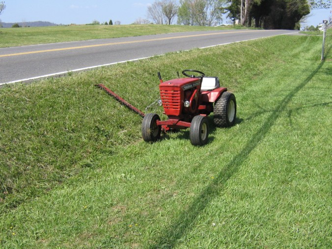

I took a few pics awhile back showing some slopes my BX23 mows on without problems. The bank out front has way too much slope so I mow it with a different machine :D

I like the look of that little mower with the sickle bar mower. Could you tell me more about it please?
Sure :D
It's a 1966 Wheel Horse 876 I picked up from the original owner last winter.
After replaceing the carb, fuel pump, sparkplug & lead, fuel lines and a couple seals in the HST, it's a very mechanically sound little tractor now. The sicklebar mower came off of my 856. This winter it's going to get refinished. I expect it'll outlast me.

It's a shame you didn't do the "Plumb Bob" trick for an indicator. I'm guessing by how you don't even leave a track that you aren't much past 15 degrees. To stay on a 25 degree slope you have to use 4wd and sometimes the high side brake.
I agree with you about different implements changing COG. I won't try anything like this with my 5' brush hog on the back, too much swinging around.

I have a perfectly female explaination for that...... We bought the Kubota while I was in Iraq. Terry picked it up, hauled it home and started mowing with it. I had no idea what angle it would function at having never been around a B2910. I told her to stay off the steep stuff and use the JD455 which she is familiar with. One day I saw the add for Tiltmeters. I ordered one and she installed it. Then I asked around on this sight about how steep that particular tractor would run. I was generally told to not exceed 18 degrees. So that's the standard I told Terry to use.
When I got home I quickly realized the tractor was capable of more than that. Now, for me, the Tiltmeter isn't necessary. Actually I use it for entertainment when I get it leaning so steep that the air bubble inside it switches sides!!! :p
So if you guys want to make fun of Terry for using a Tiltmeter, I'll go get her and let her respond!!! ;)
