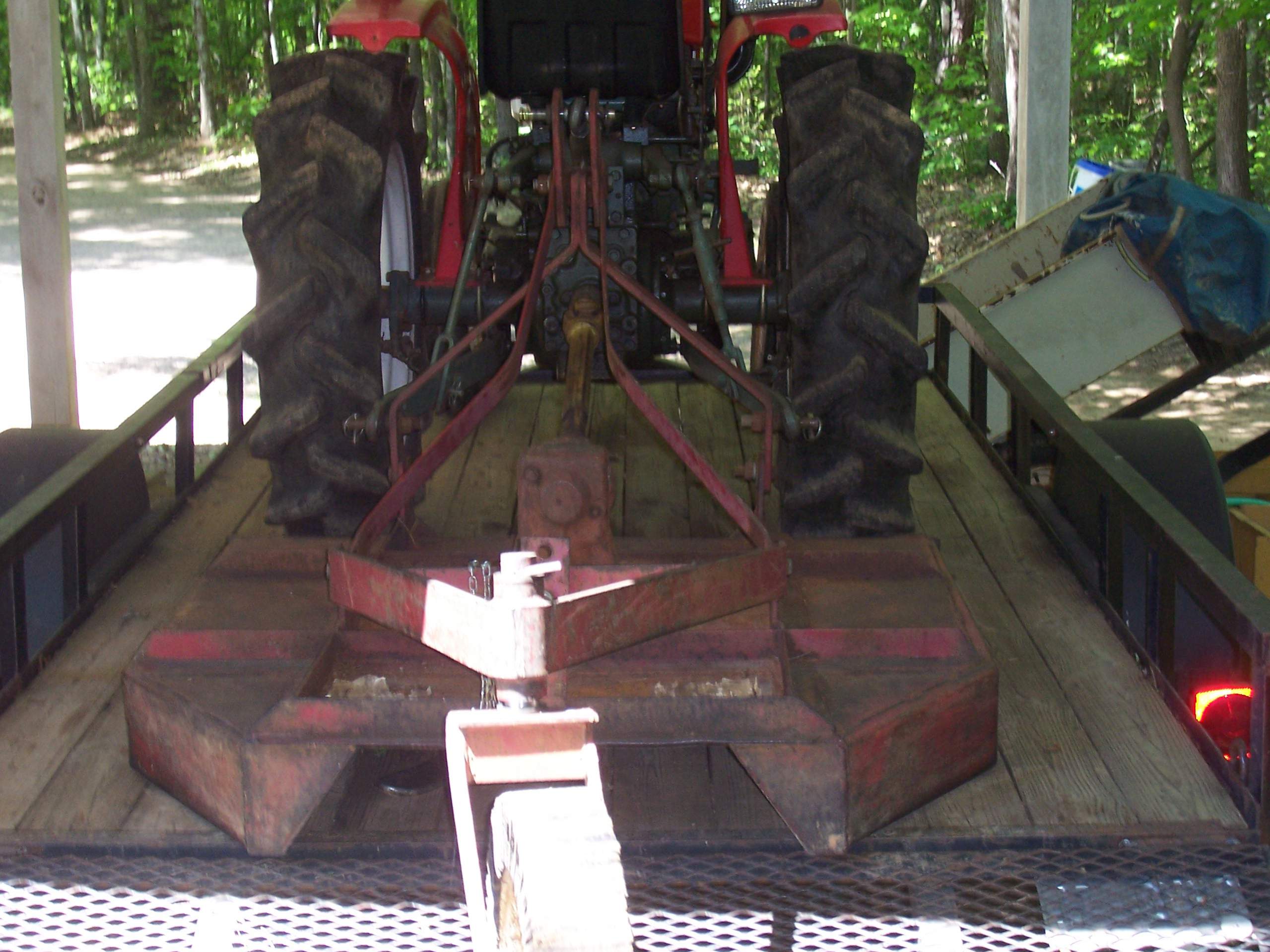

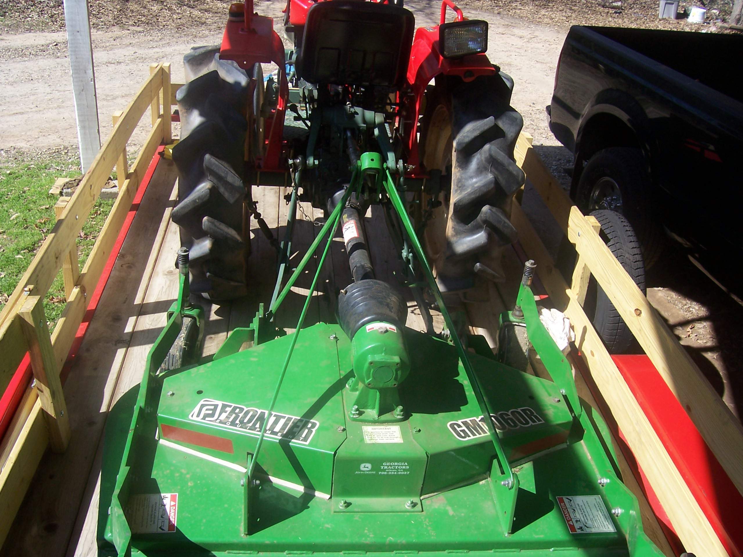

I agree mostly with 5hp. PTO. per. Ft. of Imp.. This is my 4Ft. International and my YM2000 runs it with no problems at all. No FEL. so I don't have a weight issue and is the same as my Rear Wheel Displacement. When I do use it being the same size as the rear is a big plus as not to get cought on a tree Etc.. I don't use it for mowing grass but to keep my 8acres of wooded area trails and property lines clear. I do use a JD. Frontier 5Ft. FM. but it is used on my 3acres that is cut Wkly. or Bi.Wkly. depending what the season. It handles it very well and now I have my 2nd. gear PTO. locking in and not coming out of gear I never run over 1800 Eng. RPMs.. And man is it nice to cut with.....;)
