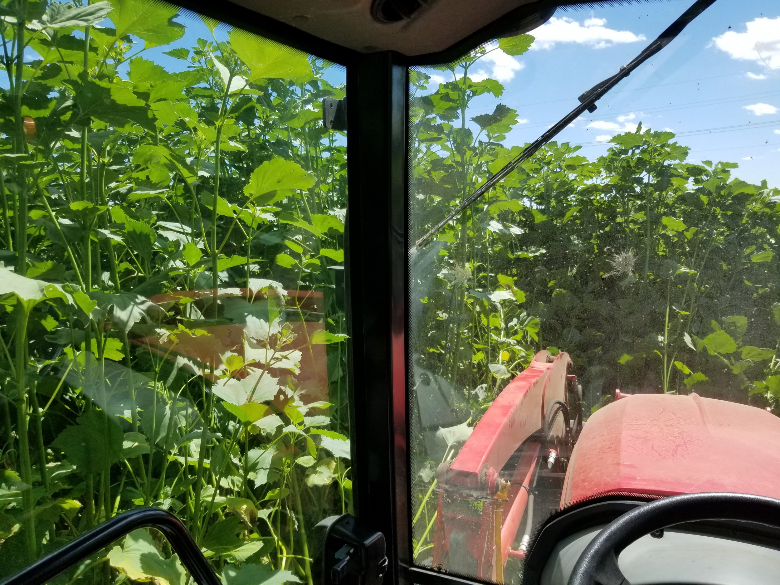

Depending on your field conditions, you may be fine running a 6ft on 25 (?)pto hp.
But if you have heavy, thick grass, you're going to have problems. It's not the brush and weeds that normally get you, they usually grow in thinner and farther apart. It's the thick grass, but by the time the grass gets really thick, you're having to slow down for lack of visibility also. You can't really see what's lurking in the thick grass, so you have to feel your way along.
I'm running a 6' cutter on 32 pto hp, and I almost never have to slow down from lugging the engine. But I find with visibility at zero, I have to play "blind man's bluff" with my front end loader and bucket. But I'm mowing other people's fields, not my own. So I normally have no idea what could be laying out there in the tall, thick grass. If you're only mowing at your own place, and you can get your field cleaned out from objects, then maybe you could mow faster?
But if you're mowing fields like this, you're not going to want to fly along anyway. I can't see the ground in front of my tractor, not even out of the bottom glass. My cab is just over 7' tall, and those weeds are over 8'. I'm pushing the weeds down with my bucket as I drive over them, going along at a fast walking speed. I wouldn't want to go any faster than that, just for finding objects like old tires, stacks of pallets, hunks of old fence, etc. I had no power issues here at all. That's 6' cutter on 32 pto hp though. -Edited to add- I'm also making full width passes with the cutter, not half passes.

OP,
Geez, thought I was the only guy riding thru crap like that. I use a little 48" Woods rotary cutter behind my 3033R, which is grossly under-sized, but that's because it was purchased for an older and smaller tractor I used to own. I use it to clear new trails for neighbors, often thru growth just like what you pictured here, totally blind as to what I'm headed toward. Real fun in wetlands, when you can put your front tires into a creek run, before you even know it.
I have found a few watering holes in the deep grass that way. When I see the tops of my front tires get wet, it's time to stop and back up. I have had to push myself back on dry land a few times with my loader bucket.
Sometimes "crap like that" is what the customer has. I'm mowing for hire, and some of these guys only want to pay for one mow per season. If it were up to me, I would have hit that field much sooner. Hard to convince some customers that mowing frequently is better weed control.
Sorry for derailing your thread OP.
