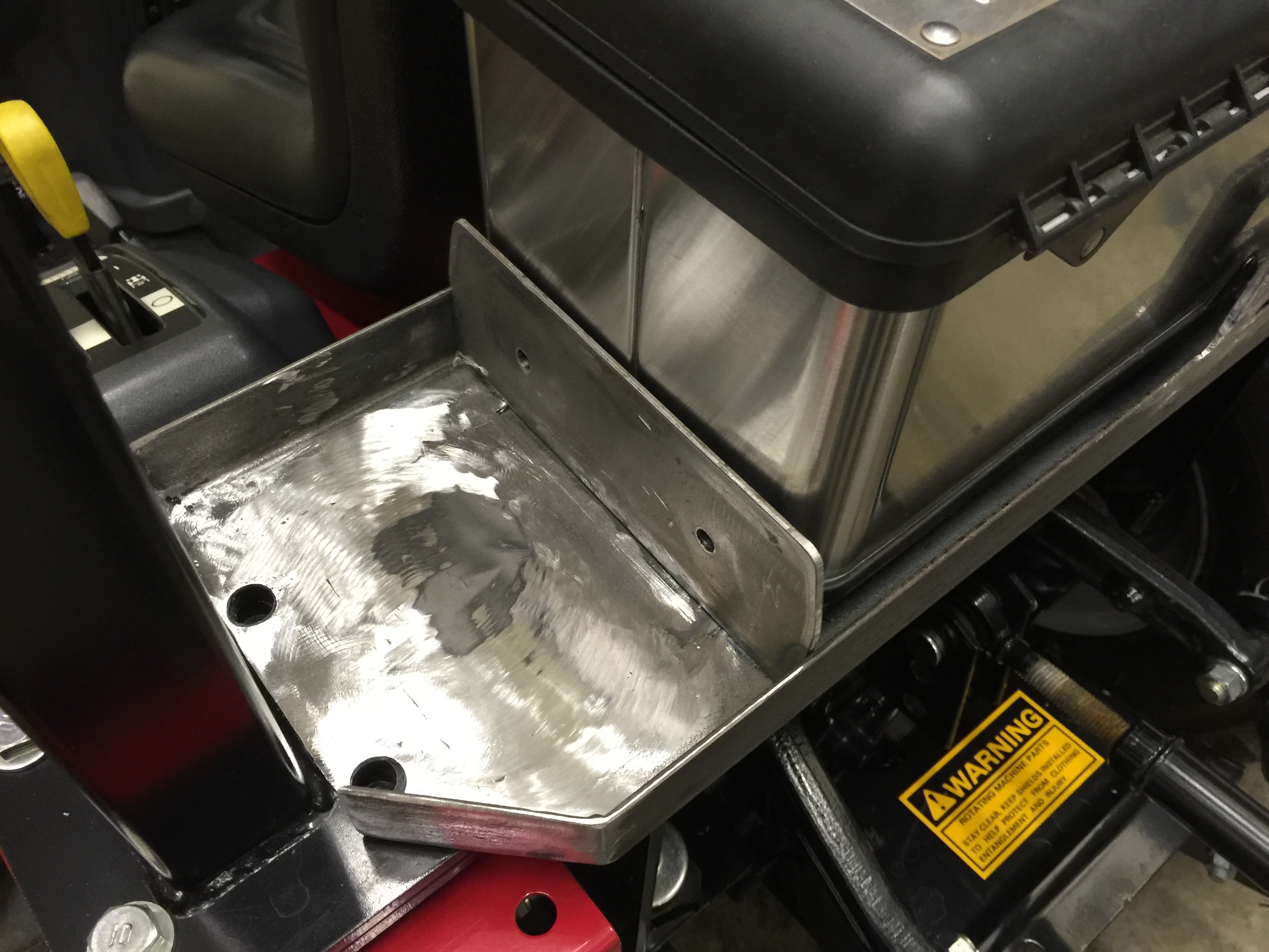

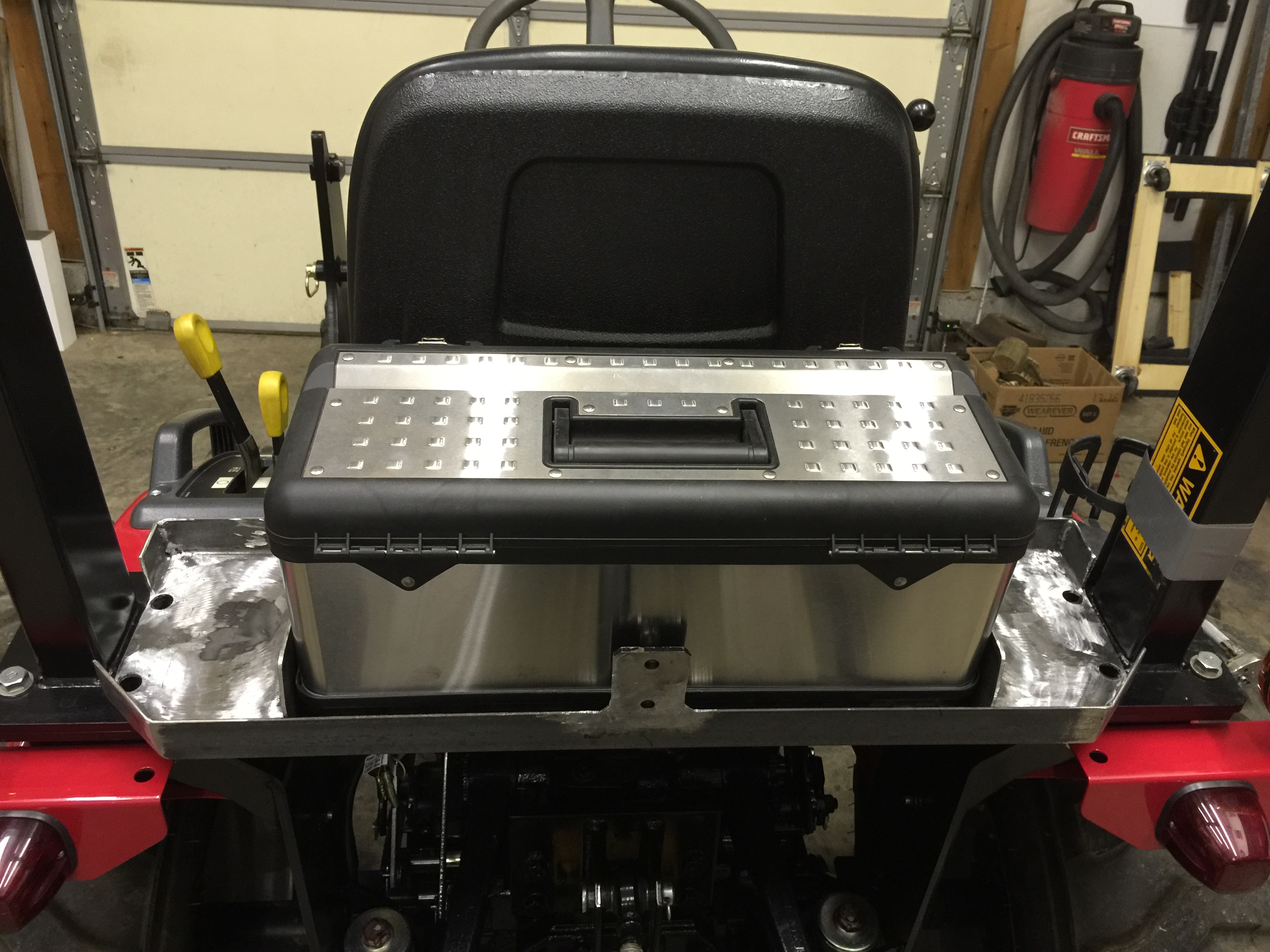

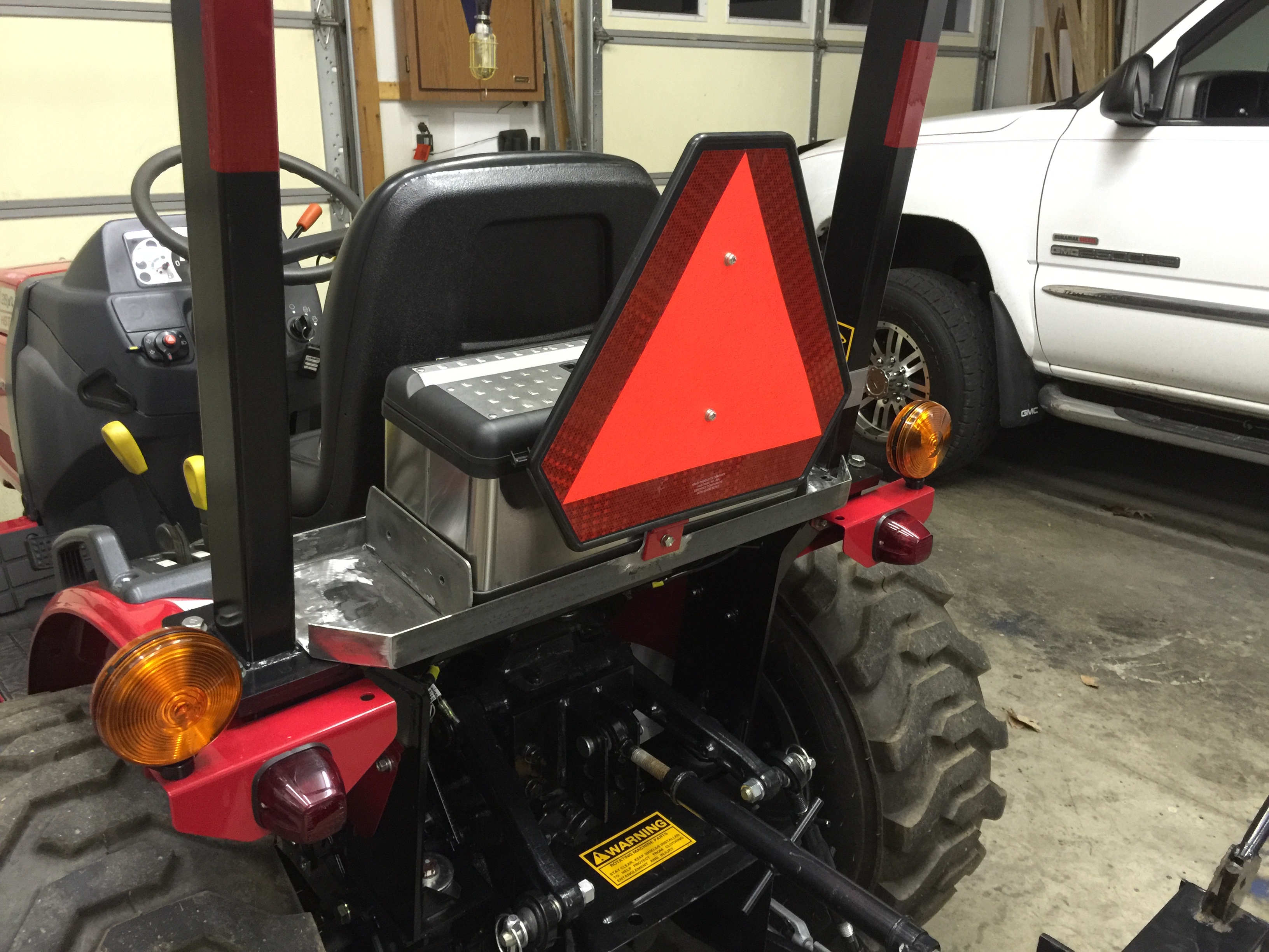

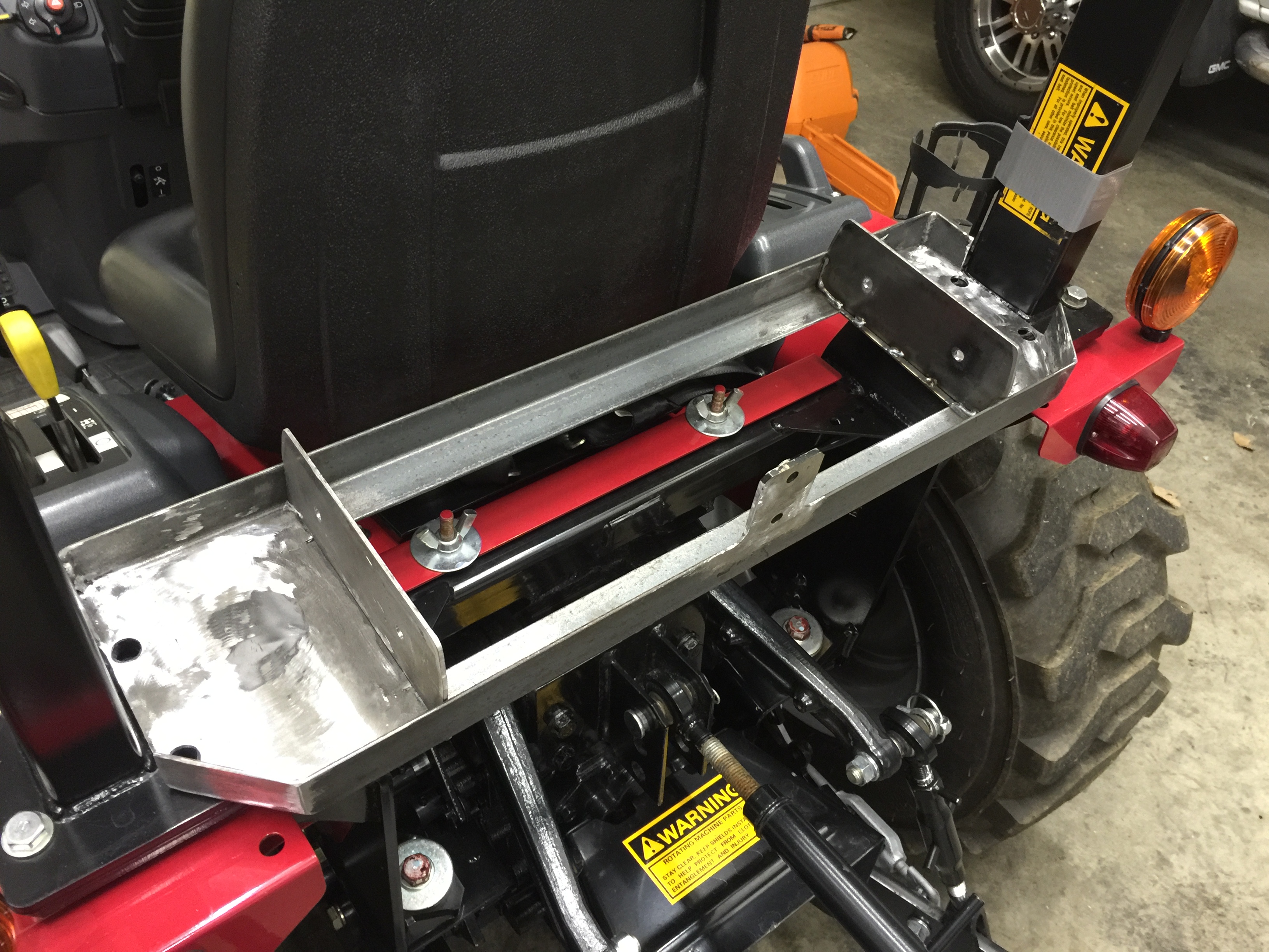

Hey Sfrankland love your solution for a toolbox holder on your 3616...how did you attach the piece of sheet metal to the tractor and where did you attach it to? Thanks for the GREAT idea!!!
/ Max 28 tool box #35

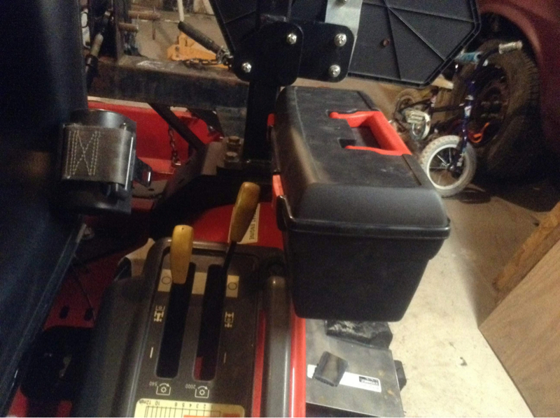

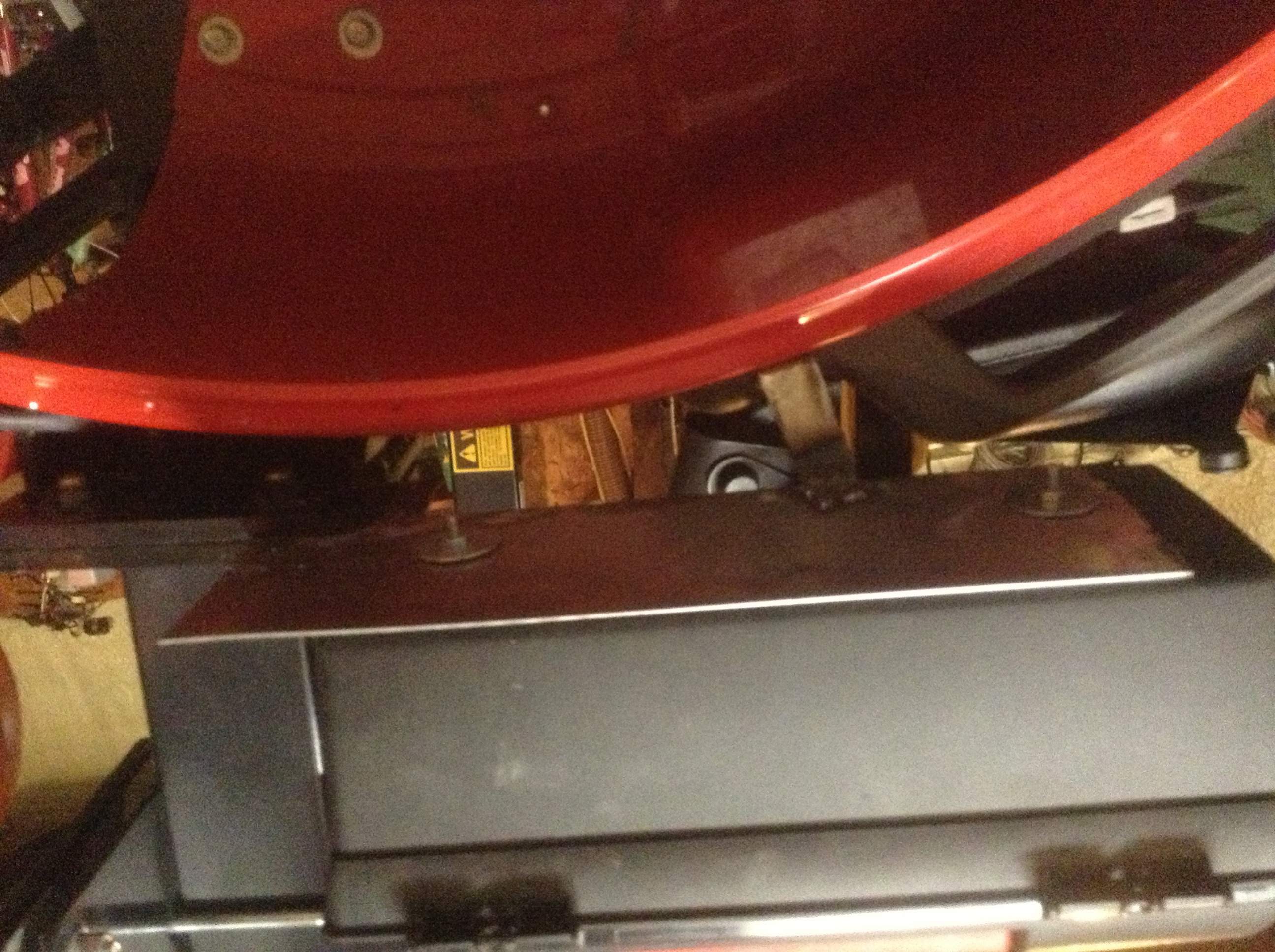

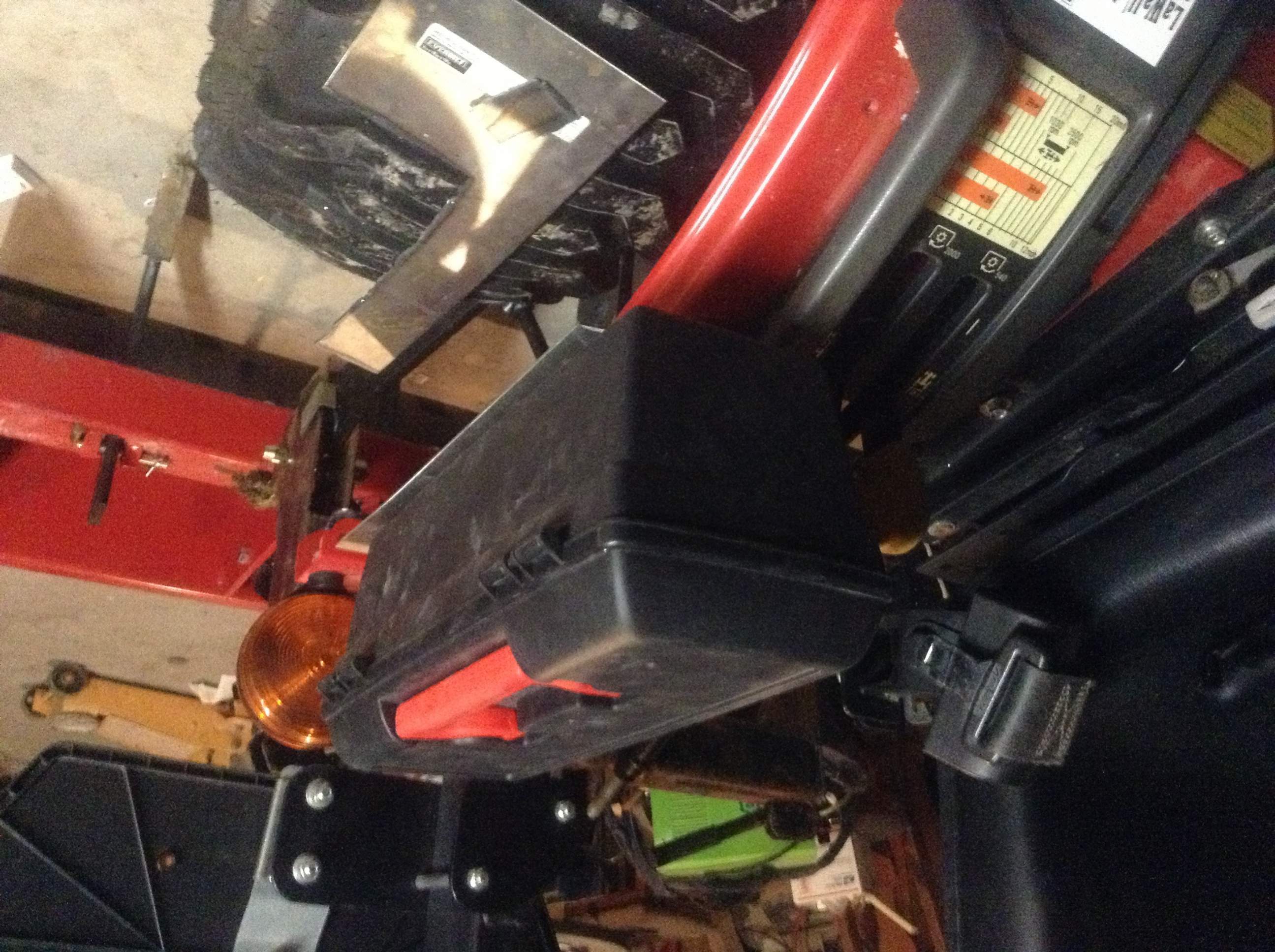

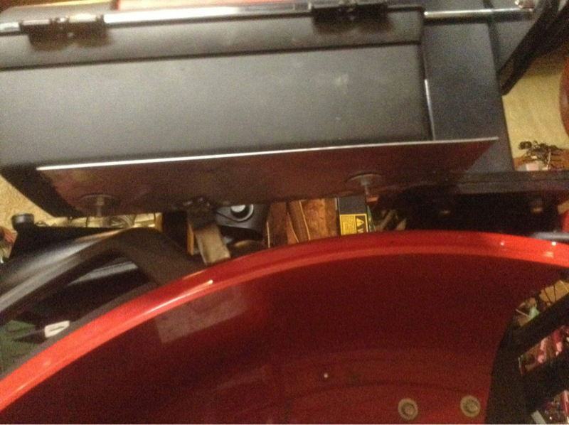

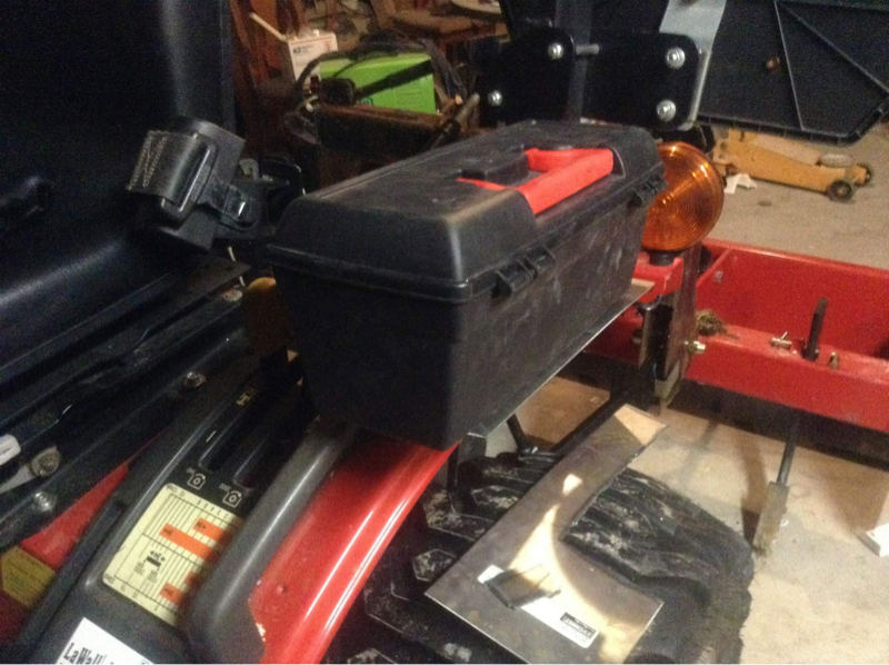

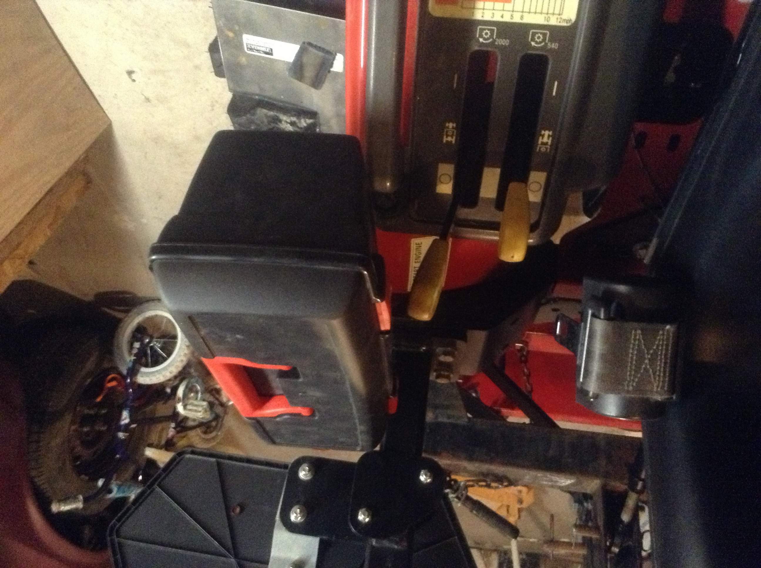

I picked up a small stainless box from HB. Made a platform that goes in between the 4 inside bolts on the rops. Still working on way to add a cup holder and parts try as a all in one unit. But it works great and no modifications to the tractor. Seat does not hit even when all the way back.
/ Max 28 tool box #36
View attachment 507438View attachment 507437View attachment 507439View attachment 507440
OK, that's really a lot nicer than the $10 Red Painted tin foil "tool Box" I slapped on and then zip tied a cup holder to the ROPS. The Box supposedly was made in the USA.
