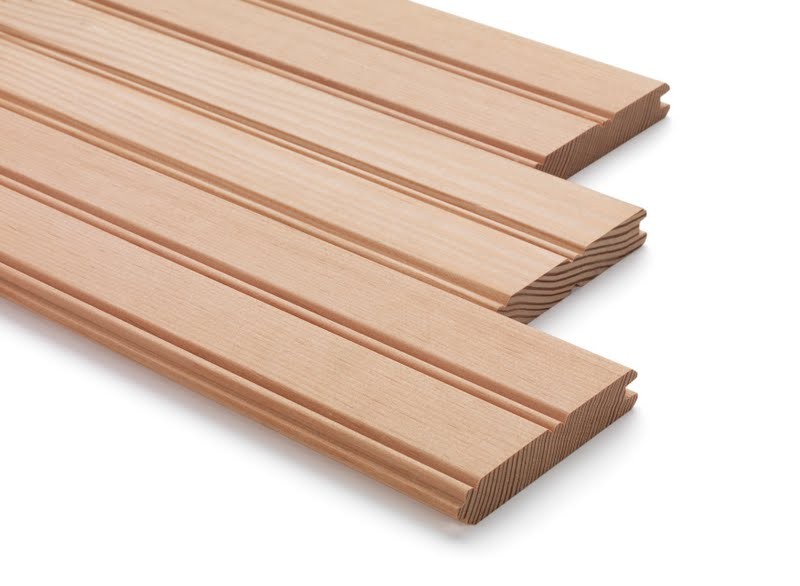

Old houses I have worked on and some new, used doug fir beaded boards about 3x5/8. Clear straight grain. Very nice material. Might not be available these days.
