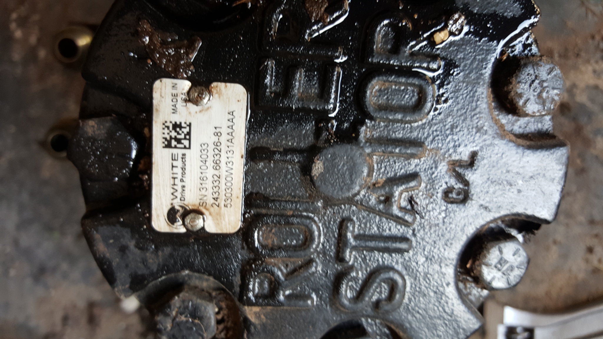

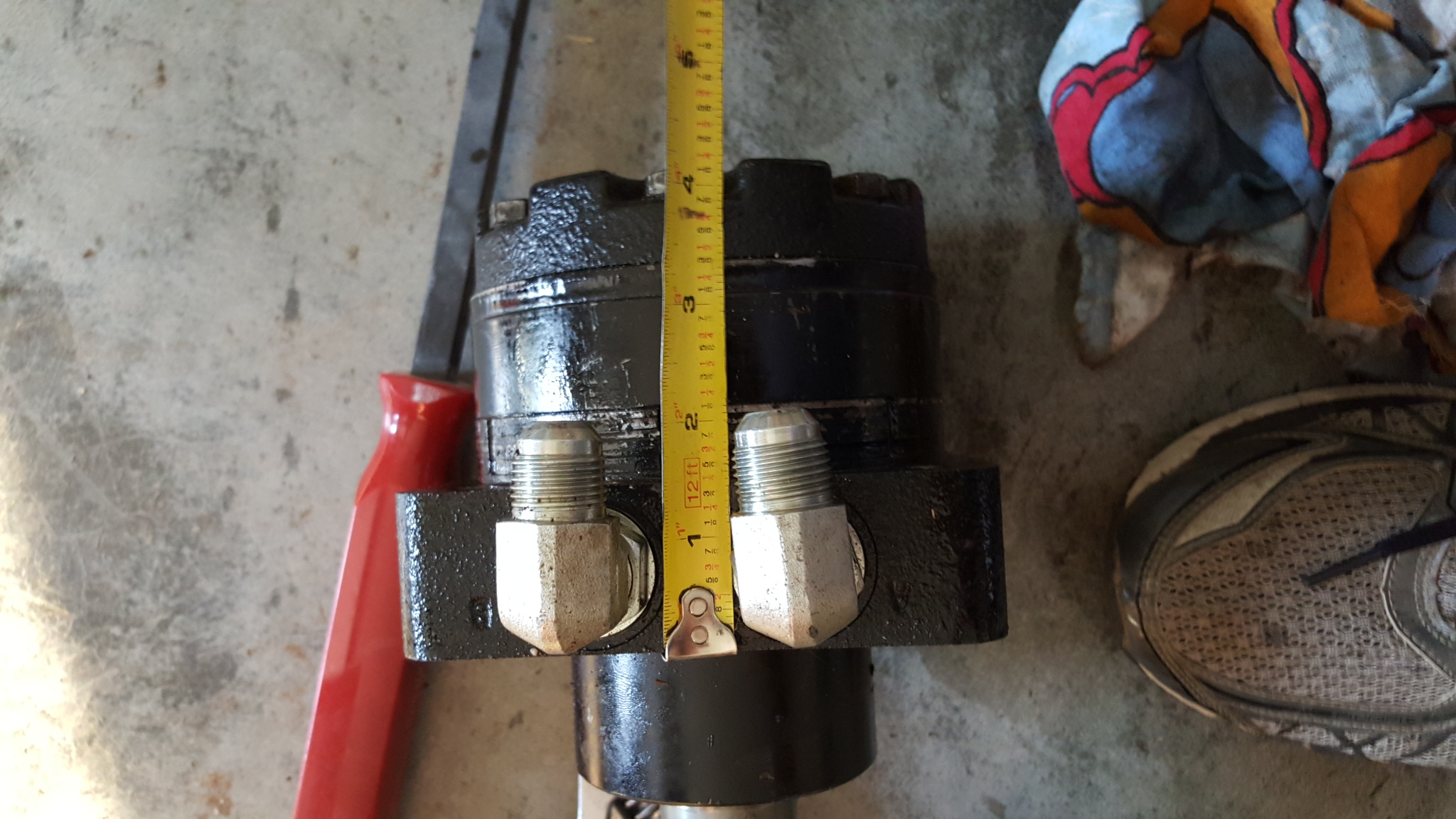

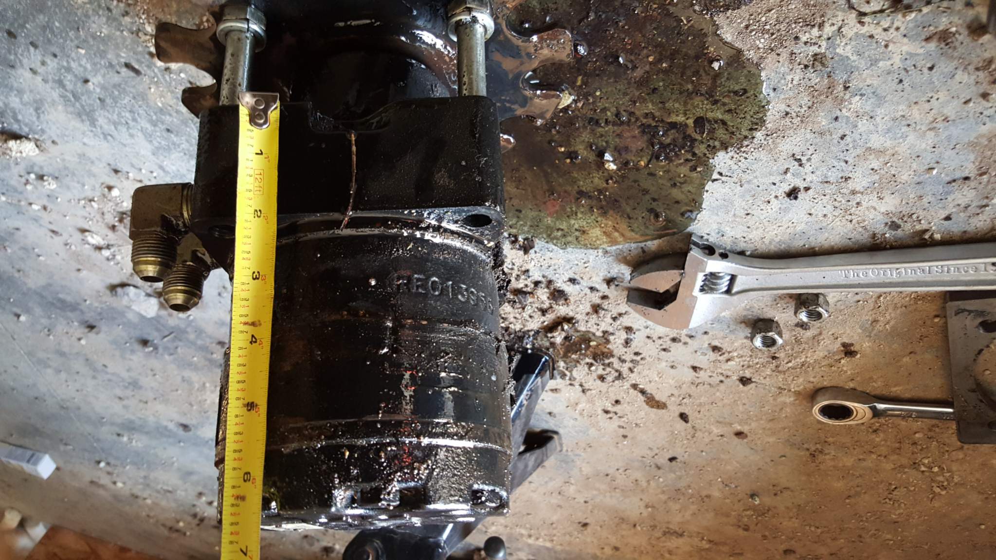

Sorry it took so long to get back with you. Partly the heat we have now and the dreading of finding yet another thing wrong with my auction PT. By the way the alternator did start smoking. Now i have it disconnected because it appears to not be cheap.
Anyways on to the motor. It is a re530. Same 18.3in i believe the others are. Pt1430 2004?
My others aren't marked. It is 6.5 inches deep vs the others 4" deep. 530300w3131
/ matching wheel motors?
/ matching wheel motors? #10
This is a White Hydraulics RE series wheel motor with heavy duty bearings.
Decoding the 530 300 W3 1 31 A A A AA model number:
530 = Counterclockwise rotation (but it's reversible as you know)
300 = 300 cc displacement (18.3 cu. in.)
W3 = 4 hole wheel mount
1 = 7/8" o-ring aligned ports
31 = 1 1/2" tapered shaft
A = Black color
A = no valve cavity
A = no lock nut or hex nut included
AA = not a free turning rotor
Max continuous torque is 7300 inch pounds (8300 intermittent). The length is 5.15 inches.
Any hydraulics supplier should be able to match this specification with an alternative. The displacement, 4 hole mount, tapered shaft size and motor length are all fairly critical.

Is it safe to run this re530 on the front left while the rest are ce430s? This was actually the question i had in the beginning.
/ matching wheel motors? #16
As long as the displacement is the same, running different series motors is fine, IMO.
/ matching wheel motors? #17
Kent's right. If face, the 530 motor is a "better" motor because it has heavy duty bearings (the 430 had medium duty).
