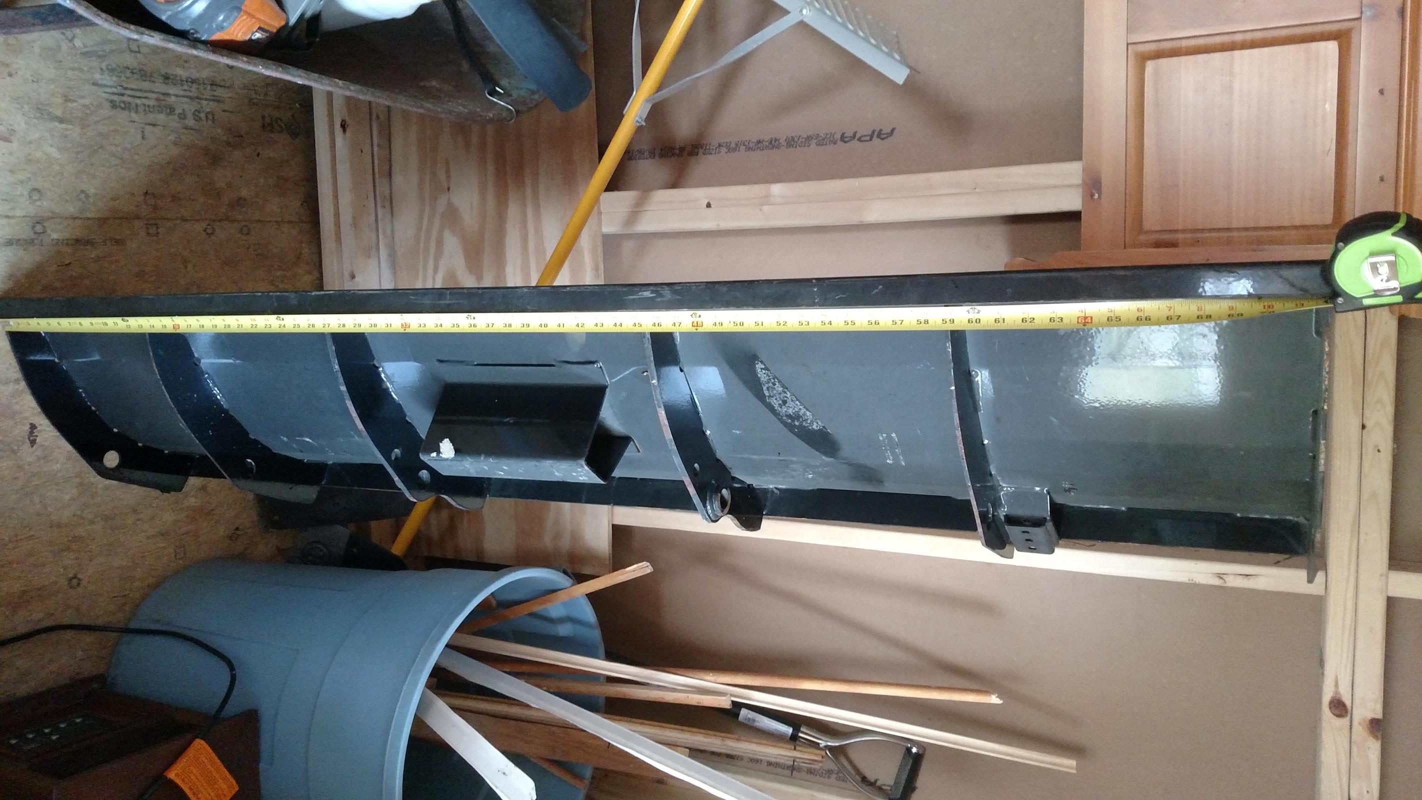

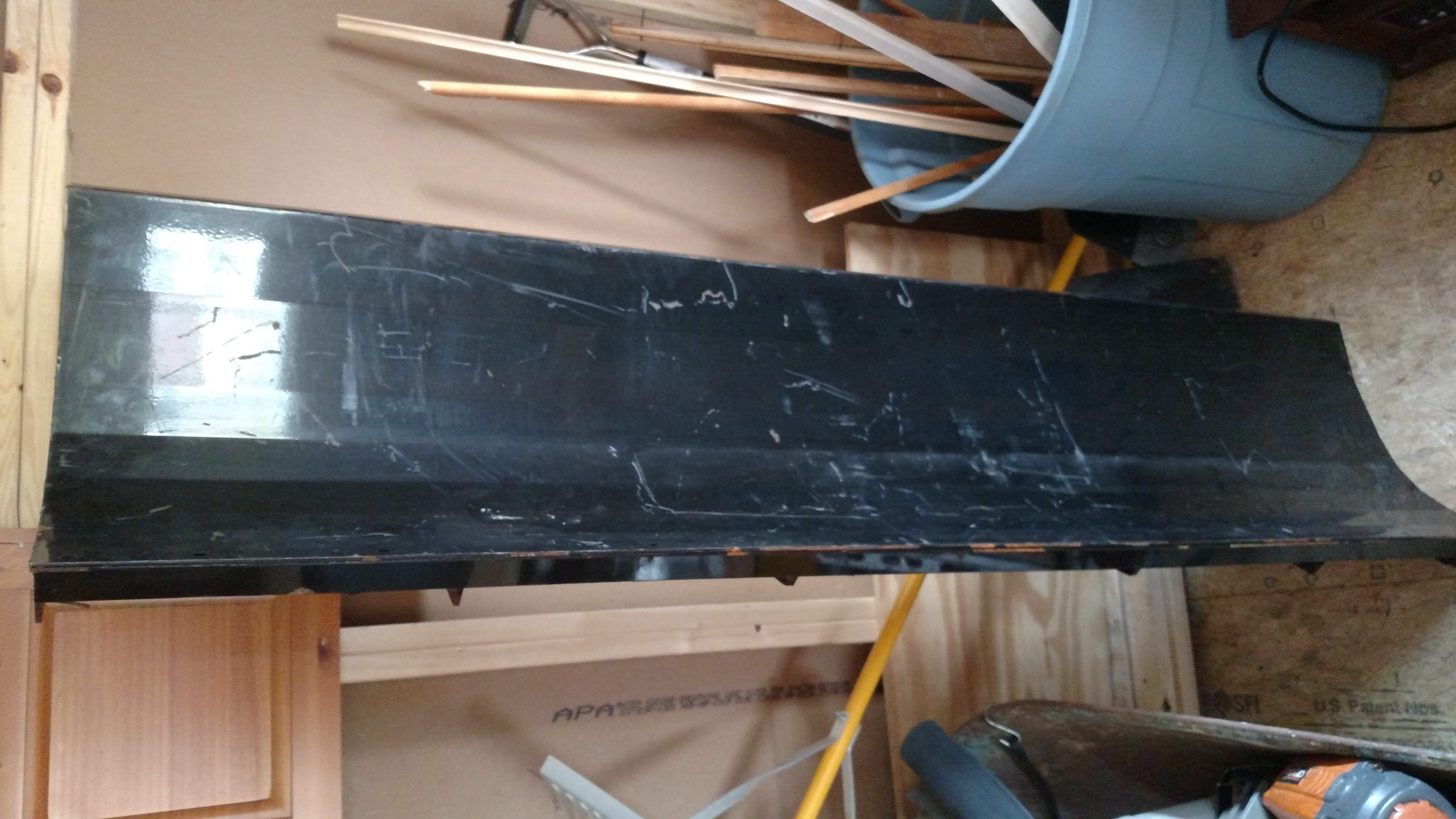

That looks like a pretty simple design thanks for sharing. It seems high off of the ground even assuming your using the loader controls to pivot the blade forward. Does the blade have the ability to contact the ground?
That blade looks real similar to the one I have and am thinking of using. How deep of snow have you handled with that setup?
Here is my blade.
