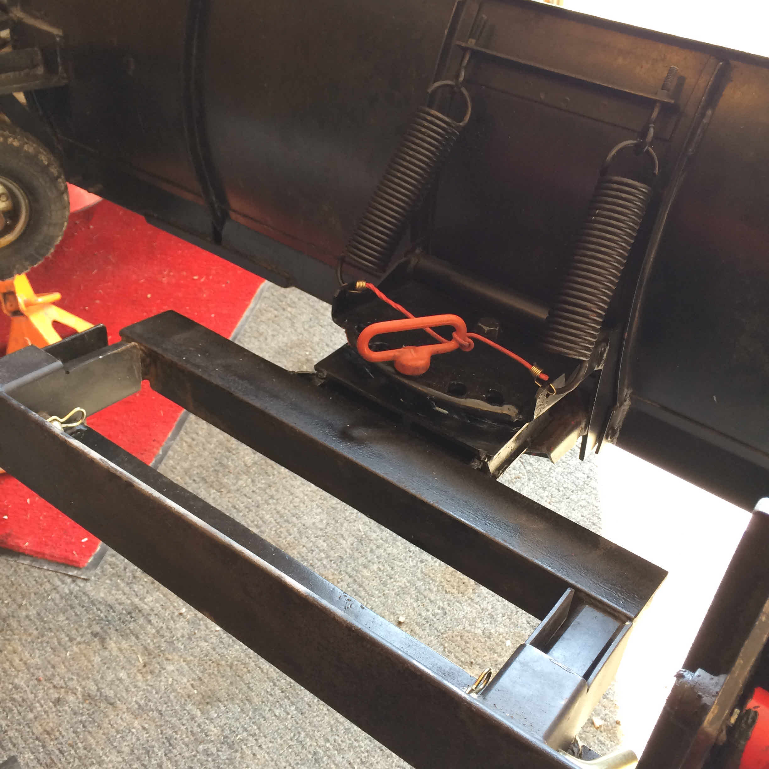

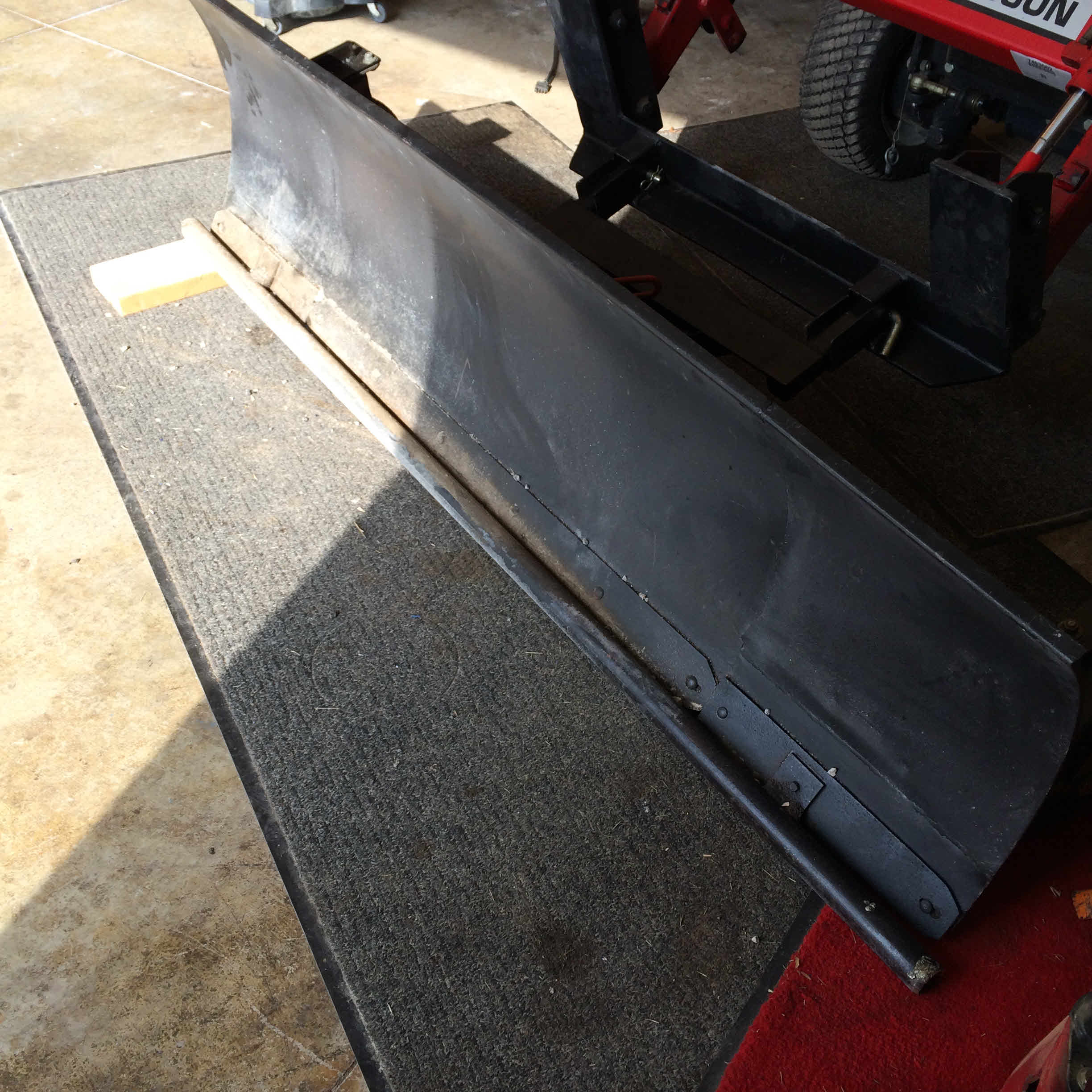

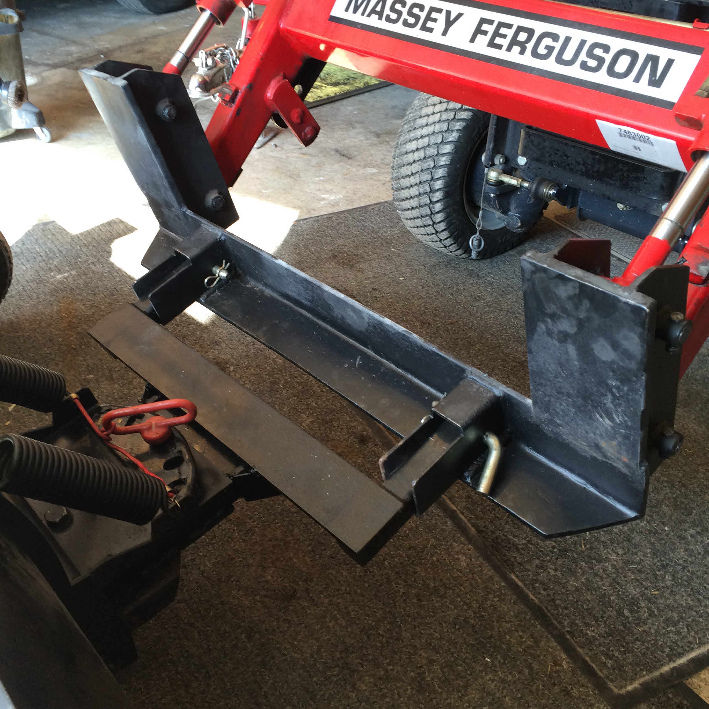

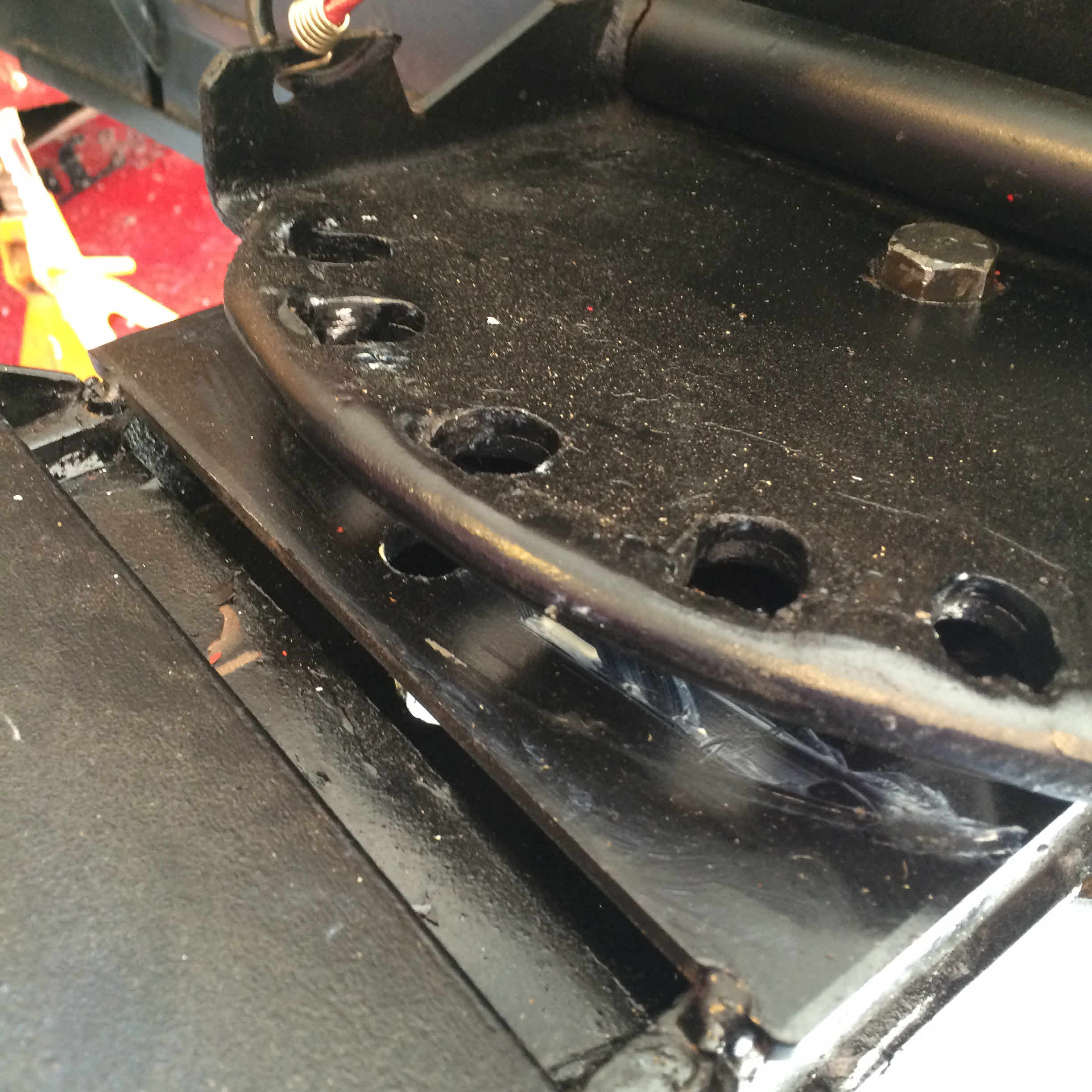

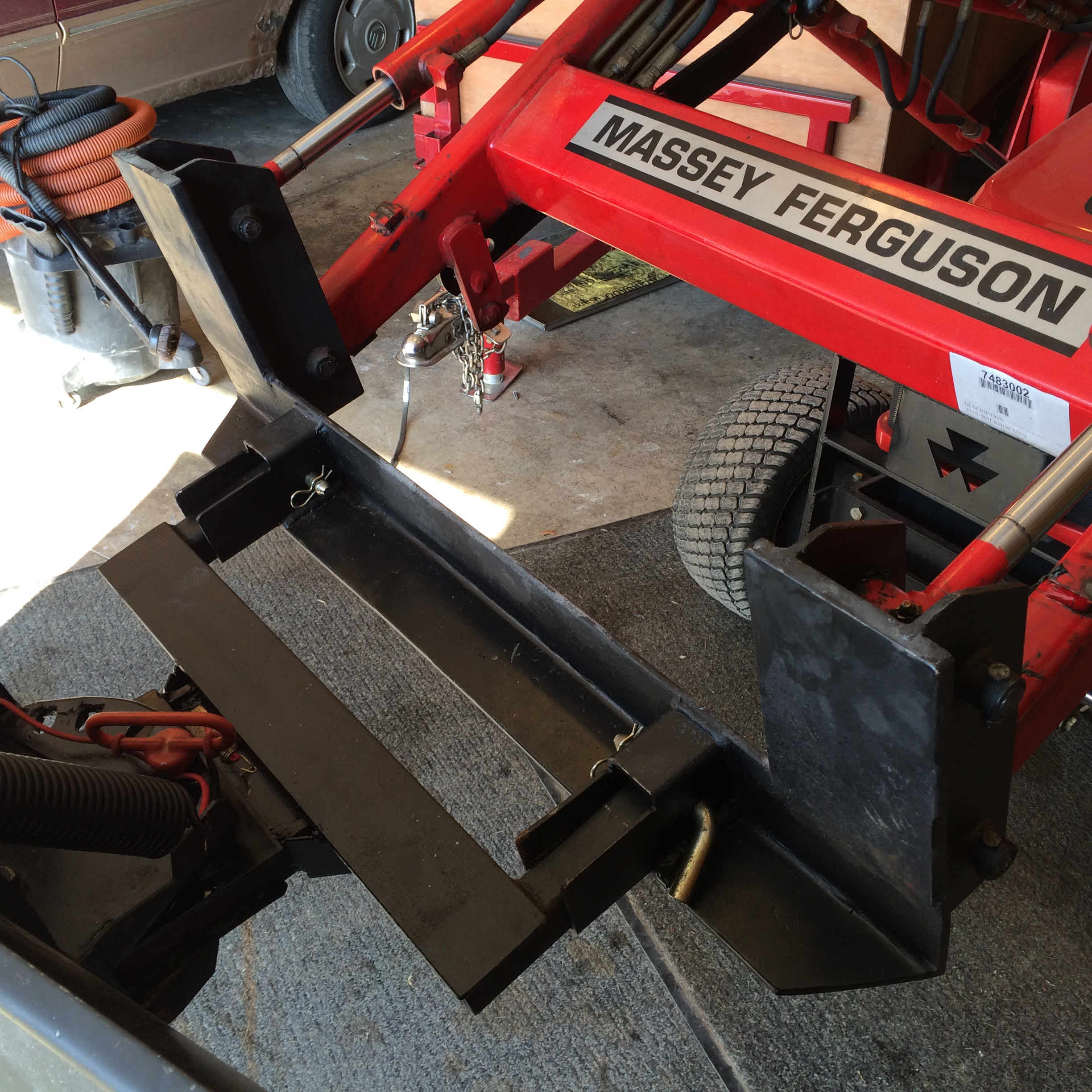

Okay, here are close up photo's of v2.0.
The attachment pins act as hinges, as well as making it easier to attach, and remove the plow.
I also made some forks, out of square tube, which fit in the receivers. I may make an adapter, to be able to pin the FEL bucket to it someday, to make quick swaps.
The last photo shows the blade on the ground, with one side 1.5" higher than the other. This is due to the slop built into the pivot. Without that ability, the plow may not stay in full contact, if there is a change in the pitch of the ground. It also shows the 1.5" pipe in front of the cutting edge, to keep it from digging into my gravel.
The casters I have on there, (see earlier photo), are of course, optional. They are to help keep the plow 2" above the gravel. And, not needed on a paved surface.
This is not a difficult project. Lots of of help available on TBN, if you need it.
I chose not make a plow that attaches directly to the bucket. Without beefing up the bottom of the bucket, I don't think it would hold up well. GC buckets are pretty thin on the bottom. And, the whole rig gets pretty long. In order to angle, the plow would have to be about 2' in front of the bucket.
