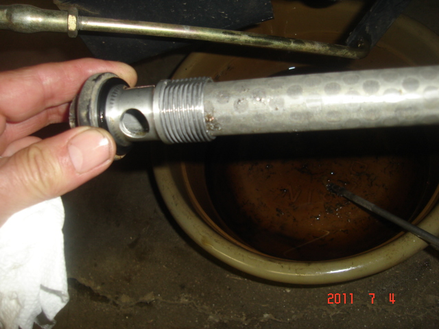

MF 5465 has a dash light that comes on just as soon as the tranny warms up. According to the operator's manual it says something about a 15 micron transmission screen/filter may be blocked. Any idea where or what this may be?
Also trying to figure out what trouble code 14 is. Anybody?

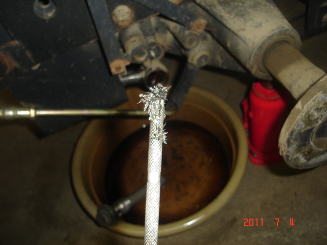

Don't know about the 5645, but my teensy 2310 has a filter screen in the suction side of the hydraulic system which is located behind the left rear wheel and is accessed by a large nut on the cap. (This is in addition to the hydraulic filter.)
I'll bet yours has something similar. Here are a couple pics of mine: I'm holding the tube-shaped screen by the nut end that unscrews in one pic; in the other, you can see the hole where it came out of the tractor in the background, directly behind the tip of the magnet rod I stuck in to collect metal particles. Hope this helps.

That's great. Thanks a lot. I'll have to see what I can find.
BTW, have you ever seen a list of MF error codes and description? I cannot seem to find them anywhere online.
