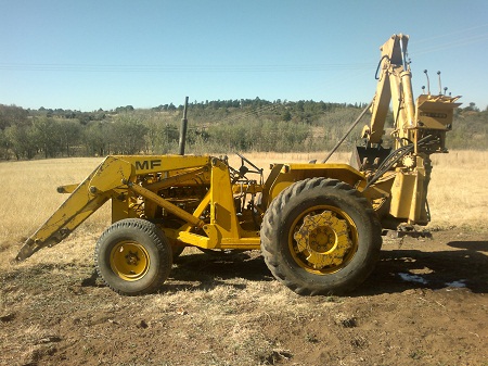

Does any one have service and repair information on a MF 50 front end loader tractor

picture of MF 50
/ Massey Ferguson MF 50
thanks for the reply but it does not match the photo , i think it is a Backhoe loader tractor MF 50 C type ..

Being yellow, yours would probably be an industrial model. Such as that used by construction companies and/or state highways.
I'm unsure how many differences there would be other than paint color.
But the SSB link I posted does cover the TLB model.
Quite a bit.....Massey Ferguson 50 industrial was part of the "DX" series built in mid 60's through mid 70's. MF50 AG model was built in late 50's through early 60's....two different animals altogether.
/ Massey Ferguson MF 50 #9
A MF industrial tractor from that era has the standard Perkins power.....but the tractor itself is a MUCH heavier unit than the equivalent agri tractor....they were designed to be used as loaders and backhoes on construction sites. It should have things like diff lock and extra heavy duty front end.
We have a MF 30 and a MF 50 C on the farm.......they were both originally modified when new for full time logging by a local welding shop with heavy duty headache racks, belly pan, engine shields, big rice-n-cane tires, and strengthened 3pt hitch.
Extremely tough, powerful units that are a complete headache to work on...............
ours look similar to this unit......but without all the extra weights and rust
http://www.tractorhouse.com/listingsdetail/detail.aspx?OHID=5489370&
/ Massey Ferguson MF 50 #10
I knew you would show up eventually. In post number 6, I'm pretty sure thats the manual he needs, is that the correct one?
/ Massey Ferguson MF 50 #11
That's the right manual.
The MF50 industrial is the equivelent of the MF175 AG tractor, 67 engine hp/62 pto hp
The Massey Ferguson 50 ag tractor is an updated Massey Harris 50/Ferguson 40. 34 pto hp.
Other than the name and the confusing model numbers, they are totally different tractors from stem to stern.
