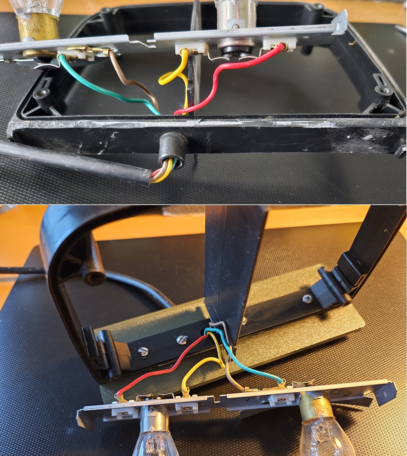

Like many people who own GC17XX tractors and use them on a property with trees, I kept snagging them on the tree branches and snapping them off, removing them and gluing them back together, putting them back on…rinse and repeat…
After about three cycles, I just left them off and they were sitting in a box in the garage.
I kind of had a fix in my mind, but was not in big hurry to implement it.
Until my company got a the 3D printer...

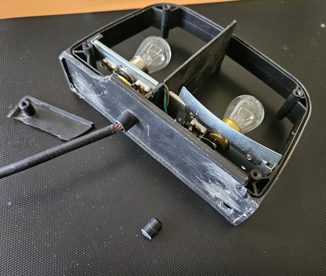

What actually always broke in my case, was the flange of the frame for lenses that is held on to the base of the light with 4 screws, lenses are probably made of PC, so they are tough.
The flange kept breaking and screw bosses were being ripped off.
   / Massey Ferguson GC1700 tail lights repair
#2
Here is a picture of one of my lights. with the flange and screw bosses ripped off

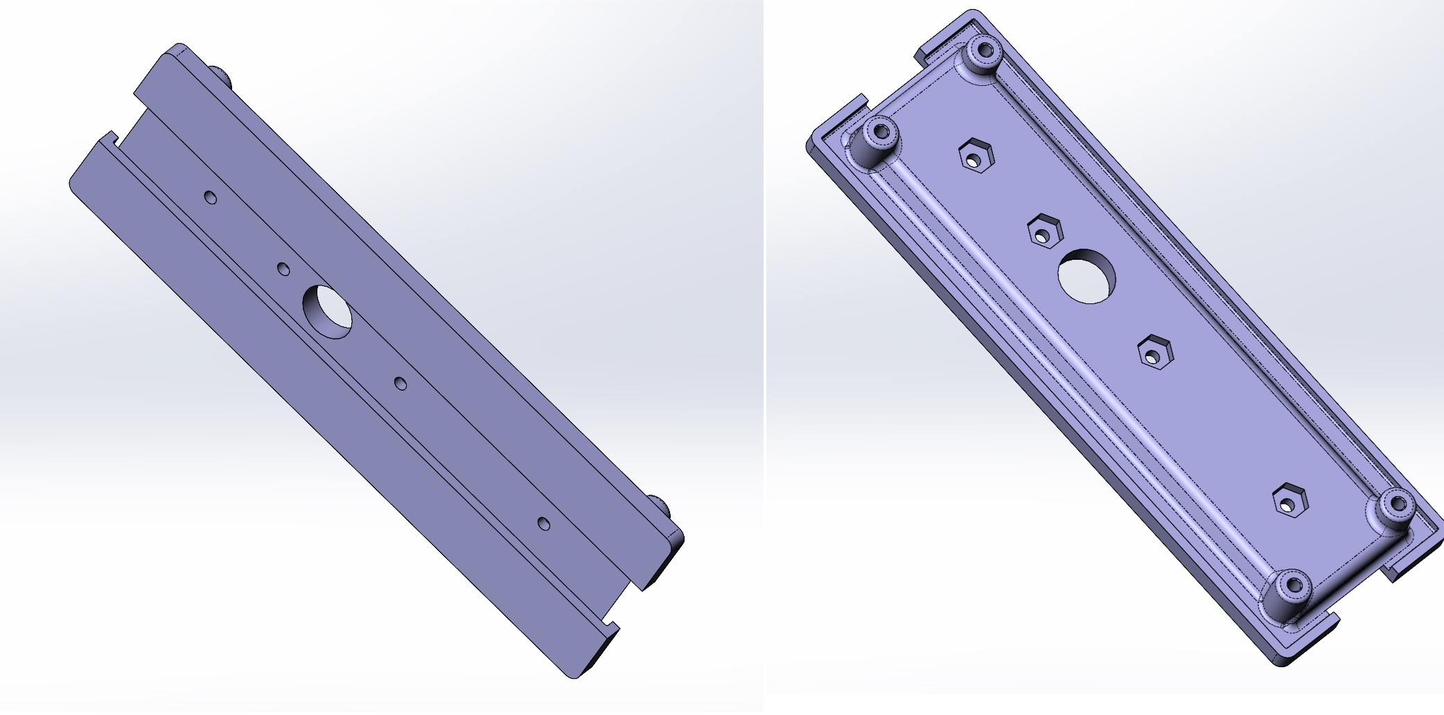

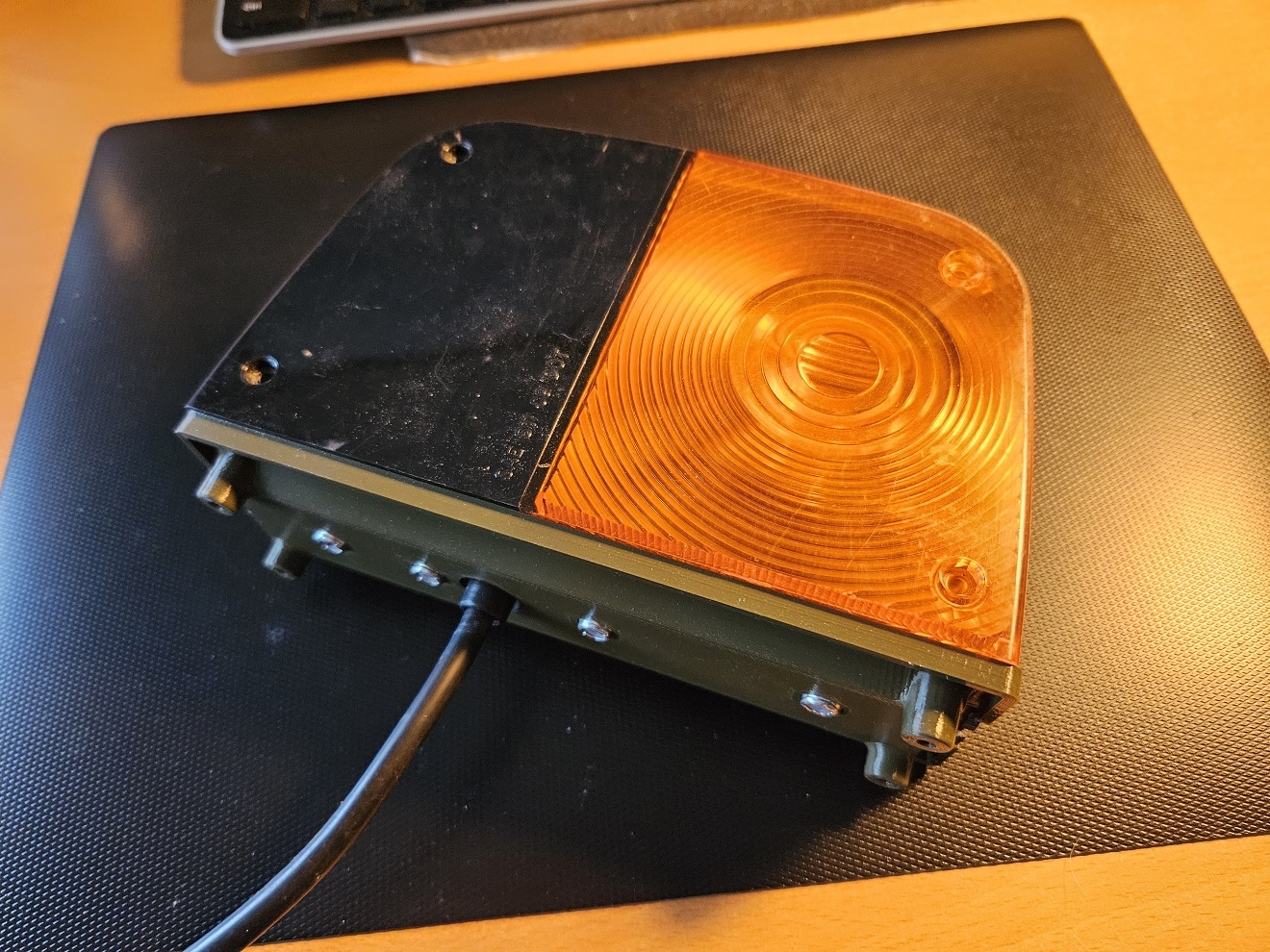

So I came up with a piece that replaces the broken flange and bosses, and bolts on to the lens frame

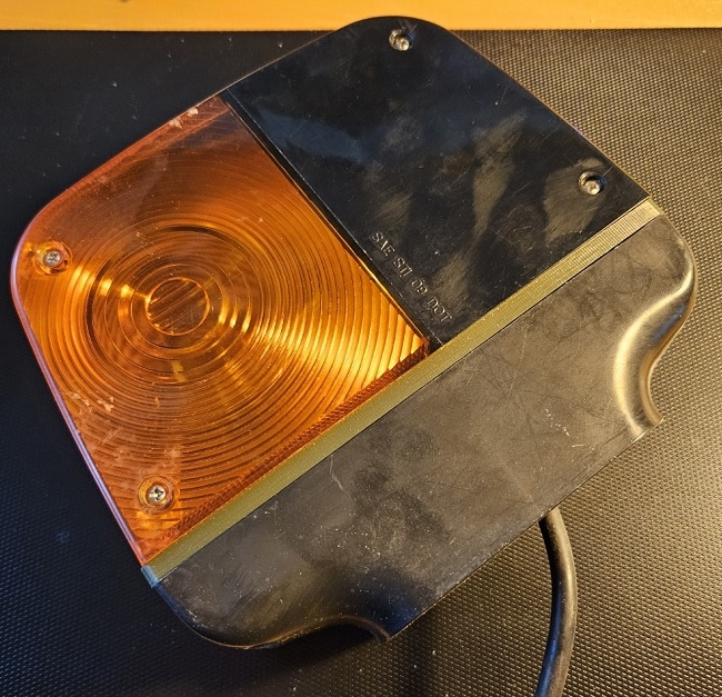

I cut the remnants of broken flanges off of the lens frame and screwed the new piece on.

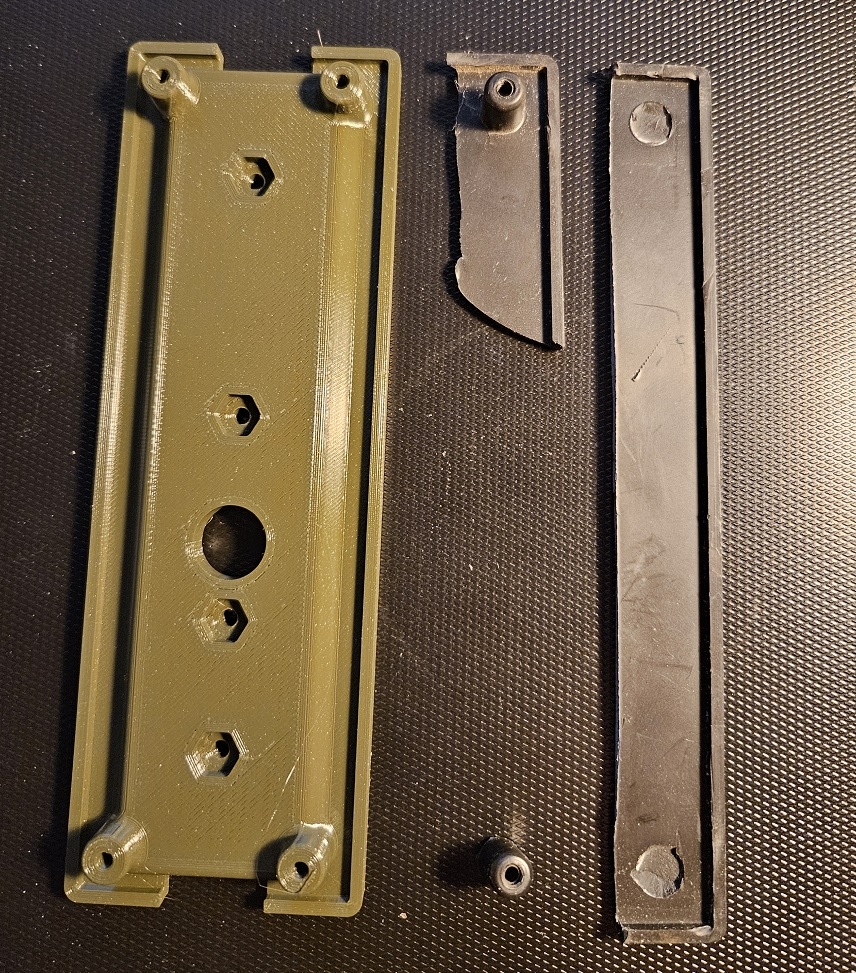

Then I attached lenses to the frame, they fitted like a glove.

And then the whole assembly was bolted on to the light base and back on to the tractor.
I will add steel loops around the lights to protect them from this happening again.
The new light assembly here in Canada is about $240 CAD with tax, so almost $500 CAD for new set of lights.
This is MUCH cheaper option.
