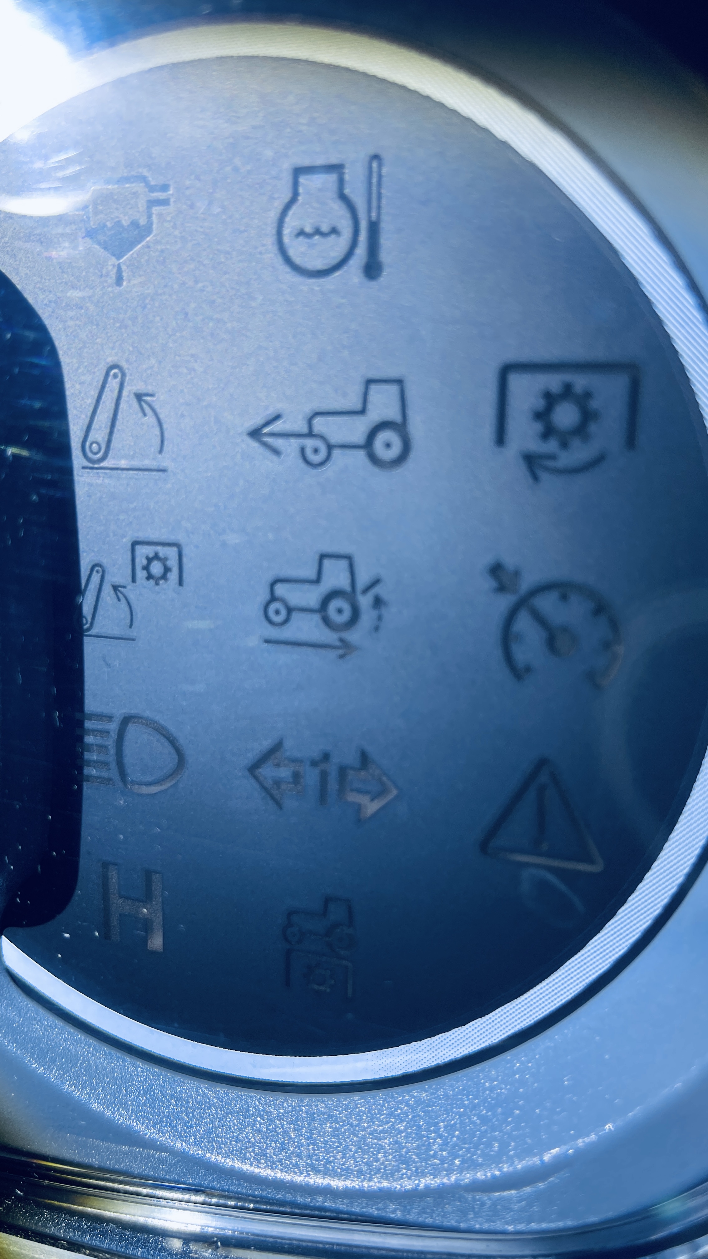

I know these aren't as sophisticated as our automobiles, but if we did have a limp mode, shouldn't an idiot light of some sorts come on within the dash?
hmmmm, I see about 12 possible lights (all dimmed out) in the cluster dash (right side).
   / Massey Ferguson 1740M Hydro: LOSS OF POWER when hot!
#185
No lights (other than forward PTO light) has ever come on while mowing and the power loss occurs. Here's my dash and idiot light lineup and we do have a "Caution triangle" one?... (I kinda think this is a safety warning however)
