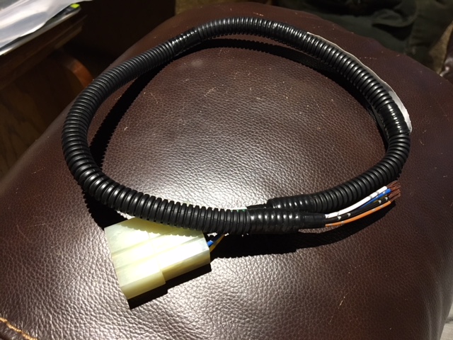

I tipped the seat up and found a small compartment on the back wall they seem to call a tool box. I found a short wiring harness with a plastic connector on one end and 6 bare wires on the other end. What is this for? It has a number on the harness 17276669000-0, but a search of the online parts manual resulted in no matches.
Jeff

My best guess is I believe that is your harness to connect a radio that does not have a plug which matches what's prewired on your tractor.
I have an open station tractor.
Jeff

Sorry it was just a guess, I'm not quite sure then.

My 1754 Cab came with a pigtail. From the operators manual, I believe it’s hooks into the tractor wiring and will operate tail-turn-brake lights on a trailer or wagon. Don’t know why they didn’t just connect it at the factory......

I could not find anything in the operators manual about this pigtail, but I went out yesterday and dug a little deeper trying to find where this pigtail could be connected. On the left side of the tractor under the sheet metal that goes between the fenders behind the seat there was an open connector that matches the pigtail. I got my multi meter out and figured out which wires did what. I had a new rectangular light in the shop that I had bought a few years ago that I mounted into an existing hole on the other side of the same sheet metal. The light came on when I turned the lights on, but the light is not ideal for this purpose. It is better than nothing, but I will have to look around for a more suitable light.
Jeff
