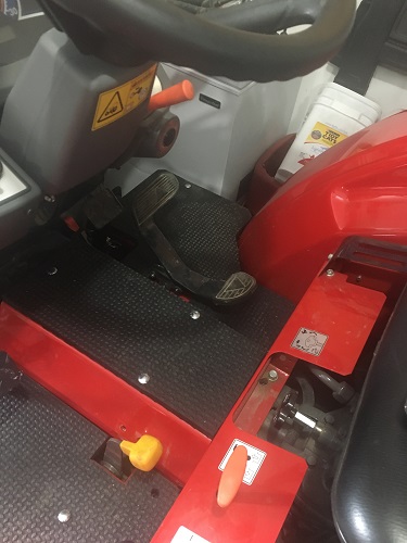

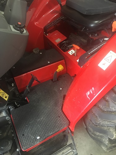

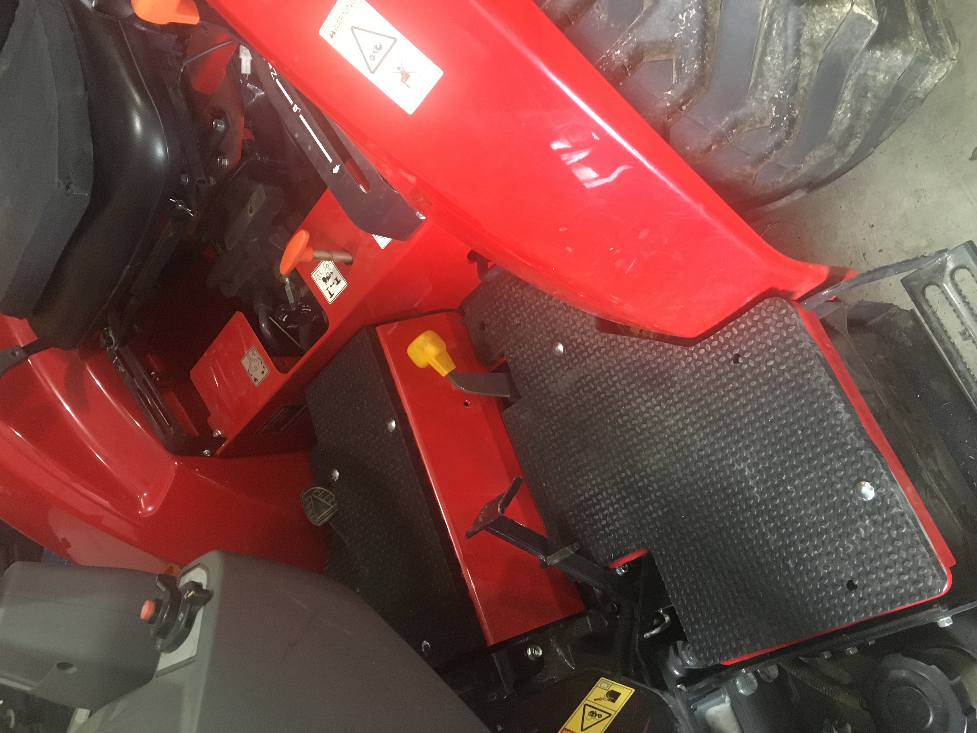

Since the E-series do not come with rubber floors I decided to make some myself. I bought a 4'x6'x3/4'' stall mat from Rural King.

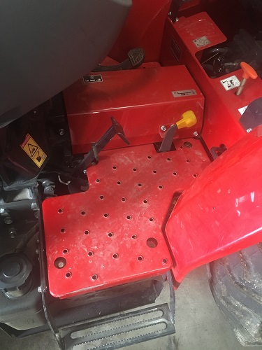

It was really straight forward - I removed the existing floors to use as a template. I went through about 10 razor blades, but in the end it took about an hour to remove, cut, and make small adjustments for a good fit. I used some carriage bolts and nylock nuts through the existing floorboard holes. It turned out nice for $30.

Another benefit of this mat is the weight of it. As we all know, tractors of similar size could always use the extra weight. This 4x6 sheet I used weights almost 100 lbs.
I weighed the material I added to the tractor, and it was about 30 lbs. Not a ton, but it all adds up especially with filled tires.

$30 for the 4'x6' piece. I would have bought a smaller size, but that was the only size they carried in 3/4''.
