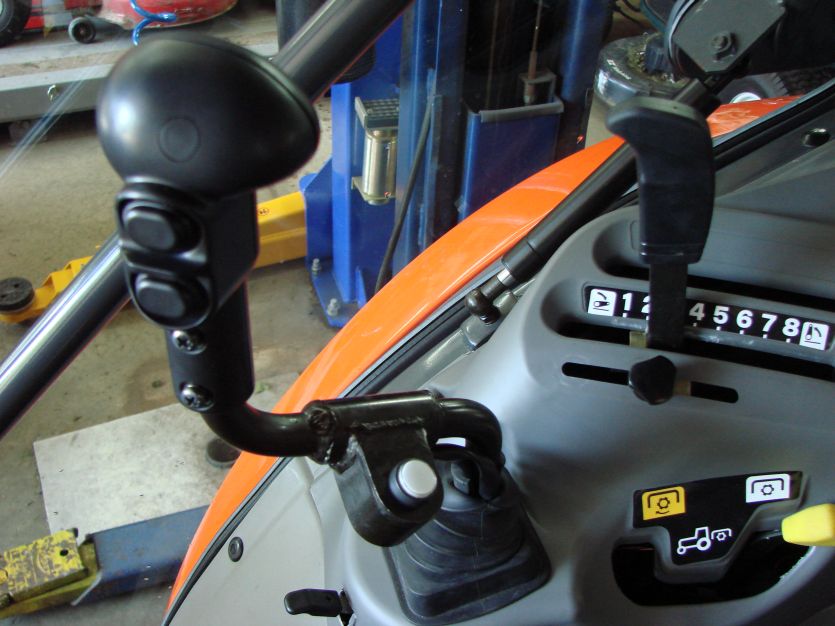

I'm guessing that your dealer will charge about 3-4 hours labor to install the WRLong kit. As I noted, I wouldn't be surprised if it ended up costing almost as much as the grapple.
What you need to check on your tractor is how you control the rear remotes. There will be a lever somewhere convenient to the seated operator that will allow control of the rear remote. With any luck, Kubota has configured the rear remote lever so that you can easily reach it by simply dropping your hand off the FEL joystick. You'd like to be able to reach for it without looking (like grabbing the stickshift in a car after taking your hand off the steering wheel). You'll need some practice but I found I could control the grapple almost as quickly as with a diverter valve. Even in the beginning it is pretty efficient. Just open the grapple then use the tractor and FEL controls to position the grapple where you want to close then reach for the remote lever and close the grapple. You will almost never open or close the grapple while moving or while fiddling with grapple up/down curl/dump so there is only a minor penalty to needing to move your hand off the FEL joystick in order to open/close the rear remote controls.

I had a 3rd function valve installed when I bought my L3940 in the fall. It cost me 700 installed for the Kubota system. Here's a pics of the same one on 4 Shorts tractor.
