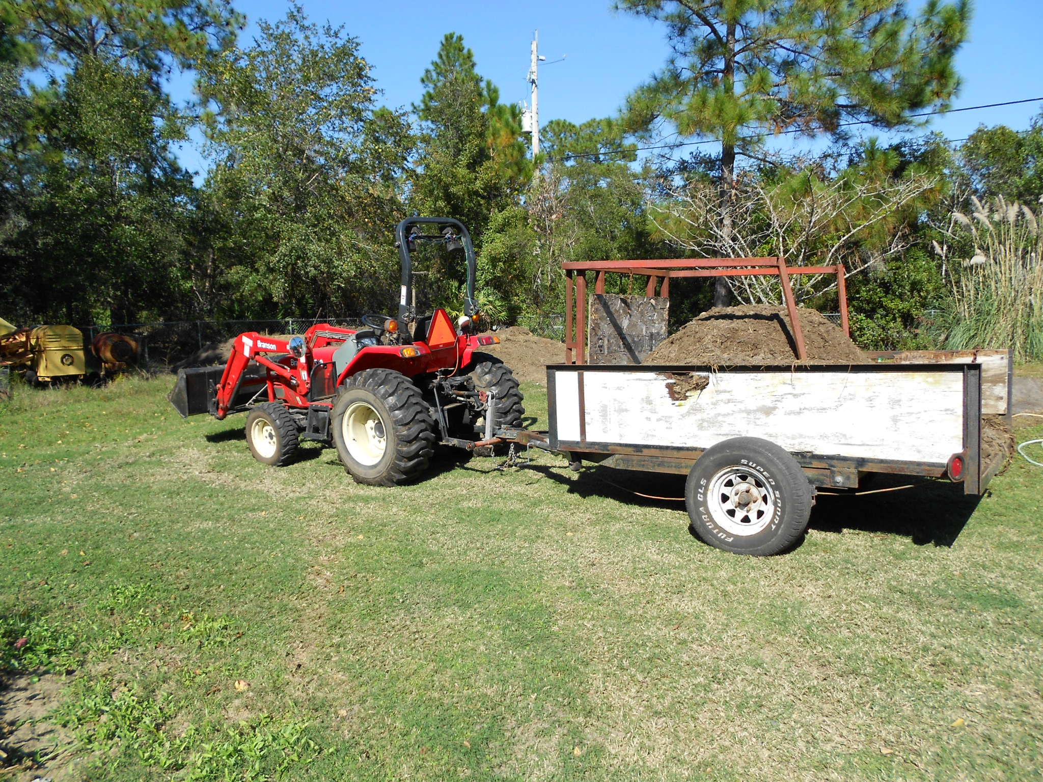

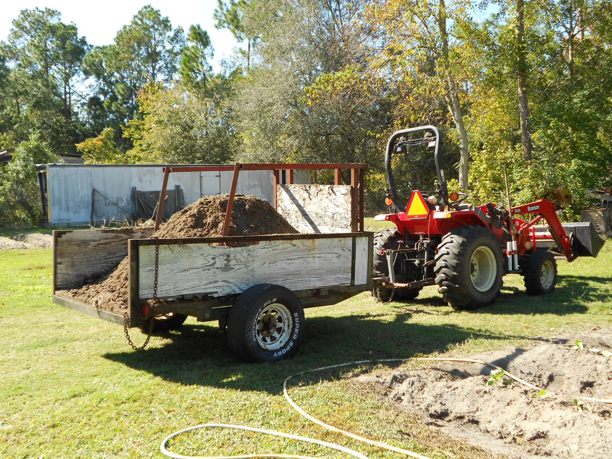

I have been composting Horse Squeeze and adding it to my garden for about 7-8 years.
While it has really improved my soil I have a horrible problem with weeds. A year ago I did 3 back to back treatments with Round-Up and still have a major problem.
I have tilled then waited for the new weed growth then burned them with a propane torch, planted and more weeds come up and take over.
I have taken 2 year old composted from the pile and put it in flower beds and the weeds come up big time.
The pics are how I haul the squeeze from the stables down the road. The trailer won't dump very well so I put the frame in the bed. I have the chain attached to the frame and I hook the chain to a tree and drag the whole load out easily!
You can see the pile in the background, I keep it turned over.

Stimw, how many weeds are growing on your compost pile? My guess is very few. Seeds need 3 things to germinate water, light and air. The soil has both water and air in it. It only takes a small amount of light to meet this requirement. Tilling or walking across the soil can provide this amount light. While the compost pile has these also it doesn't have the seed load of the soil.
Roundup has no residual activity. So it only kills what it hits the new flush is new seeds germinating.
Right now the pile is covered with weeds!! I need to spray it but have been working 6 days a week with my business since spring and can't seem to get to it. :(
Things are slowing down and I might get to spraying tomorrow. ???
