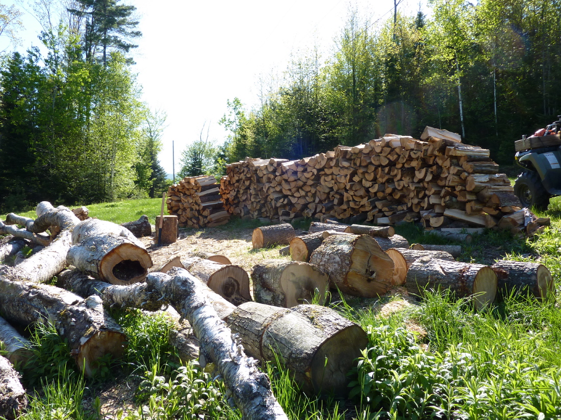

The northern hardwoods I deal with all split easier green. Mostly maple, yellow birch, ash, and beech. Beech can be a bear. I cut some apple once in a while and don't even attemp to split it usually. I use a 6 lb maul for stuff up to about 12" and go to 8 lbs after that. Then wedges and an 8 lb sledge if it won't crack. I can split a lot of wood with a high speed 6 lb maul. I think a 12 pounder would wear me out in a hurry. Frozen wood splits easier. If I have some tough blocks I'll save them for when it is below zero.
   / Manual log splitter #12
wait until its -25 F and it will all bust apart-no problems
Green & frozen works best for me! 6# or 8# maul. Feel like a young-un after a few hours of that on a clear, calm, 20 degree day!

Gordon I'm surprised you don't stack your wood bark side up . Helps to shed rain , then again could be an old wives tale !:laughing:
   / Manual log splitter #18
Everyone swears by thier own system when it comes to wood - I think it is a way of justifying all the work to yourself :laughing:
I stack it rough like that where I split it to get it out of my way and let the sun and wind get at it for a couple months. During a good dry spell in July I put it in the wood shed. I never noticed the rain being a problem. Only the top couple rows are real wet after a day of rain but they also get the best sun and dry out quick. Bark side up may be better, I don't know. To me air and sun are the most important for green wood. If I needed to keep it dry I would cover the rows with tin roofing.
