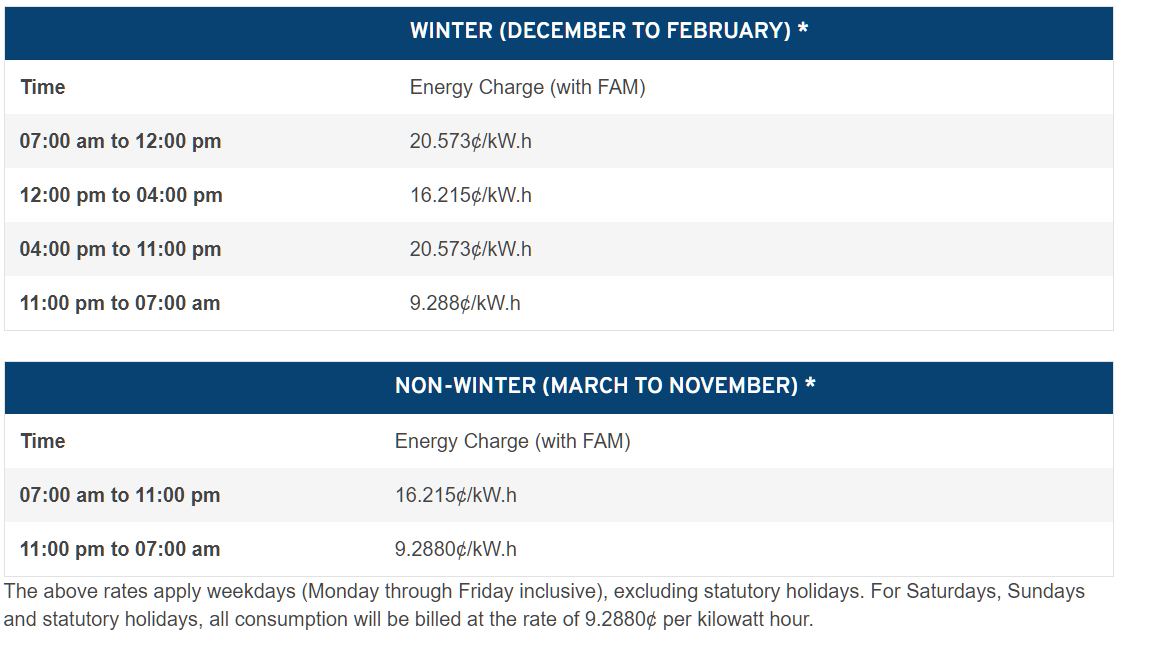

Ours, NS Power, only allows time of day rates if you have electric thermal storage for heat and controls approved by NSP. Not only that but the monthly charge is $18.82 per month if you're on time of day, conventional is $10.83 per month.
The per kilowatt is $16.215 per KWH on a conventional system.
The time of day rate has 4 tiers, screenshot so I don't have to type it.
I'm sticking with conventional thank you very much.
