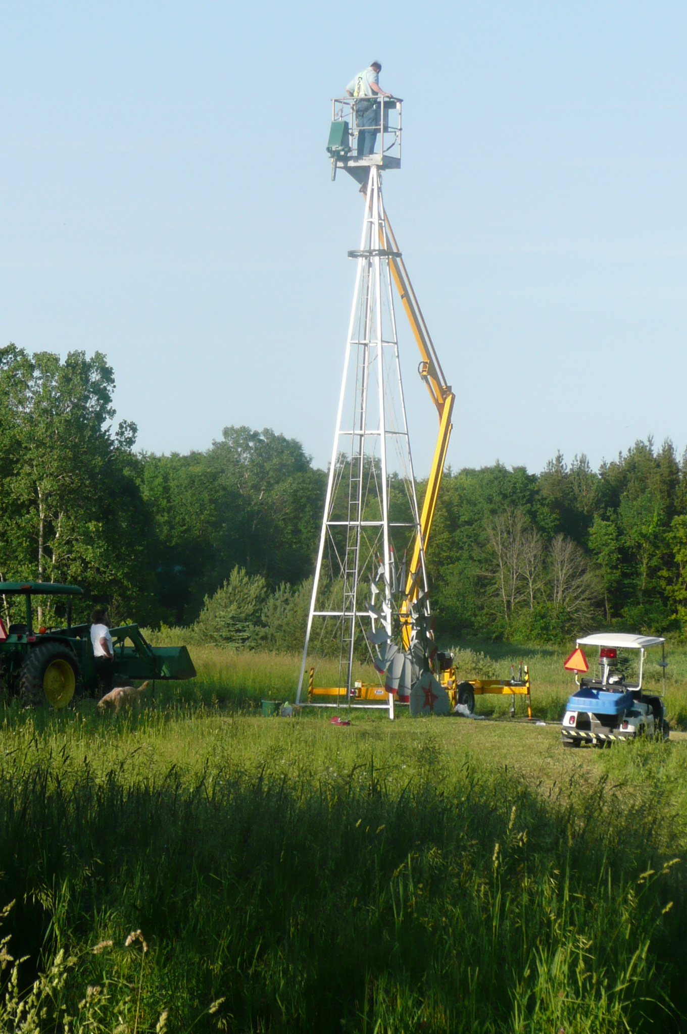

We had a 4 wheel drive dual fuel gas/propane articulated man lift on the farm for years. One of the handiest things we had but as we wound things down it just wasn’t getting used enough. I finally sold it a couple of years ago.
For my purposes I can’t even imagine using a tow behind.
/ Man Lift - Self Driving vs Towable #26
THAT, is EXACTLY the machine I want. The loader would be nice too. Gator I have! lol
What was the power in the Genie?
Can't tell the manuf of the loader.
/ Man Lift - Self Driving vs Towable #27
The Genie was a Z45-25 with six cylinder Ford engine.
The wheel loader is a New Holland W80 Tool Carrier.

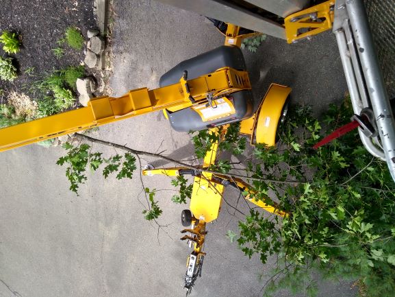

I recently rented a towable manlift for weekend. Did look at both at rental place. the towable is smaller I could get in to tight corner using tractor with receiver and ball on bucket. The self propelled version would have not got in to the space.
The auto leveling outriggers made it easy to setup. Left the truck in place and lifted it off ball. Raising outriggers dropped it back on ball.
Look at rated height for each. If you are close to max height will not have much side travels. Taller rated lift will give more room to reach over to stuff before having to go down and reposition the lift.
When trimming trees close the ground controls cover. Had branch hit the ground stop switch leaving me stuck in the air.
