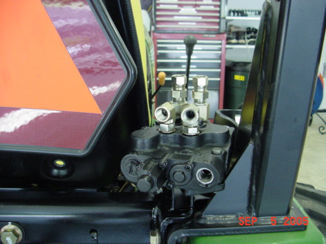

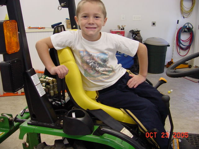

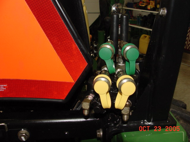

I used fittings to space my QD's apart, I just took the valve to the shop with me and they helped me...
I used QD's that matched my FEL just to keep everything the same...

kennyd, thanks for posting your pictures. You've got pretty much exactly what I had in mind. You've basically made a longer elbow for the set of ports towards the front of the tractor.
I swear I saw double and triple length elbow fittings sold as is but if I can't source them locally, or if they are not long enough to allow enough room for a QD, I'll do exactly as you did.
Love the mounting job you have done. I'm still trying to sort through exactly how to mount cleanly.

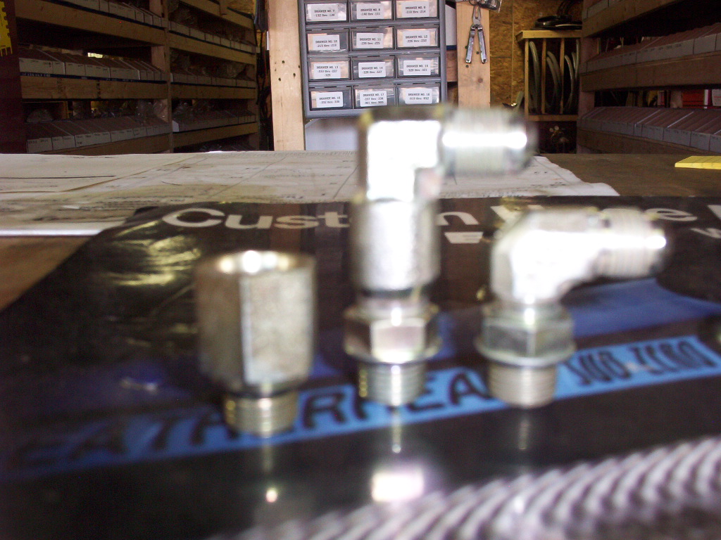

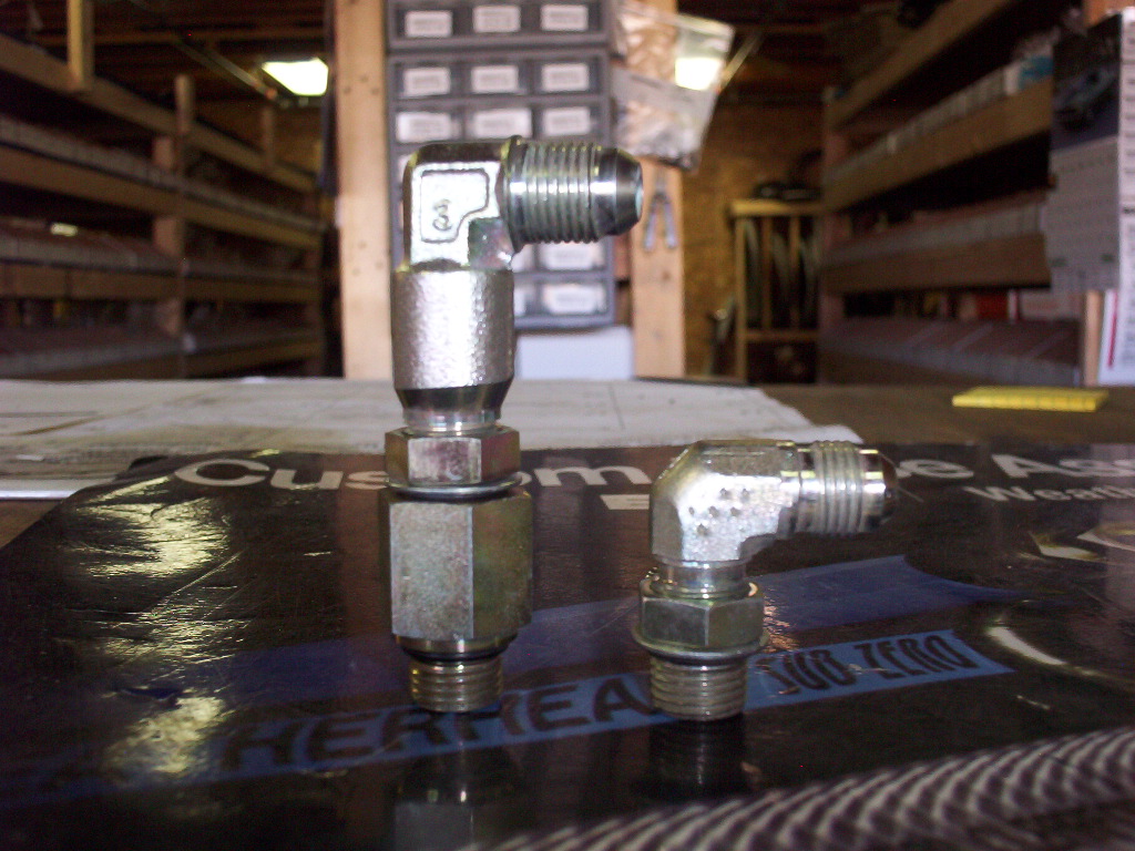

You could install these elbows below. They are -6 ORB X -6 JIC elbows. one long drop, other standard. There is also an extension on the long drop if you need more room.
   / Making sense of Quick Disconnects #8
I messed up. Here is the elbows without the extension attached.
Sorry about it being blurry, but I'm sure you get what I'm talking about.

WCH, that looks like exactly what I need.
Do you have any thoughts to share on the QD choices? Is it worth me putting on a ORB to JIC elbow given that QD seem to only take NTP? or are there QDs that accept JIC male?
   / Making sense of Quick Disconnects #10
There are ISO-A and ISO-B qd's out there that are ORB. You might want to consider flush face as they tend to be more compact and are readily available in ORB.
