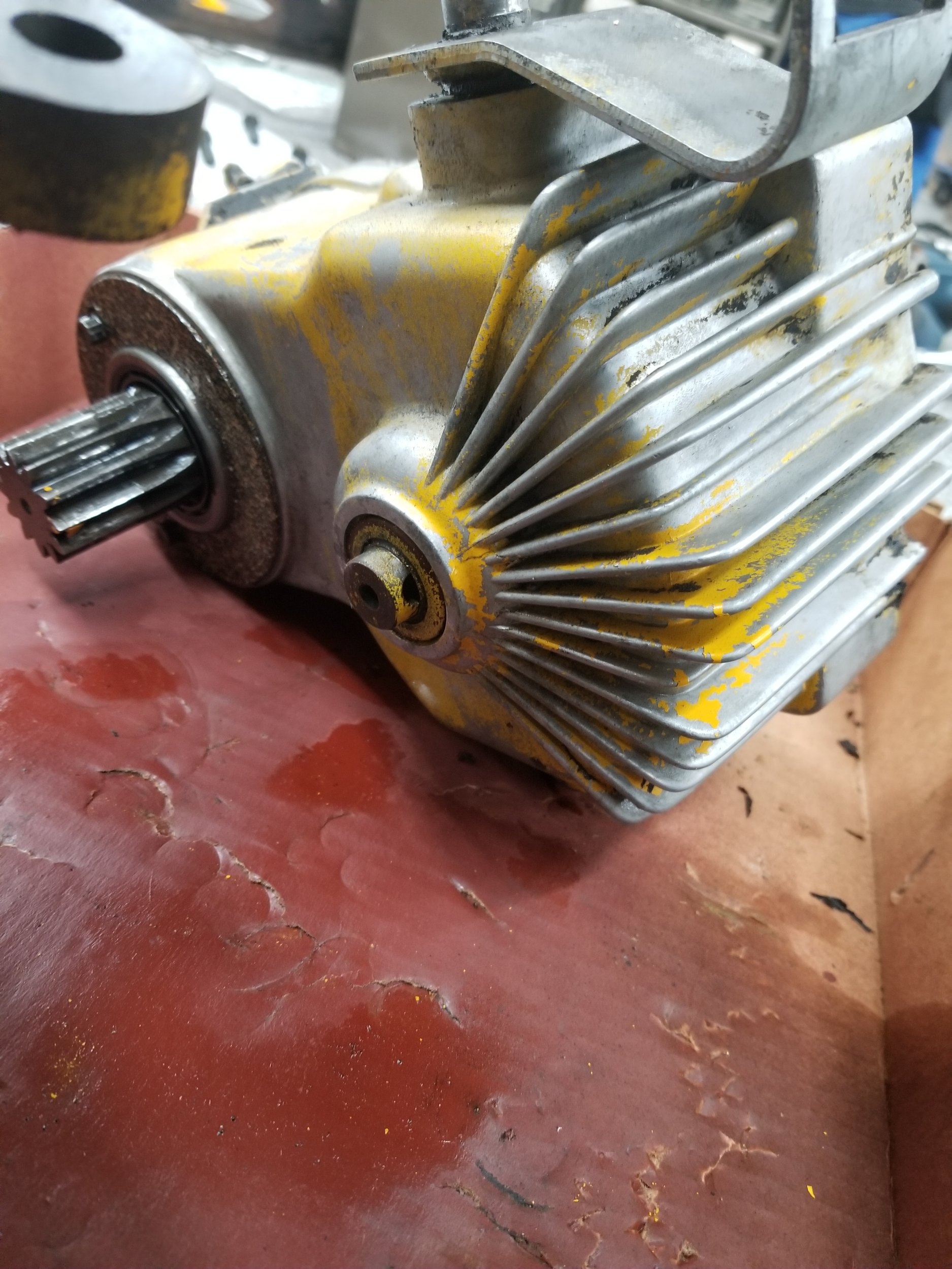

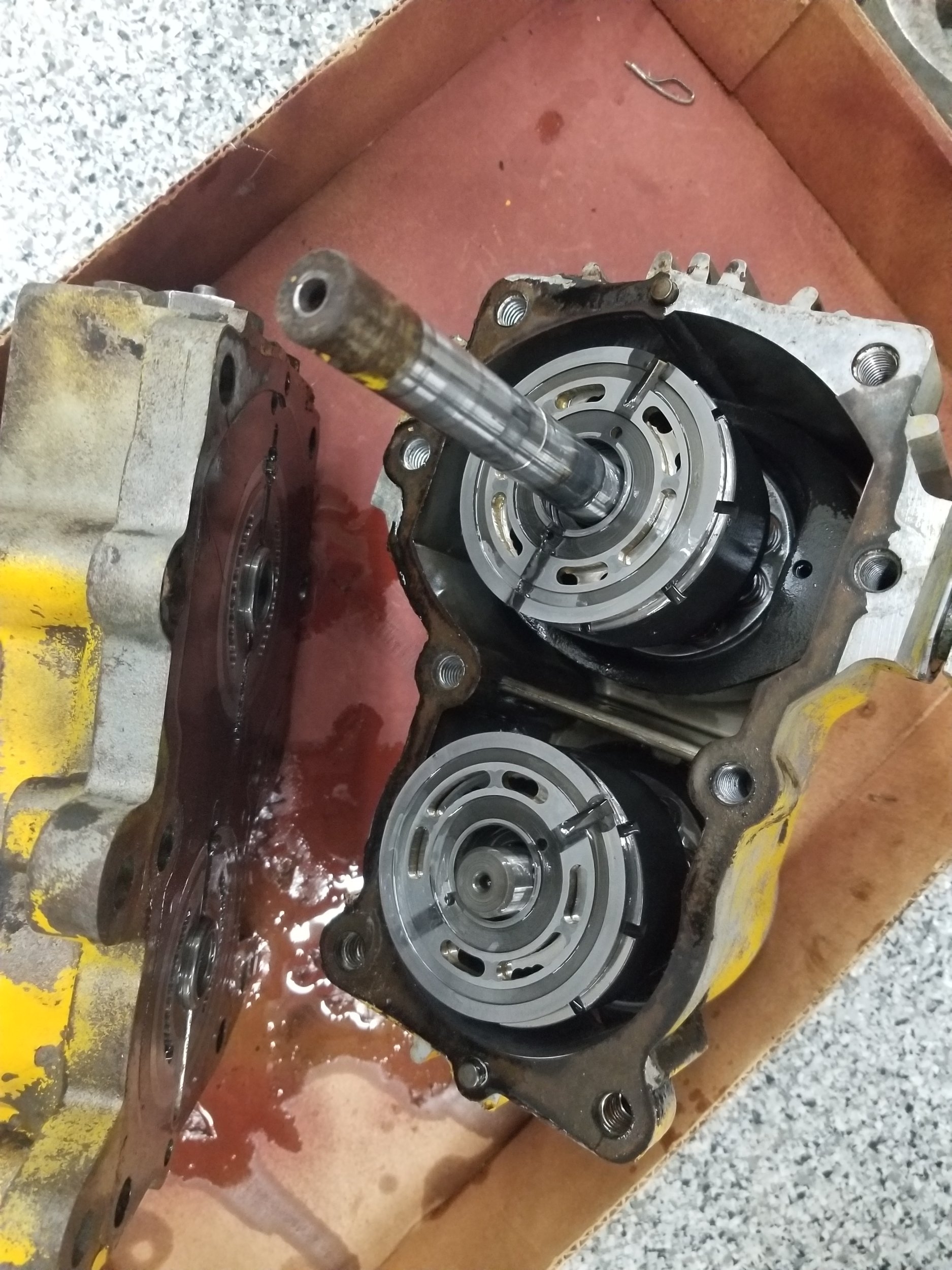

I am attempting to fix all the oil leaks on my Cub Cadet 127 tractor. I have most of them fixed with the exception of a leaking gasket on my hydrostatic transmission case. I thought I could order the part based on various web searches, however, after making several calls nobody seems to have it any more (Part# 394865-r1 or 3102875) so that means I have to make one. My first attempt success rate in fixing oil leaks hasn't been great so I thought I would post my plan and let members tell me if they think it will work or if they have a better idea.
The original gasket measures 0.0095 thick. Although I haven't scoured the earth looking, the thin gasket material isn't easy to find, however, I have heard of others using file folder material. It measures 0.010, which when compressed makes it perfect. So my plan is to use this file folder material with a very thin coat of permatex Aviation Form-A-Gasket No.3 on both sides of the paper gasket. I am not using the file folder material to be cheap, I just think it should work.....but again I don't have any real world experience in this and I would love to hear the opinion of others that have more experience than me. This is a huge PITA to take apart so I want to do it right the first time.
Also, I am not replacing the round output shaft seals. I hope I don't regret this. They aren't leaking, and I don't want to open up a can of worms by going deeper than necessary. Again, if this is a bad idea feel free to let me know.
Everyone's help is very much appreciated, thank you!

Any auto parts store, especially NAPA will have sheet gasket material (where I get mine actually) and I don't believe the gasket thickness (too thick or too thin) would adversely impact anything. However, instead of using Permatex, get yourself a tube of 3 Bond gasket maker and use that. I make a lot of gaskets, it's really pretty easy. 3 Bond is all I use now.

I would be very cautious using RTV (Permatex type stuff) in a hydrostat. Suggest using an absolute minimum amount as any blobs that break off internally can cause flow restrictions or other problems.
Also I would hesitate to use cardstock/file folder material as it will likely disintegrate with oil exposure over time. Rather I would find thin gasket material that's designed for oil exposure even if it's a little thicker. It's unlikely that the thickness is critical here
   / Making replacement hydrostatic transmission case gasket to stop oil leak (Cub Cadet 127).... I really don't want to screw this up. #6
Like MT states be very cautious on the application and use of RTV On those case halves. There should be minimal pressure in that case so a good paper gasket or careful application of form-a-gasket should work. Surfaces must be completely oil free for form-a-gasket to work and follow assembly and cure time instructions.

I am sure it would be fine, but I have also heard horror stories about RTV on pumps / motors / hydrostats which is why I thought I would focus on using the Aviation form-a-gasket No.3. When you said stick with form-a-gasket, I assume you meant the Aviation form-a-gasket No.3 like I mentioned in my original post.
In my search for the part, I did come across a guy that focuses just on the the older cubs and he said that thickness does matter. I also suspect the group is right about finding the appropriate material that is made to handle the oil so I will go on a search tomorrow for the correct gasket material and thickness. Better safe than sorry, sometimes I just need somone to keep me on the right path.
Thanks everyone, feel free to keep adding comments. My mind is like a sponge, I am happy to keep absorbing whatever wisdom you want to bestow on me.
   / Making replacement hydrostatic transmission case gasket to stop oil leak (Cub Cadet 127).... I really don't want to screw this up. #8
Yes the #3 product would be fine. Without physically looking at that unit I suspect changing thickness a couple thousands of an inch would not matter a 0.03 thick gasket would affect the pre-load on the rotating group(s) and may cause excessive leakage.
