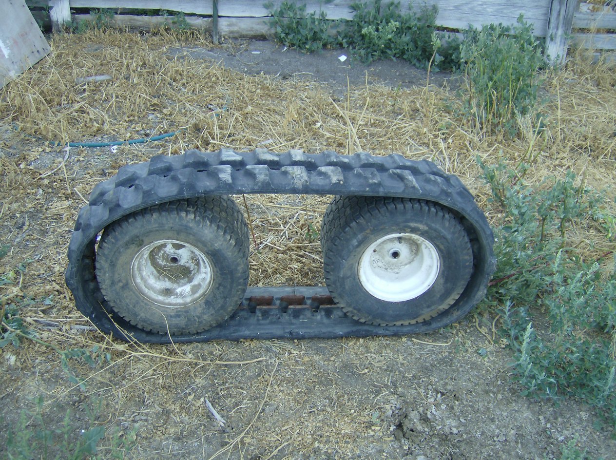

Here's a picture of what the track would look like with the tires as-is. It would be nice to have the wheels smaller and the track a little longer, but for the purposes at hand this will be okay.

/ Making One Tire Into Two. #27
I think that if you look for the mini excavator sprockets and idlers you will find it less expensive and simpler in the end. Resin is $80/gal You can see where that cost will go. Without reinforcing (fiberclass or carbon fiber of equal weight to the resin 50/50), it will have no strength at all.
You can save the rollers on the bottom and use a skid with 1/2" thick plastic facing to spread the weight. The plastic will be consumeable. Those tracks are made to transfer ground load to the undercarriage. If you don't support it between the wheels it will stretch out (elongate the links) in no time unless you vehicle will be very light.

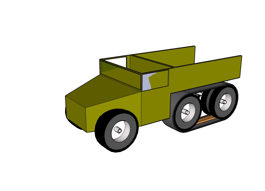

I understand the concern about the tracks needing to move at different speeds. That's the point in using the lawn mower axles. These axles have a differential built in.
It's a halftrack, so there will be wheels in the front that steer the vehicle. The tracks will provide the power. With the differential, one side can even be stationary while the other side powers the vehicle through the turn.
I've attached some images from a Google Sketchup sketch that I did to get some ideas regarding size and scale. There's an image of the vehicle as planned, and there's a closeup of the tires as currently planned.
