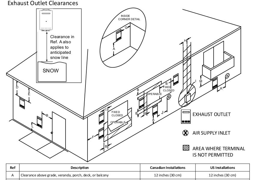

The image above is from a current Rinnai tankless water heater install manual. One can note how they have added the image clarifying height above the "anticipated snow pack" to the install manual. Perhaps it was open to interpretation before leading to the kind of situation described by the OP.
installation instructions reference things like this for a reason..
Any Licensed installer that installs in states that have this much snow , should know how to properly install equipment..
You can bet, If I were a installer in 1 of those states that can have 4-5-etc ft of snow.. I sure wouldn't terminate a vent only 18 '' off grade

And that type of thinking is what gets peoples house burned down, kill people from CO poisoning, when the safety fails to shut the unit down
I went to a home where a contractor installed a new furnace (gas) attached to an old rusted out flue vent...His thinking was the same.. the old furnace worked just fine with the old rusted out flue vent
The state revoked his state license.
there must not be any state or local inspections in your area.. or the installer didn't obtain a permit for the install..Installed it under the radar so to speak
