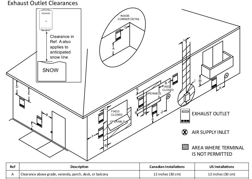

We have a Rinnai wall heater in NH. There is an exhaust vent to outside about 12" above ground. It snows a lot here and if the snow covers the vent while we are away, the unit will not run.
I guess most people make an A frame to shield it. I'm obsessing over the height, width, and whether to plank in the sides or not. We can easily get four feet of accumulation though I clear it a few times a winter.
Anyone built one? I'm probably making this too complicated....

Most if not all codes, manufacture instructions state to terminate vents a min. of xxx above grade, and xxx above grade in areas prone to have heavy snow..
You shouldn't install an appliance how ever you want ,Just because you can't meet min. code or manufacture requirements

Guess you have to do what ever works.. I would have never install a vent existing or other wise that low in an area that gets 4 feet of snow.. The mfg. instruction sheet may state a min. of 18'' off the ground for an area like I'm in. but , not yours...
/ Making an A frame for a heater vent #10
The image above is from a current Rinnai tankless water heater install manual. One can note how they have added the image clarifying height above the "anticipated snow pack" to the install manual. Perhaps it was open to interpretation before leading to the kind of situation described by the OP. Best course of action would be of course to raise the unit to a more acceptable height in the first place.
installation instructions reference things like this for a reason..
Any Licensed installer that installs in states that have this much snow , should know how to properly install equipment..
You can bet, If I were a installer in 1 of those states that can have 4-5-etc ft of snow.. I sure wouldn't terminate a vent only 18 '' off grade
