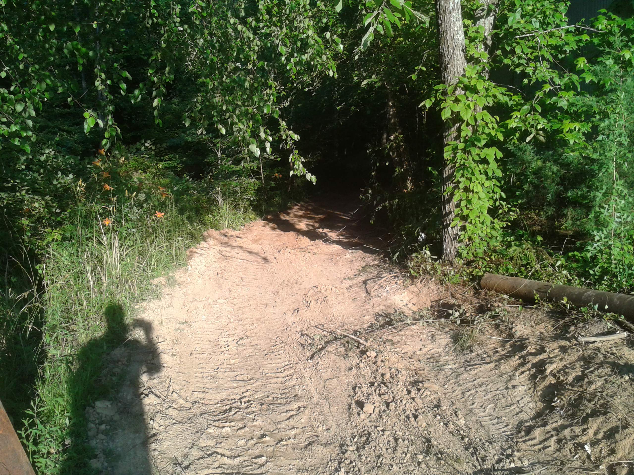

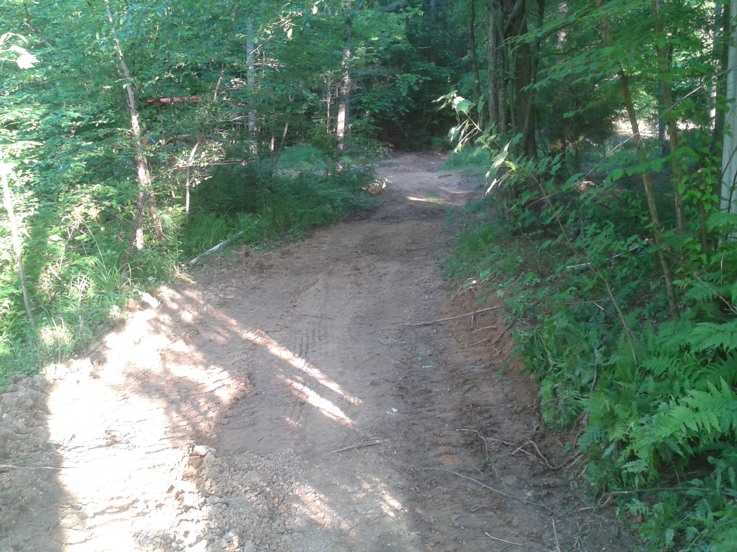

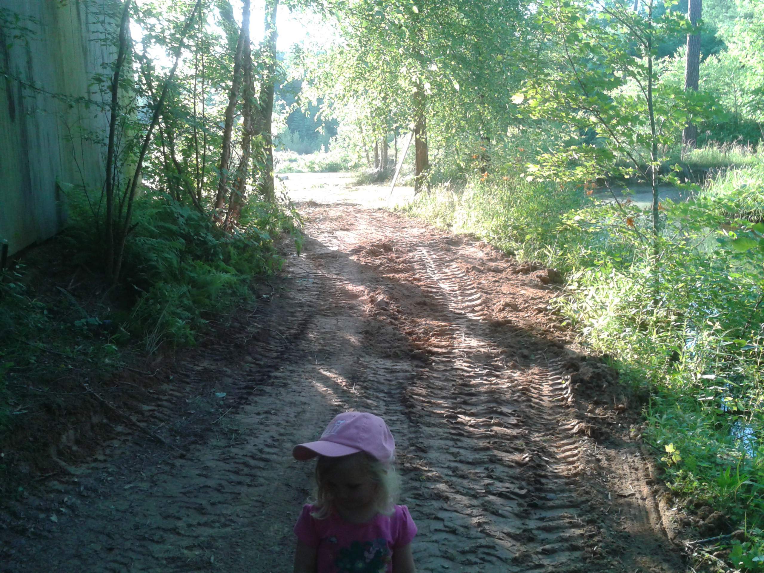

Guys,
Update. I've begun the widening. I've added almost a foot at the narrowest and actually straightened it out a bit. I've added a couple NOW pics for comparison. I've got a 7' pipe section, but I have a much longer one I need to fish out of the brambles and cut to size that I think will work better.
I used the ratchet rake and bare bucket so far. I need some sort of blade I suspect...
How am I doing?
Be well,
David
