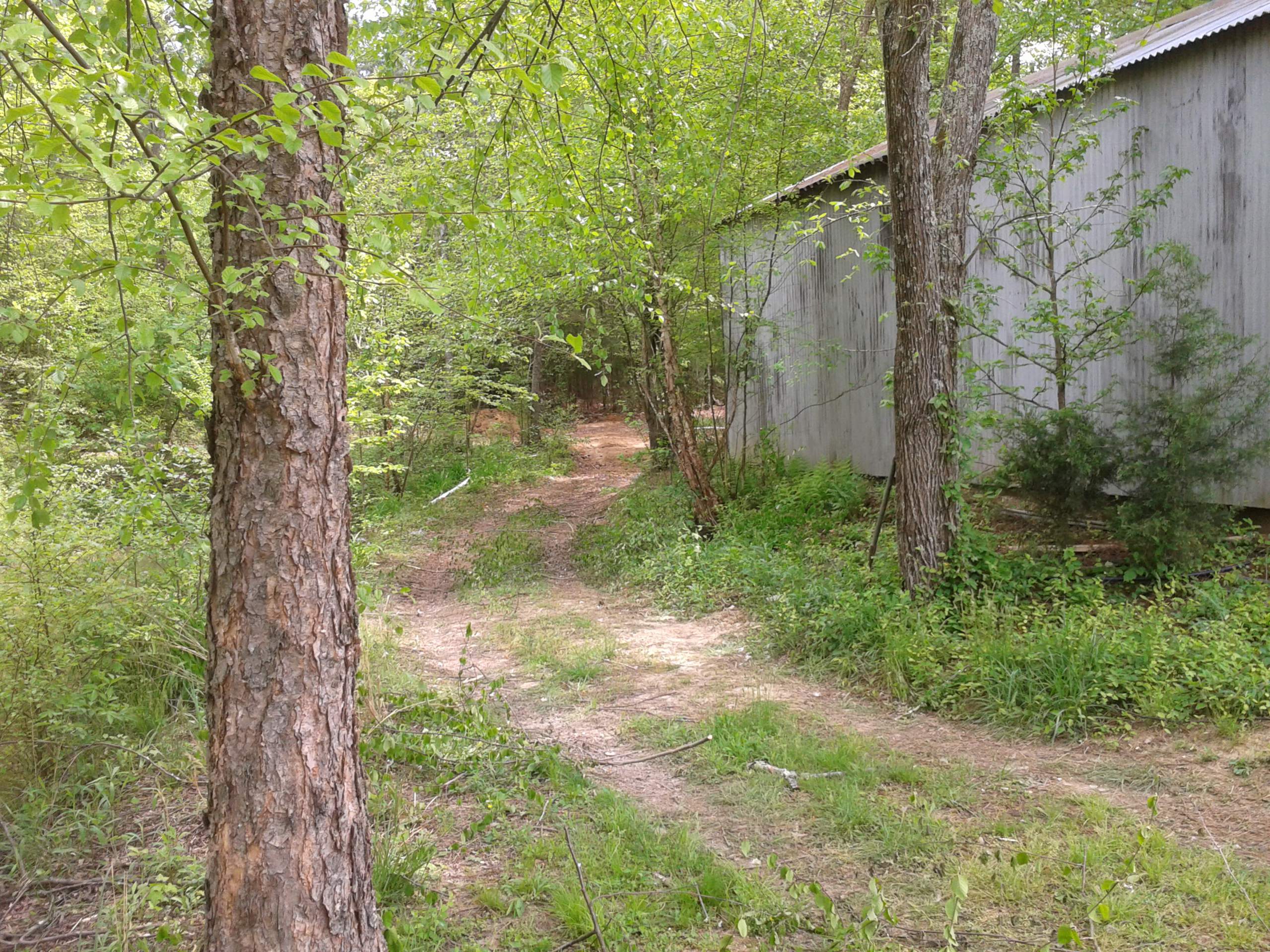

Guys,
I am trying to rebuild an old and overgrown tractor road. Clearly I have a bigger tractor than the other guy had and I'm having issues.
My biggest problem is that I have wet spots. The ground slopes and the road runs alongside a pond. when it is dry and has been for a while the road is awesome. if it has rained, Oh Golly! it turns to serious mud and the tractor tears it up, digs ruts and makes a mess. To top it off, the part in the picture, right by the "barn" is not level, it slopes towards the pond.
I really would like this to work. It is the only way to get access to park the tractor in the barn where my hay etc is stored without tearing up part of the "yard" with a tractor road.
I have added some fill to the low spots, and I though maybe it was dry again, and I tried to backdrag it smooth and all I got was deep muddy ruts.
Do I need to add gravel? I can add tons of pine straw and or leaes or other organic material to soak up water, but I suspect that will be worse.
I do not have a "stream" I can cut a culvert for to divert the water, this is more like seepage and I have 3 distinct "wet spots".
Thanks in advance,
David

I'd put down a couple pieces of 4" plastic pipe across the road, cover it with filter cloth and then a foot of slag, crushed limestone or crushed rock... something with jagged edges to keep it in place. Any seepage should travel throught the pipes from the high side to the low side. The filter cloth will help keep the crushed rock from getting pushed into the mud by the tractor. A foot is more than enough to cover the pipes.

Dave,
That does not look like seepage (per se). That is the point that all of the water from the surrounding area flows through. In my area it would also be wet even days after rains because the top soil is on a clay base.
Not an expert, but that spot appears to need what Mosswood noted.

You can fix it as outlined by MossRoad. We have several miles of such roads and just use crushed rock. Depending on the amount of water going over, we use 1" to 2". It has worked well for us the 20+ years we have had the roads. We do have a fairly high clay content, so the rock doesn't work down. On some soils this won't work.

Jim,
I believe your diagnosis is correct... I have heavy clay with a little topsoil. when totally dry it is awesome, but after rain... mudbog for days...
I will try to take some new pics and get the other two areas also. One is a corner boggy spot and I just swing wide around it and I'm fine...
RRR,
You do NOT use the pipe, just dig out a channel and lay down crushed rock?
Did you use the fabric barrier?
Thanks,
David
David,
So lets see if I understand...
If I go cut a 1 foot deep channel in the wettest section across the road. Then I lay down filter cloth (Is this like weed barrier cloth?). Then I lay down some sections of 4" plastic pipe (PVC?) fold the filter cloth over the pipe ends and cover the whole thing with jagged gravel (Crush & Run, etc.).
This in effect makes a culvert in the wet spot. seepage flows through the pipe and gravel and the gravel keeps the pipe from crushing under the tractor.
How much wider than the "road" do the pipe sections need to be? do I need a clear flow path from the exit of the pipes (like a channel to the pond, or ???)?
I just want to make sure I understand.
I will have more questions when I have more pics to show you...
Thanks. This is exactly what I was hoping for, clear advice.
Be well,
David

RRR,
Thanks,
David
No, we just put down rock; no pipes or cloth barriers. Not that doing so won't work well as it will, we just would spend a fortune due to the amount of roads we have.
We don't have any problems with mud and excess water just flows over the roads. We did have some washouts one spring, but pipes wouldn't have helped as the waters went over our county road with 6' culverts.
We have culverts to allow some drainage ditches into our ponds or in really bad areas, but they are up to 36".
We tried some 4" pipe in a couple of places when we first put our roads in, but they were always clogging up with leaves, sticks and such.

Hard to tell the depth of the hole from the photos but a small black drain pipe might be large enough. Depends on how much area is being drained.
All of our driveway, maybe 750 linear feet 12.5 wide, uses geotextile fabric on grade followed by ABC gravel. ABC is road base in NC. It is fines aka dust up to maybe two inch long gravel. This stuff locks up tight. The fabric helps distribute the weight of the vehicle and keeps the gravel from being pushed into the clay.
We should have 4-6 inches of gravel over the fabric but in most places we have 2-4 inches. The areas with 2 inches of ABC needs more gravel but whenever we budget adding more we spend the money elsewhere because the driveway is just fine. The driveway held up with seven cement trucks that poured our slab plus trucks for the foundation pour, bricks, dump trucks and misc construction traffic. Without that fabric the driveway would have been torn up.
Drainage pipe needs X number of inches to support a given weight. I look up my culvert years ago and it was supposed to have 12 inches. I might have 6 inches. You will want enough gravel over whatever pipe you use to keep from crushing the culvert.
Geotextile fabric is like to landscaping fabric but different. For what you are doing I might use the landscape fabric if that was all I could get. I have a local supplier that sells geotextile. He has fabric that is 3', 6' and 12.5 feet wide. A roll was 360 feet if I remember right and roughly $1 a linear foot for the 12.5 inch wide material. He would sell by the linear foot.
He has two types, a woven and mesh fabric. The woven stuff is kinda like a how a tarp looks. The mesh is sponging and I think allows more water to pass through. I used mesh. It smelled of asphalt and was made by Amoco if I remember right. I could cut it with a utility knife but the stuff would dull the blade ASAP. It is pretty tough stuff.
Our "soil," I use that work loosely, will rut up in a heart beat in the winter wet. I will not drive the tractor off gravel in certain areas during winter. Once the trees leaf out and start drinking ground water the ground dries out and the tractor will not cause ruts. There are ruts on our place, some quite bad, from tractor used to log the place 70-80 years ago.
Later,
Dan

All great suggestions here.
I have dealt with a similar issue in a wet spot on a tractor trail by dumping a few buckets of #57 gravel over the top (had a pile of it on hand for another project). Solved the problem instantly. You could definitely improve on this by putting fabric down first, but I was in a pinch and didn't have time to run out and get some. Fabric will prevent the stone from possibly sinking down into the mud. That may or may not be a problem. It hasn't been an issue for me so far in this one spot -- the mud and rock locked together down below, and there is still a few inches of loose stone on top.
I had another wet spot near the bottom end of a hill, where runoff and groundwater naturally flowed. For that, I cut a shallow drainage ditch on the uphill side of the trail and ran it farther down the hill to carry the water away from the trail. I filled the ditch with #57 to level it off, with weed fabric underneath to prevent silt from clogging up the stone. White septic cloth would also work fine for that sort of thing.
