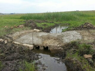

Ditch crossing for high water and low flow rest of the year. Works excellent! Self build.
/ Making a ditch crossing #32
That is a great looking crossing. Looks like you need one more concrete block on the right side of the photo to finish off the anti-wash out retainer wall though.
/ Making a ditch crossing #33
Pic was taken right after concrete was poured last week. There is still some finishing touches that needs to be made ;-)
/ Making a ditch crossing #34
Made many of these types of crossings in the past. They work excellent.
