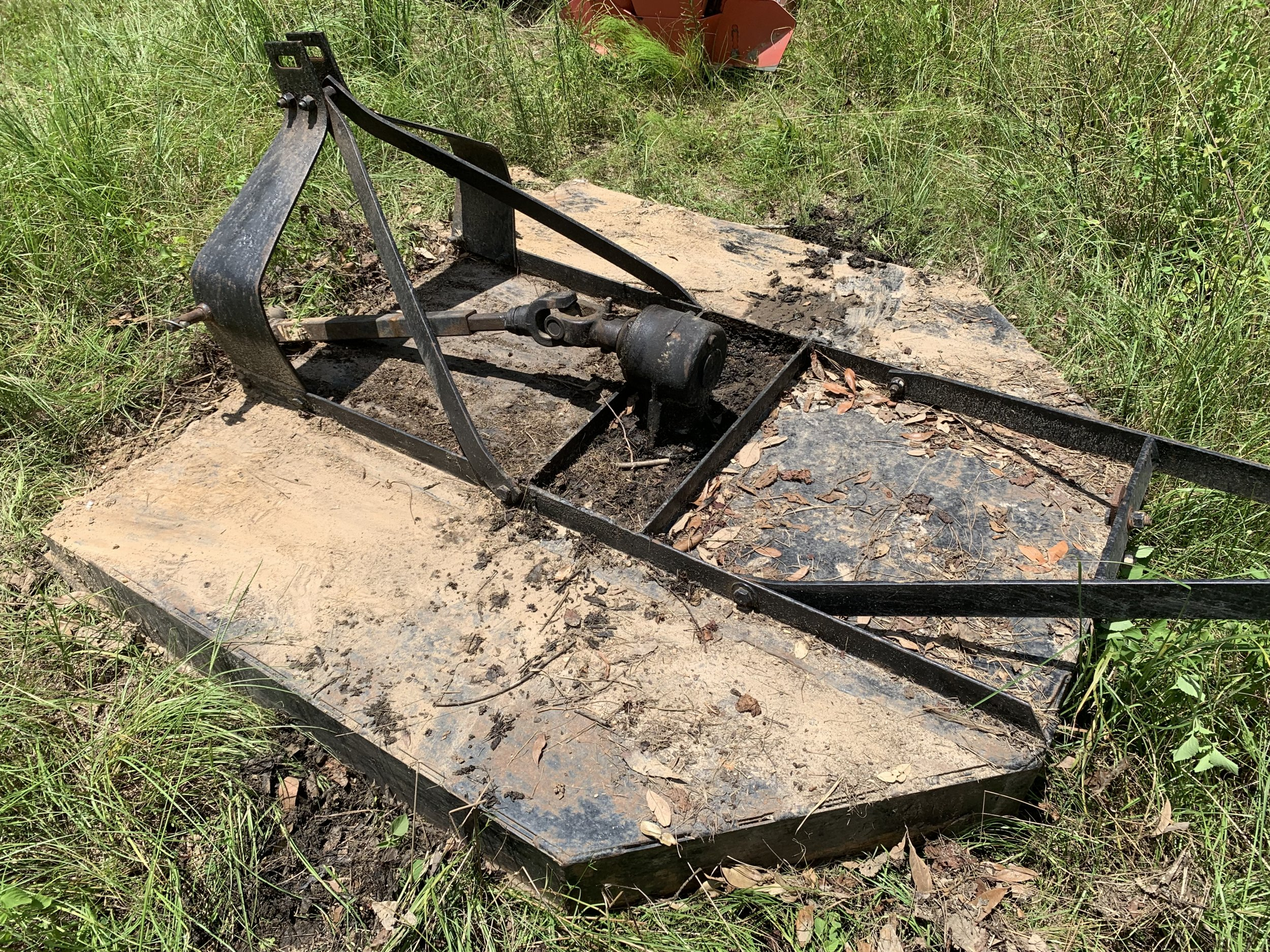

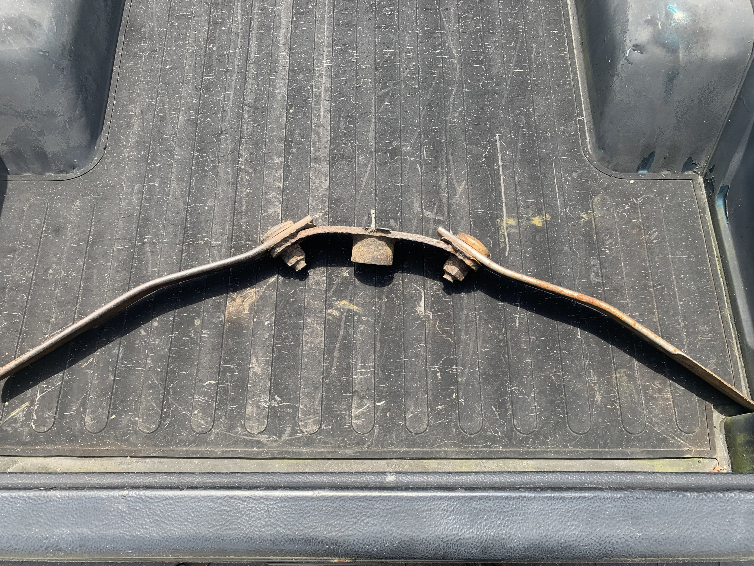

Mitsubishi MT372
Trying to determine make and model of this cutter. It was originally red and I thought it was a Bush Hog. But couldn’t find it on their website. I need a blade bar (a lil bent) and flange nut. I purchased a M30x2 nut, but it was too big . The shaft appears to be 1”. Any help would be appreciated.

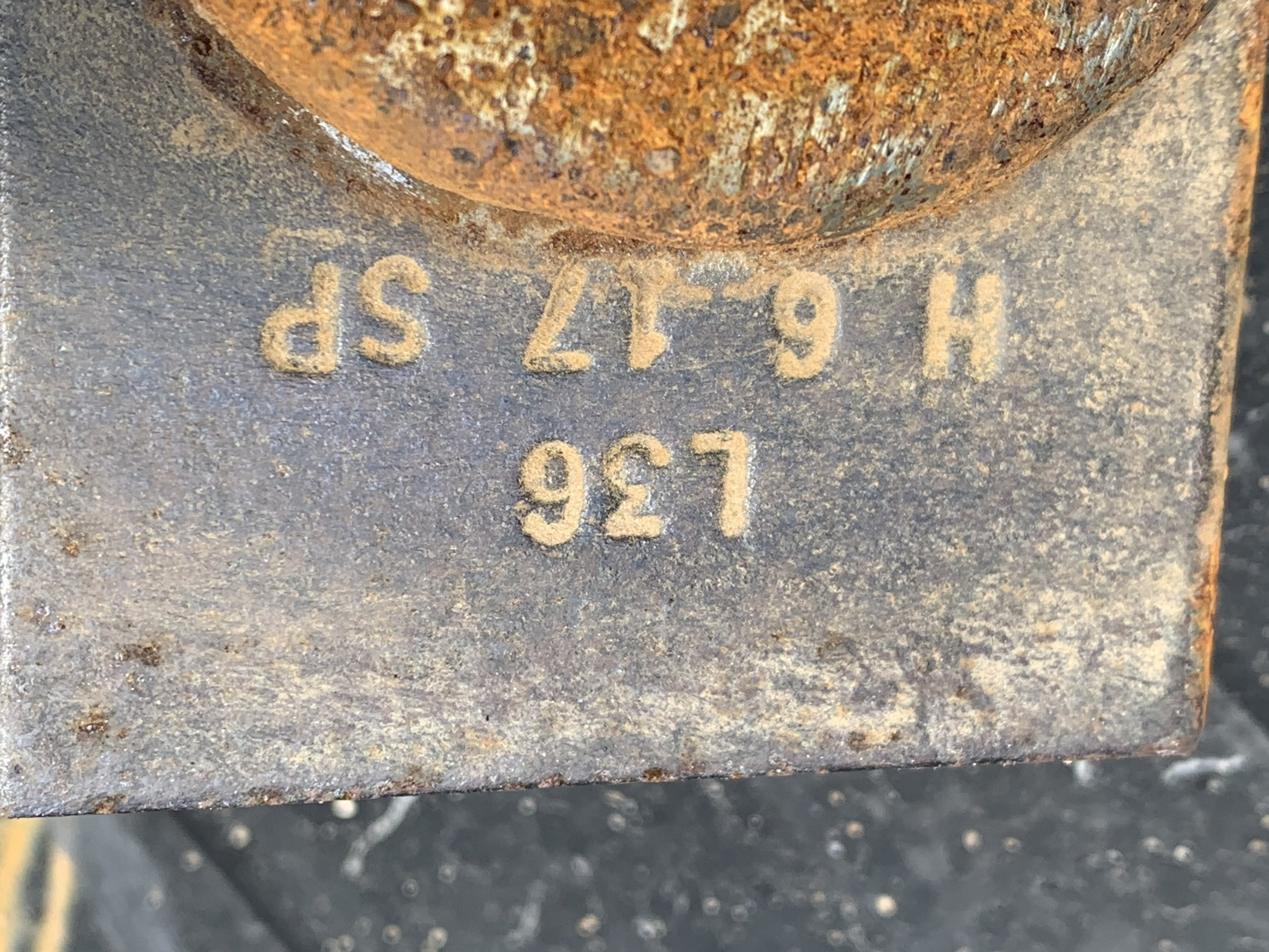

Can you find a number on the blades anywhere? Also, there could be a number on the cutter bar.
   / Make and model?
Yes, the numbers on both blades -
H36
H. 6. 17. SP
   / Make and model?
Should be L36
   / Make and model? #5
H36
H. 6. 17. SP
Perhaps a Titan/Branson mower, discontinued. Only difference was the stump jumper bellypan on these mowers.
chrome-extension://efaidnbmnnnibpcajpcglclefindmkaj/https://www.ironcraftco.com/_files/ugd/352071_56261e1d570545919ce916640d71e143.pdf
What is the width of the mower? What is the width, thickness and length of the blade?
   / Make and model?
5’ mower
blades - 25”x3”x1/2” .
Bar is 16”x4”x 1/2”

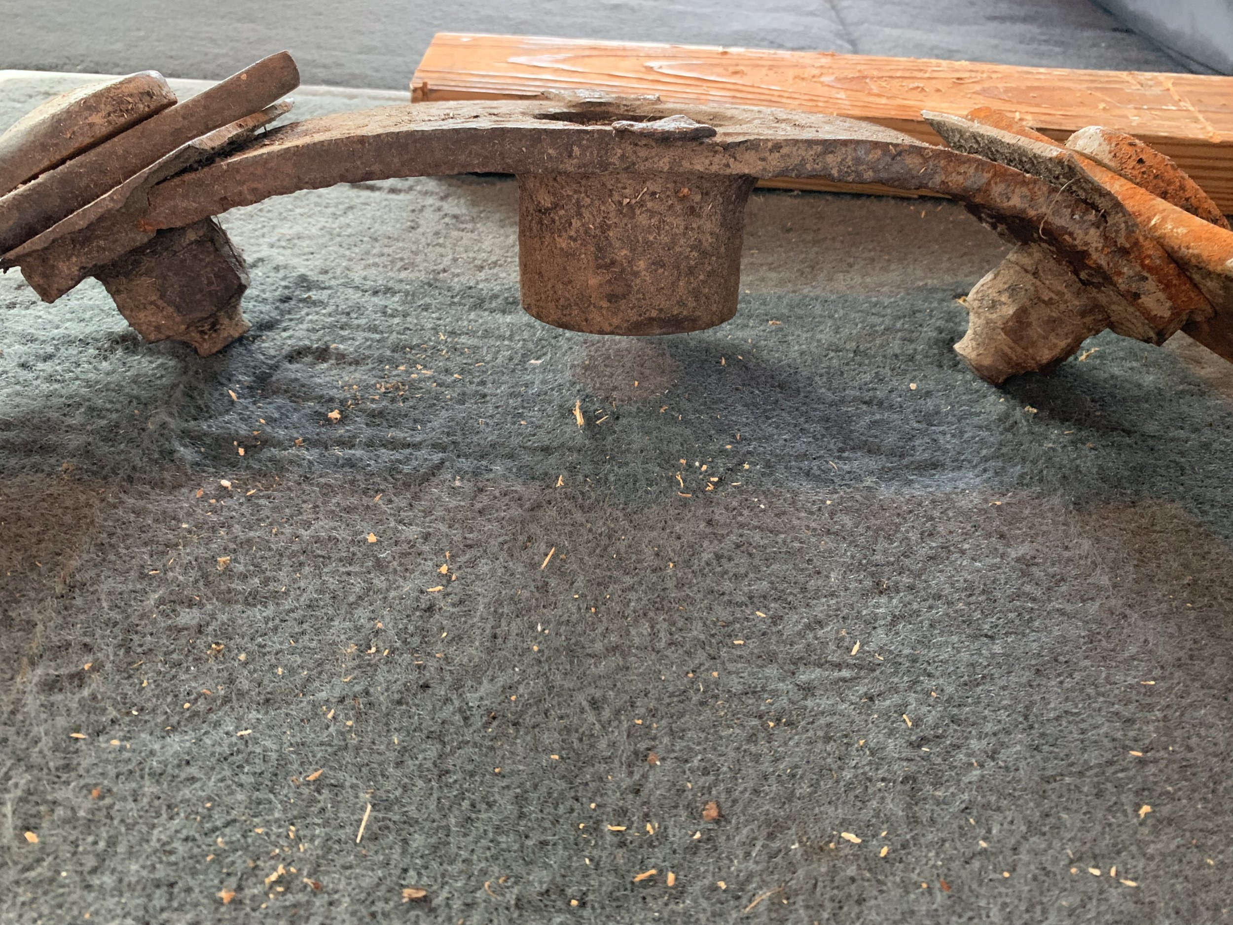

   / Make and model?
Picture of blade assembly
   / Make and model? #8
It could be a Titan 1105 or a KingKutter. I see all with a disc stumpjumper blade carrier, but could be an earlier mower. Find a blacksmith shop with a hydraulic press that can straighten your blade carrier OR by a belly pan for KingKutter that matches your hole diameter and spline count.
   / Make and model? #9
Blade for KingKutter: 24
   / Make and model?
Ok, thanks for the help. I’ll start there.
