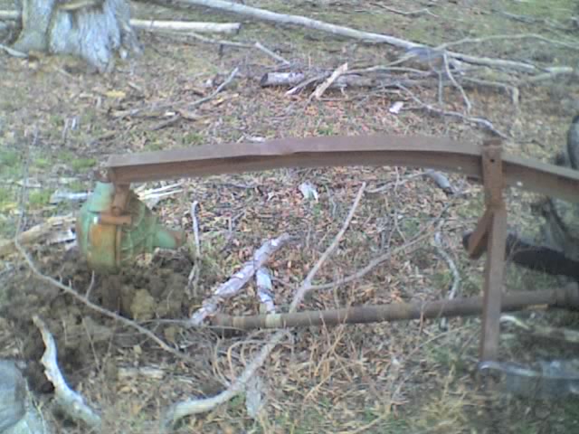

/ Make a post hole digger? #5
Checkout harbor freight.com, They sell a cheap pipe bender, upto 2" pipe........mine was 99$ plus tax a few yrs ago.
/ Make a post hole digger? #6
You can notch and weld square tube,notch and weld round pipe.
You can do what I do....build a fire,toss in the pipe and go have a cup of coffee. When the pipe is nice and hot,bend it under the tractor.
Grandpa never owned a bender and so far neither have I.
You'll most likely have struts coming up from your lift arms anyway so weakening the pipe from the heat should not matter at all.

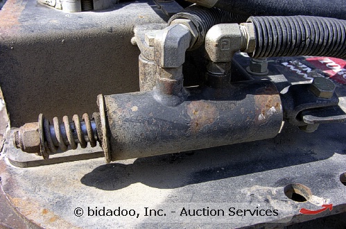

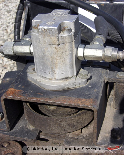

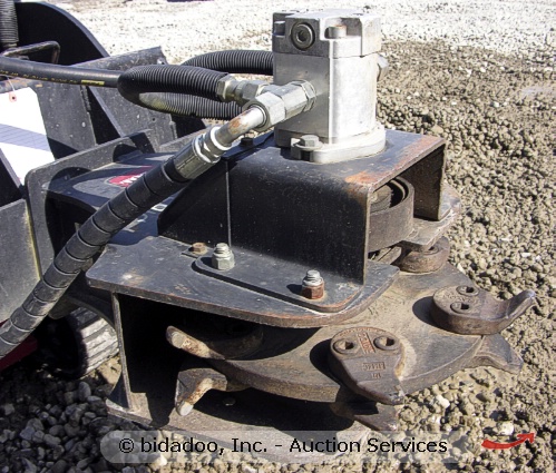

I was looking at this Stump grinder on a auction place not too far from where I live. I really don't need a stump grinder even though I am in a tree business. But this thing looks pretty tough. It looks like it probably goes on the front of a skidsteer. The hydraulic motor is what interested me. It probably wouldn't be strong enough for a PHD though? If you go to this link they have a little video clip of the thing running.
