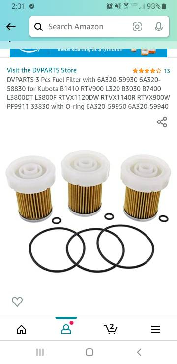

Replacement fuel filter for 3016. Much, much cheaper than ordering OEM part. And they work just fine.

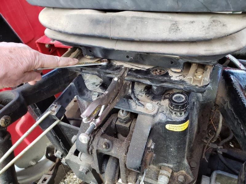

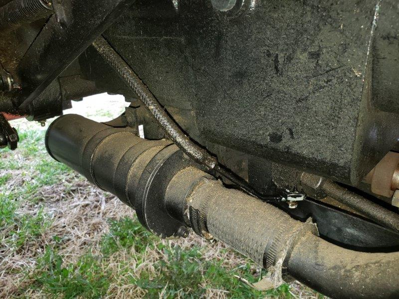

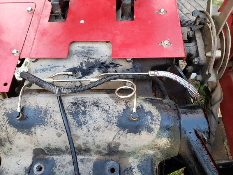

HYDRAULIC ROCKSHAFT LUBRICATING LINE FOR 4530 4WD, 4025 4WD, 4540 4WD, 4550 2WD & 4WD, 5545 4WD, MAHINDRA TRACTORS (E007205688C2)
-So, this has been leaking for quite some time, this braided line that comes from the bottom right underside and splits into 3 connections under the seat. All 10mm banjo fittings.
1. Remove 2 bolts from back of the adjustable seat mount (slide the seat forward to access), then slide the seat all the way to the rear, and tilt forward. (if you don't slide the seat back, it will not stay tilted forward)
2. Snake the new line into place, and swap the bottom connection first. It will leak fluid so be prepared to do it quickly.
3. Swap the top 3 connections and you are done!
Note, they didn't make it easy to remove the 2 bolts from the back of the seat mount. I used a vice grip to compress the two plates together. See last picture.

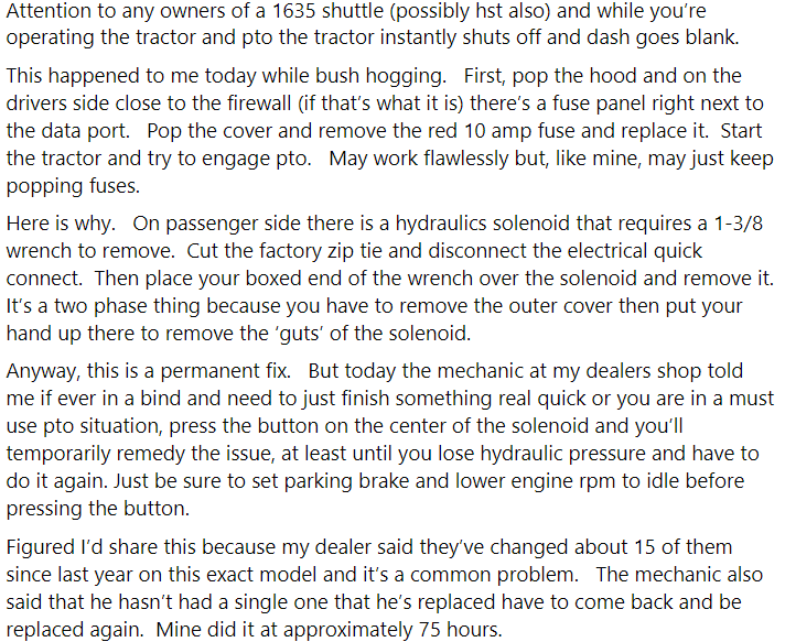

1635 shuttle pto issues: the tractor and pto the tractor instantly shuts off and dash goes blank.
