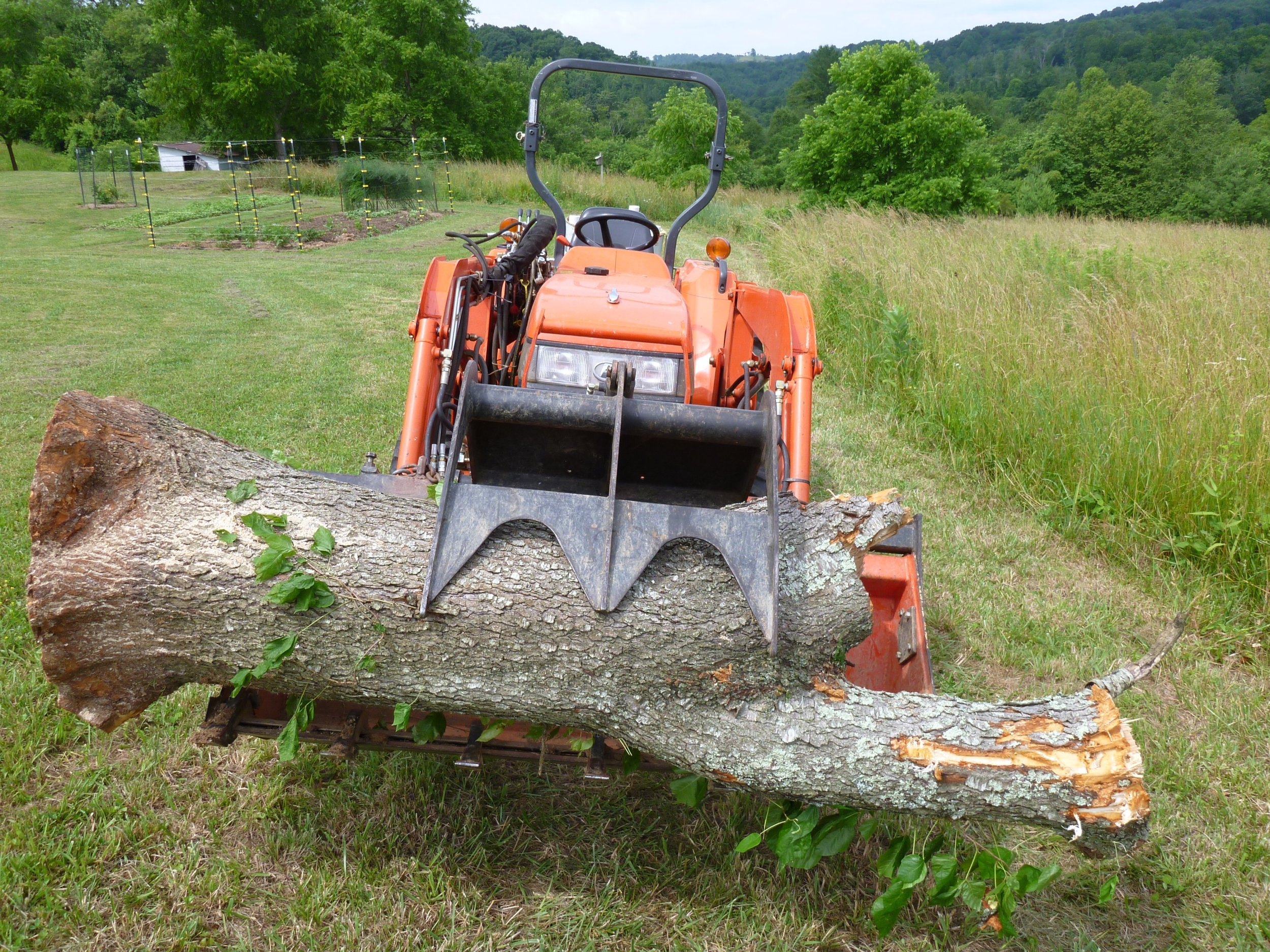

3. unrelated to maintenance but curious where you guys get the jaw attachments for your buckets? I'd prefer some single piece jaws that just bolt on to the existing holes. is that a thing? or do you generally have to get the whole bar?

I don't have a brush grapple, but if your bucket uses a quick attach setup (SSQA, Euro, or JD) I would get one that utilizes your existing quick attach. If you have a pin on bucket, there are several companies that make bolt on the bucket grapples. The bolt on grapples will almost certainly require some drilling. I doubt finding a complete pin on grapple (replacing the bucket) will be possible.

If you are asking about bolt on grapples...Look at WR Long.
They are nice to have to pick things up!!! Add a tooth bar for more function!!!
