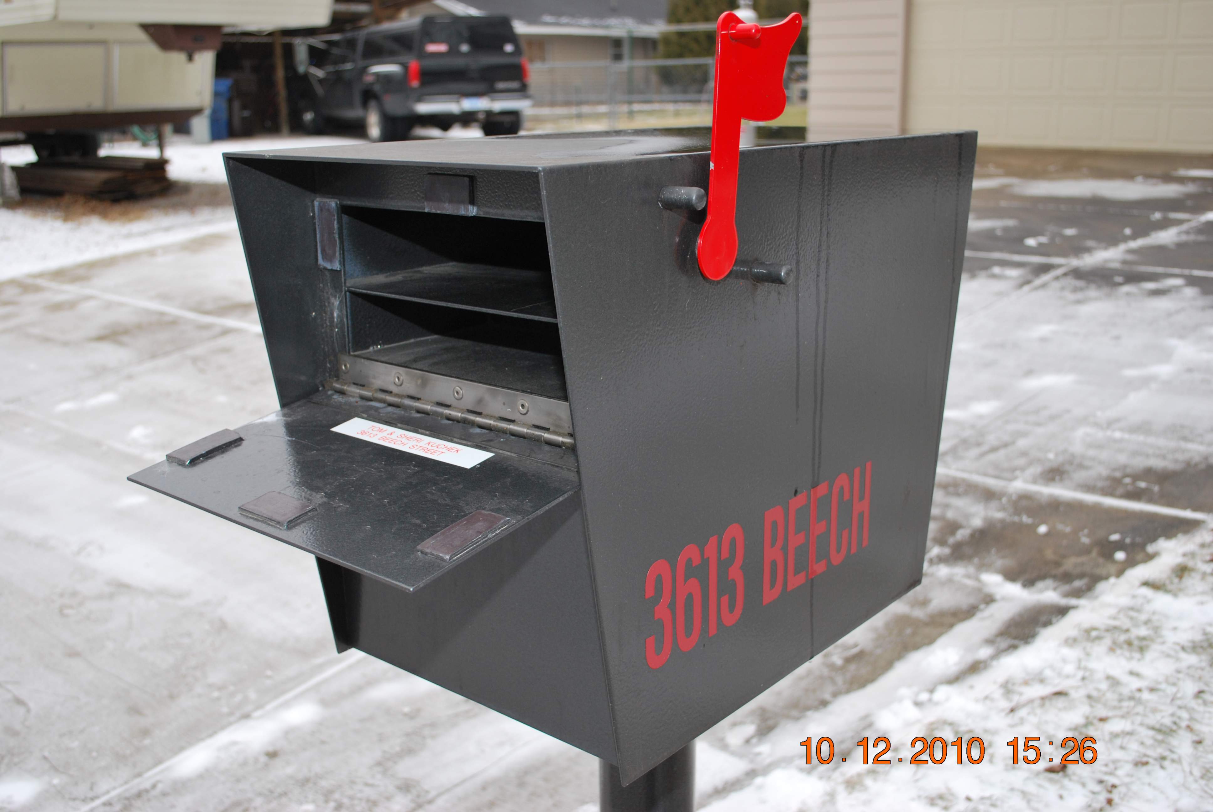

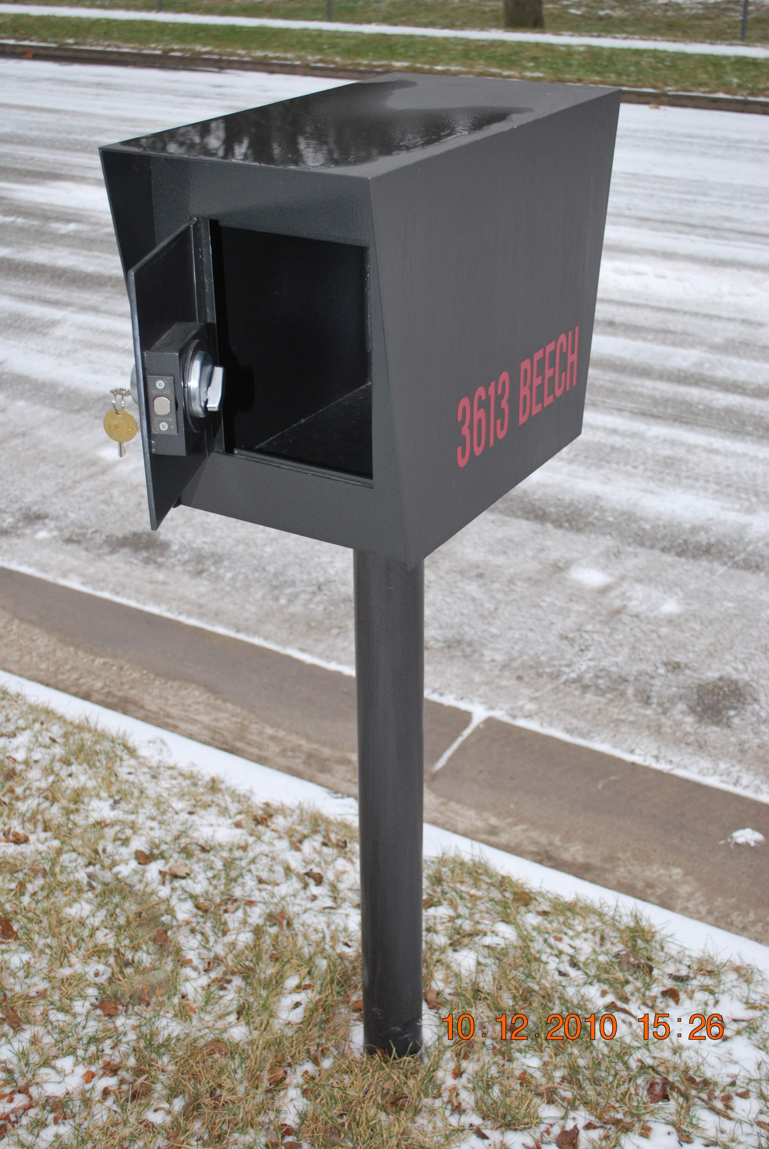

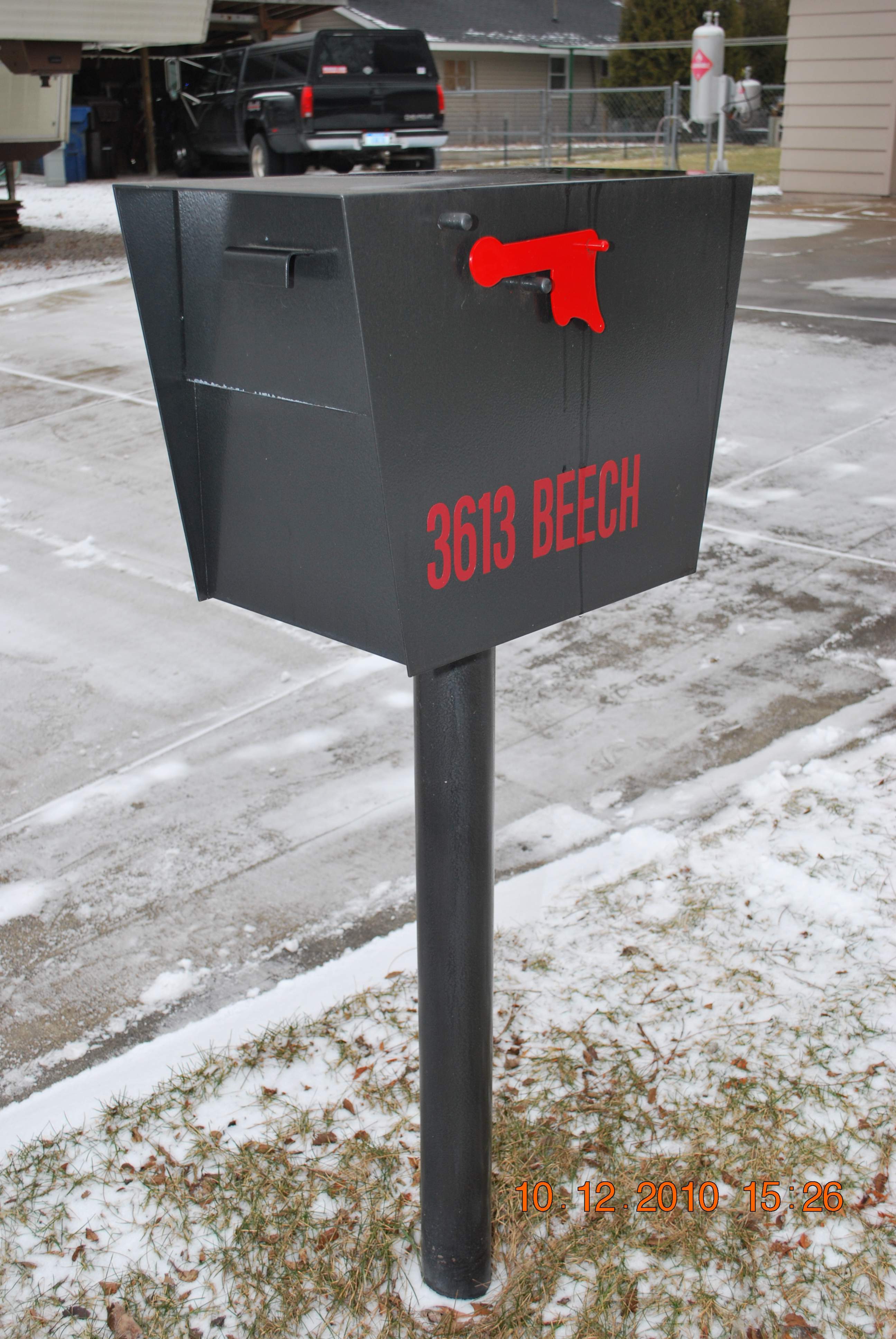

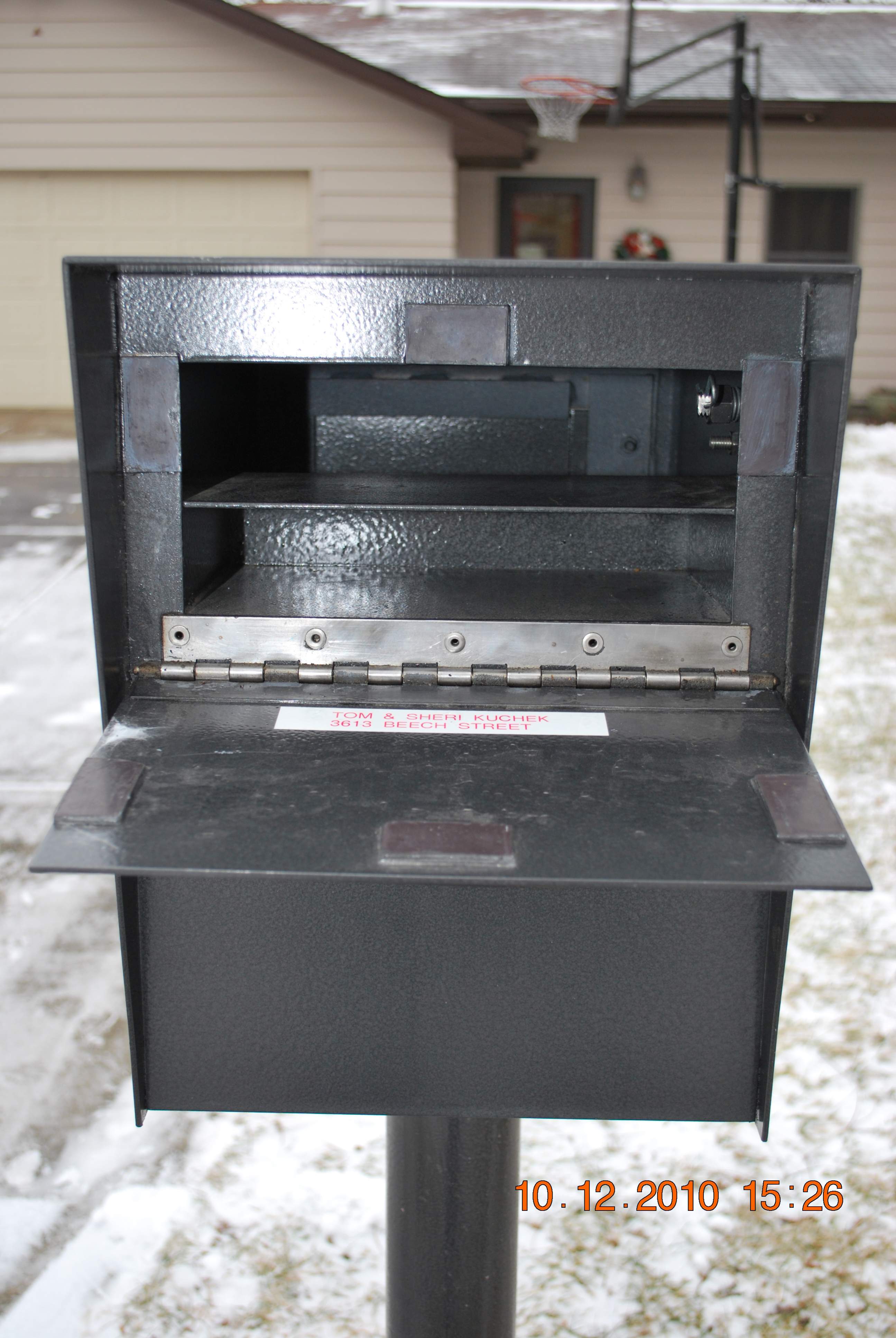

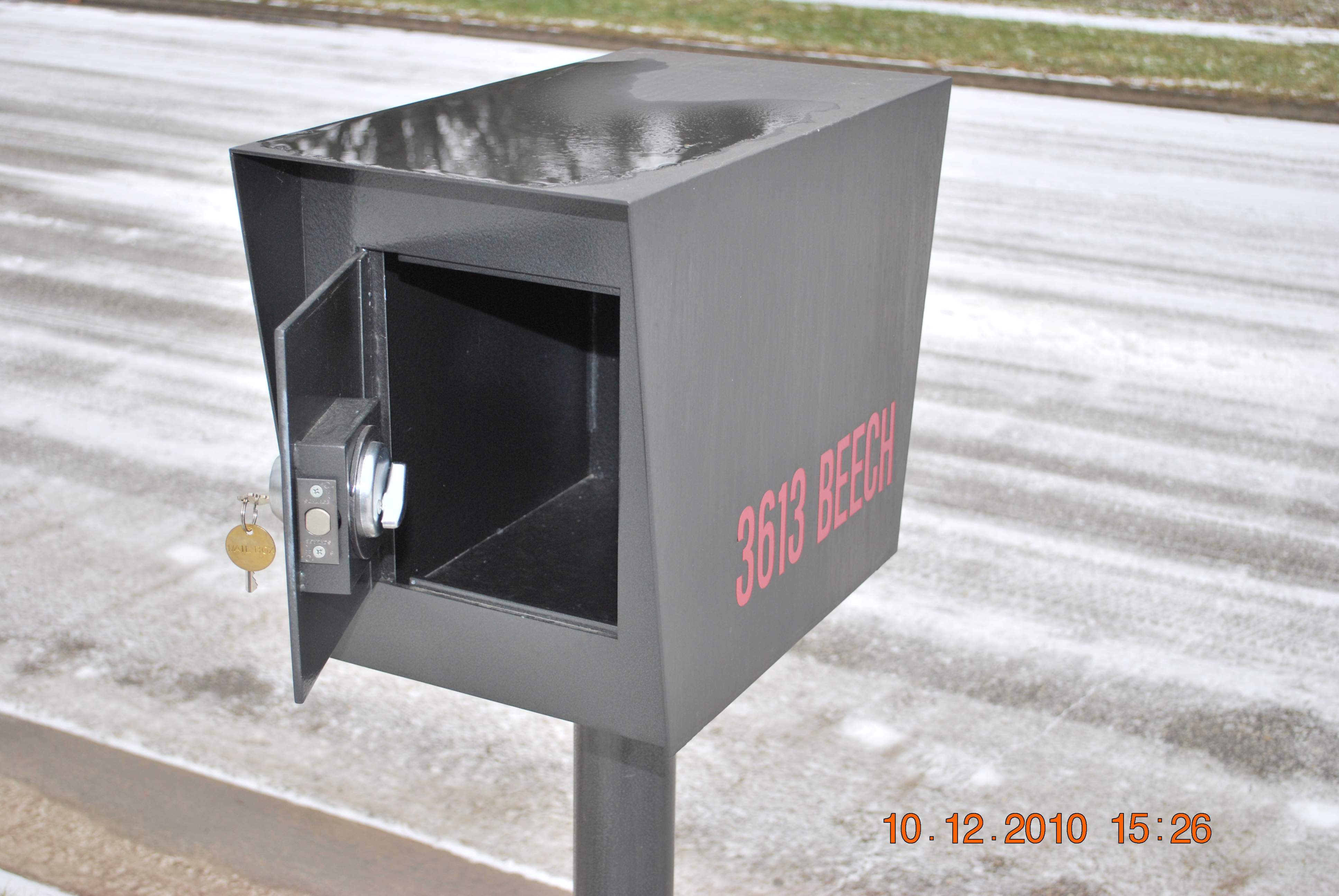

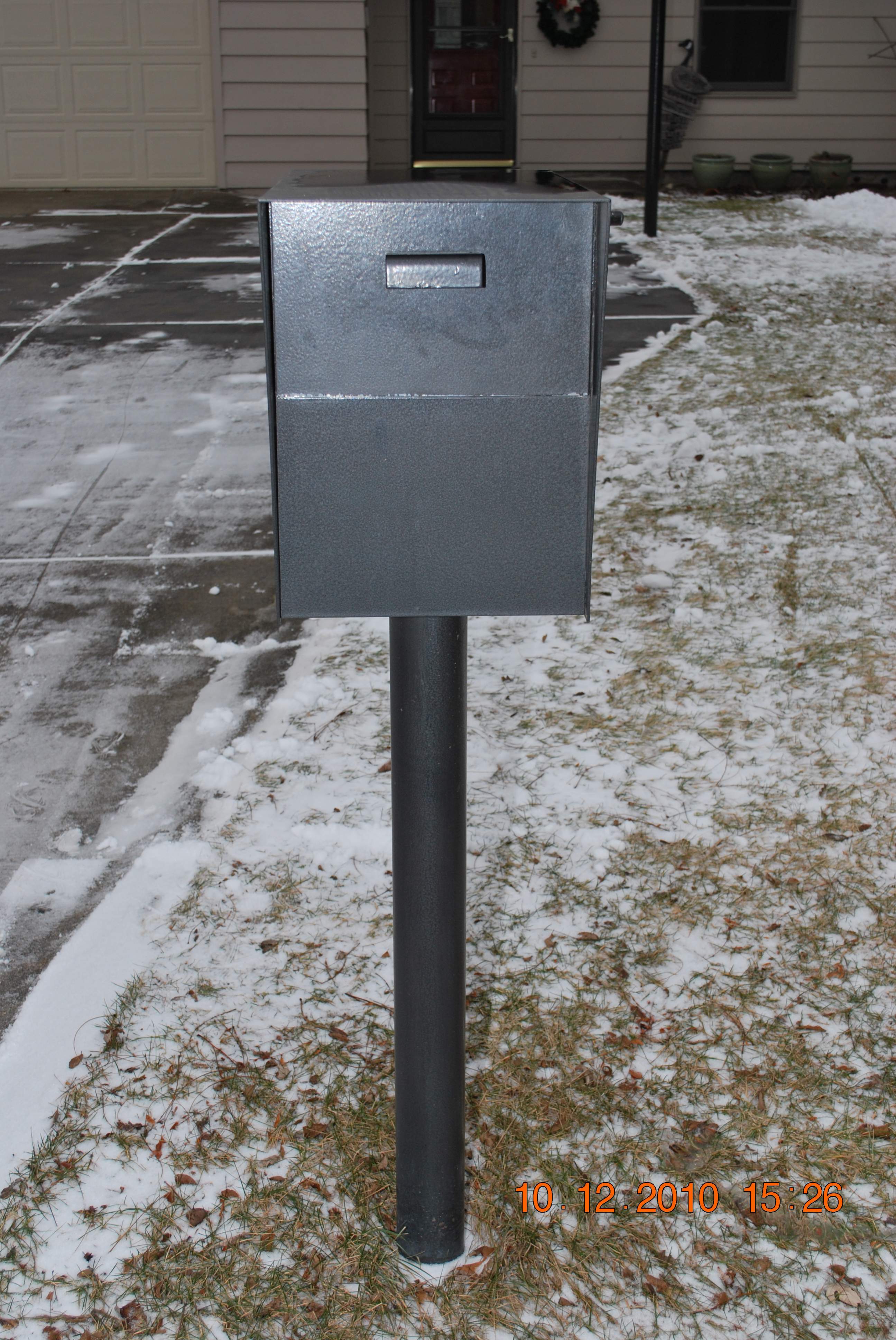

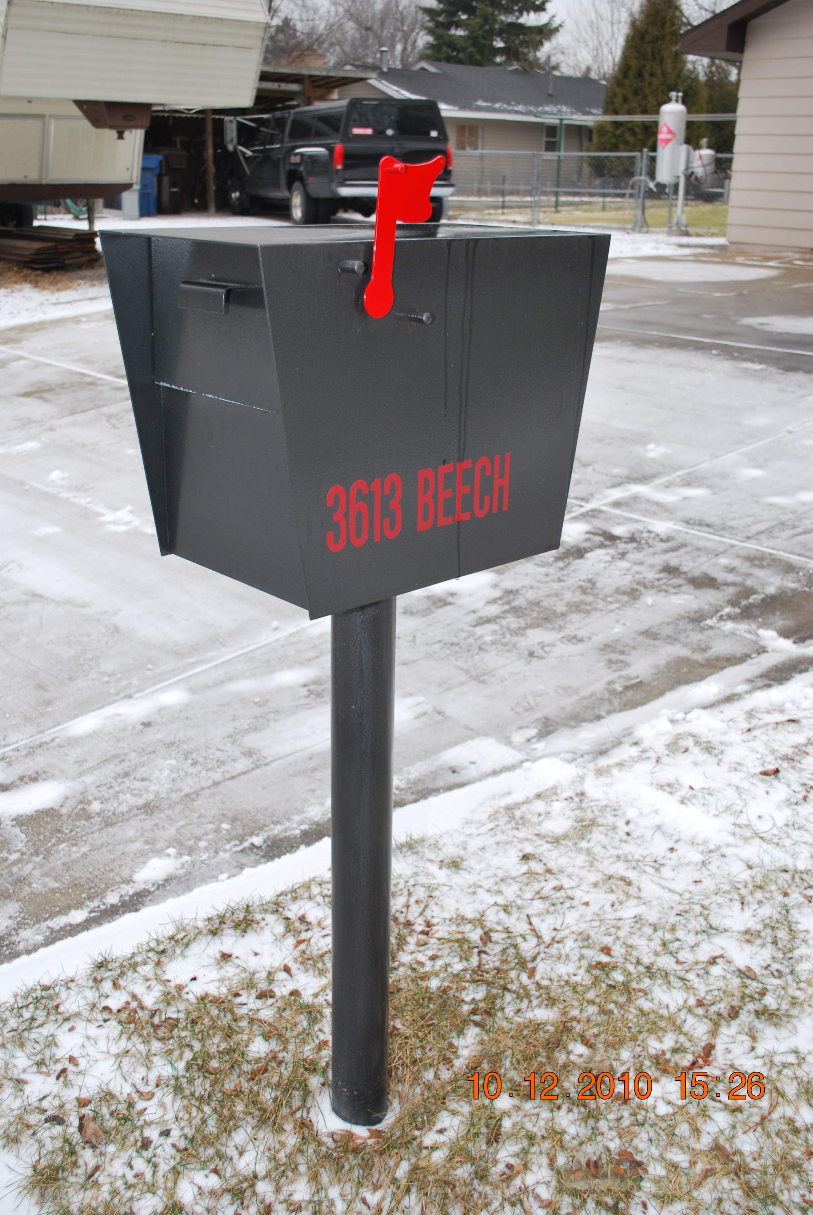

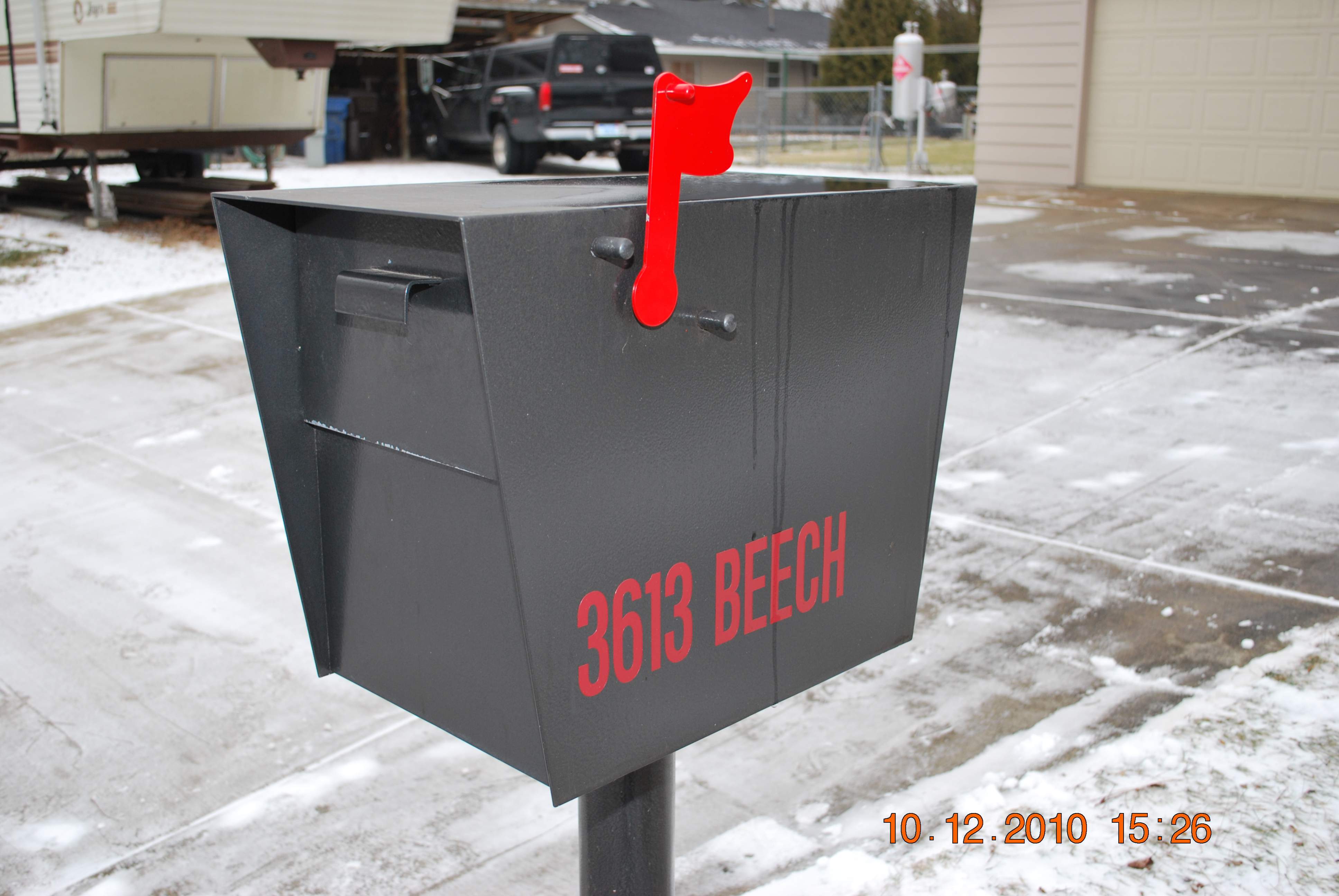

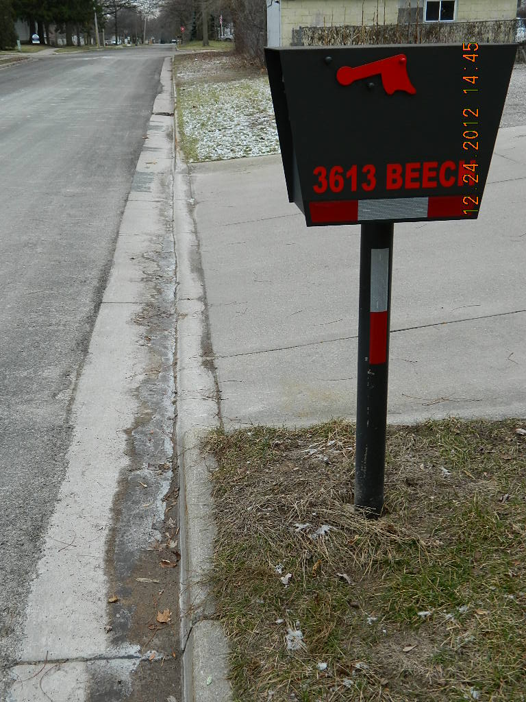

No bends.
1/8" and 1/4" stainless steel sheet.
Kwickset deadbolt lock keyed the same as my house door key
Magnetic pads to hold door shut.
Schedule 80 stainless 3" pipe cemented 5' deep in the ground.
Box is bolted to pipe mount plate inside with 3/8" allen socket cap screws inside.
S.S. hinges welded
Hammered paint finish
All pieces hand gut with Metabo grinder and cutoff wheel
Spring tension hold flag in any position.
Top front slot is for incoming mail
Bottom front slot is for outgoing mail with back so it cannot fall inside.
All welds are tig done with Miller AC/DCthunderbolt welder.
Father in-law back into the box not long ago with Chevy K3500 dooley and shattered his rear quarter panel.
Minor scuff to paint that i rubbed out by hand.
Reflective tape lettering.
Recently added some more DOT tape to post on both sides vertically.
I usually send no mail outbound but rather drop off at post office or use a USPS Blue drop box on way to work.

/ Mailbox Security The Homemade Way
Thanks guys
Local police came to my kids school and gave a discussion about on-line predators, Identity theft, mail security......
Mail is one of the easiest ways for people to gain information, signatures... and use this info. to aid in identity theft.
The police pointed out you should not put your outgoing mail in your mailbox.
Instead use a drop box or take it directly to the post office.
My brother in-law had been having a rash of mailbox vandals about the same time.
He had to replace his mailbox 5 times in a very short period.
Drive by vandals were going around smashing them.
He would come home to find his mail scattered on the road side.
We have medication for the family delivered thru a mail order service and it made sense to beef up the security.
If you go out of town or do alot of camping... it is nice that people don't see the mailbox full, an indication you are not home.
That could also lead to a break -in.

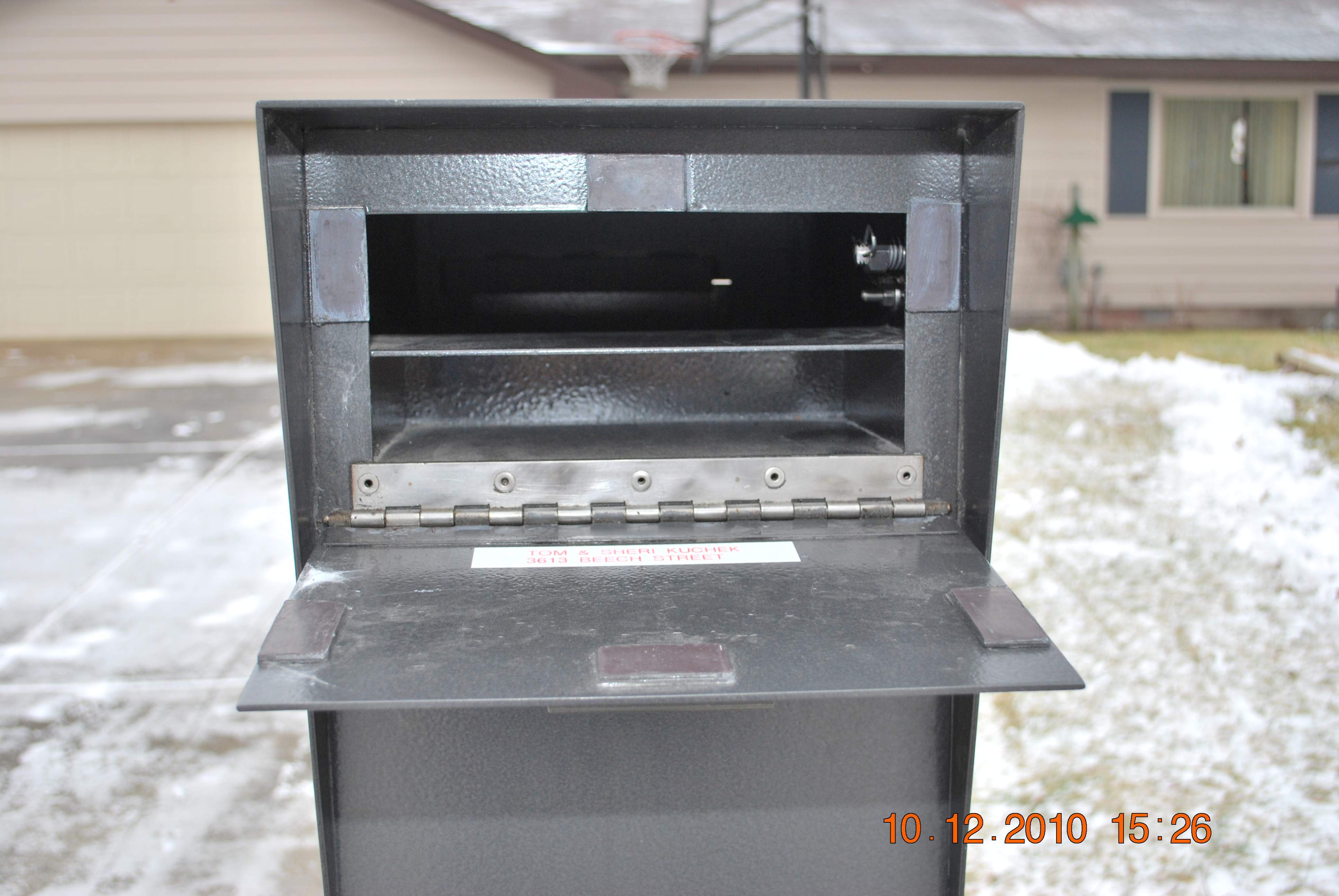

Not sure I understand how it works! If the post office delivery person can deliver your mail in the front, why do you need a lock in back?:confused:
#9
Nice job!
The mail falls into the bottom of the box and it is difficult to reach inside and pull the mail out.
The slot for incoming mail is small enough that it is hard to attempt to reach inside for the mail.
Pull your mail out from the lock door in the back.
If you have a ditch behind your box, make the box a little taller and the door with the lock would be located on the front.

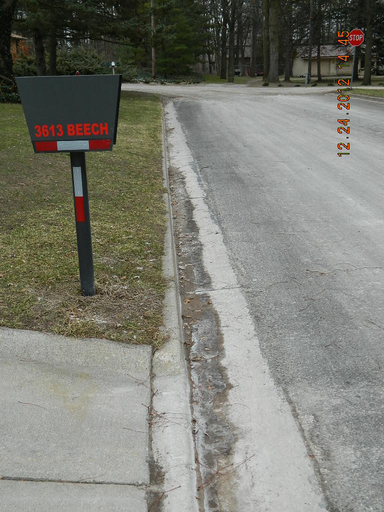

Make sure the post is stuck in the qround real well. I'm sure you thought about it but so have the young turks intent on getting that mailbox.
/ Mailbox Security The Homemade Way #16
I realy like your design and workmanship. The only problem I see is that it apears to be on the easment of the road. If it is not on your property and someone hits it and gets injured you are probably going to be liable. This happened to my best friends dad. Check with your county or the post office and see what the regulations are. In our area the post can be be no larger than 4"x4" wood or 2"x2"x1/8 steel. The same size as a post for a stop sign, so that if some one hits it it will bend over or snap off.I would hate to see some one get hurt bad and you get in deep trouble over a mail box.
Bill
/ Mailbox Security The Homemade Way #17
I agree. If it's a home made box that is heavy and goes through a windshield when someone hits it, you will need a lawyer that is tougher than your mailbox. just saying
#18

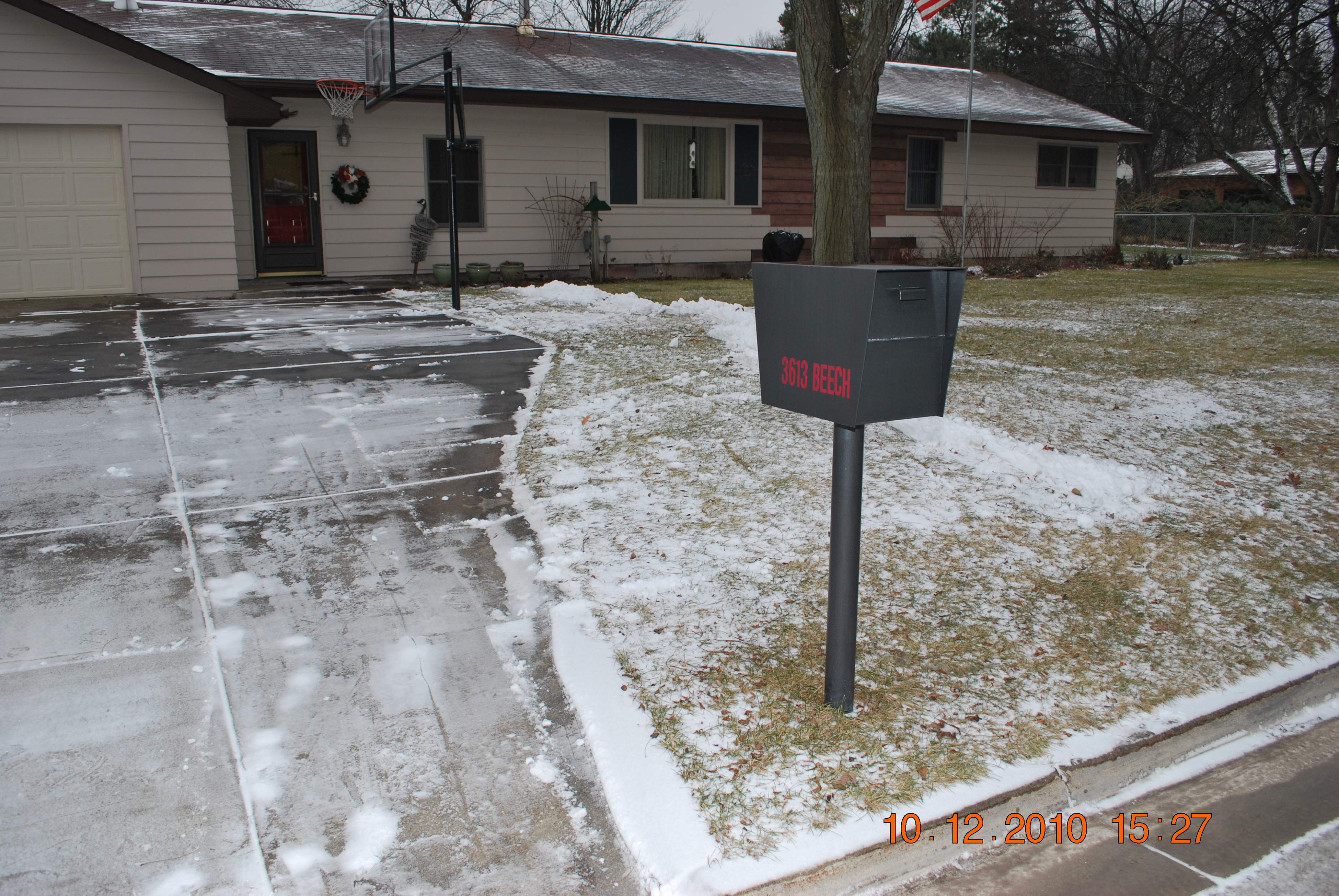

the pipe is 3" sched. 80 with tabs welded to the pipe on the lower portion to grab the poured concrete and not sperate.
It is aslo stainless steel so it will not rust over the years.
The front of the box is set back legal distance inside the curb egde so the postman, street sweeper, garbage and recycling truck will not hit it.
I am on a slow residential road on a corner. Traffic only has about 90 - 100' feet to accelerate before reaching the mailbox as they drive past it.
If they hit it I hope they have their seatbelt on Michigan law so they don't go thru their window.
We have Mailboxes in subdivisions of our town that are made of 2' x 2' concrete bases mortar and brick 4' high that would stop a UPS truck going 55mph and hauling Chris Cristie's entire family.I'm not joking.
It's in there now and thats where it is going to stay.
Like I said earlier, my father in-law back out of the driveway with his 1 ton dooley and removed the entire composite box side off his Chevy truck.:confused3:
I have alot more DOT reflective tape on it now.

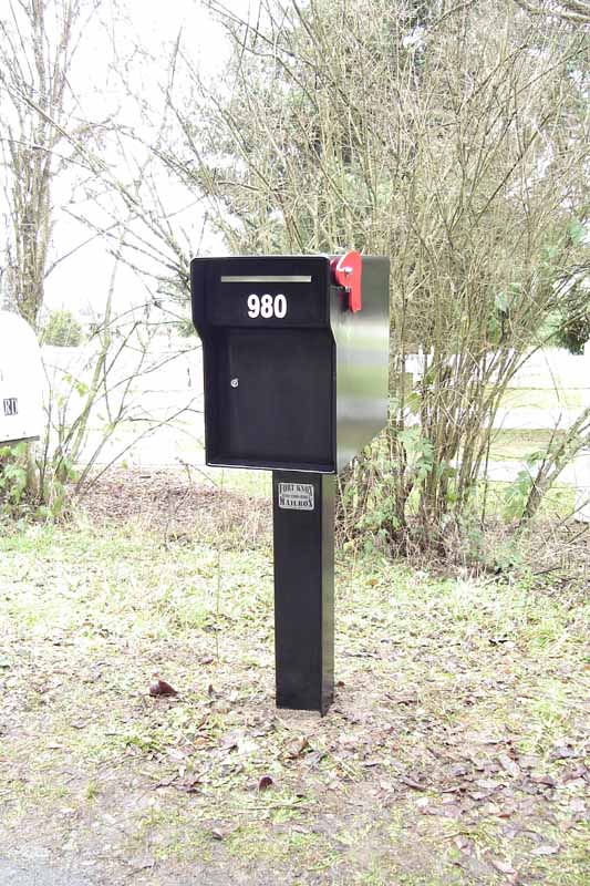

Hereis a few other large mailboxes
mailbox 2.jpgmailbox 3.jpgmailbox 4.jpgmailbox 5.jpgmailbox 6.jpgmailbox 7.jpgmailbox 8.jpgmailbox 9.jpgmailbox 10.jpgmailbox 11.jpgmailbox 13.jpgmailbox 14.jpgmailbox 15.jpgmailbox 16.jpgmailbox 17.jpgmailbox 18.jpgmailboxes 1.jpg
