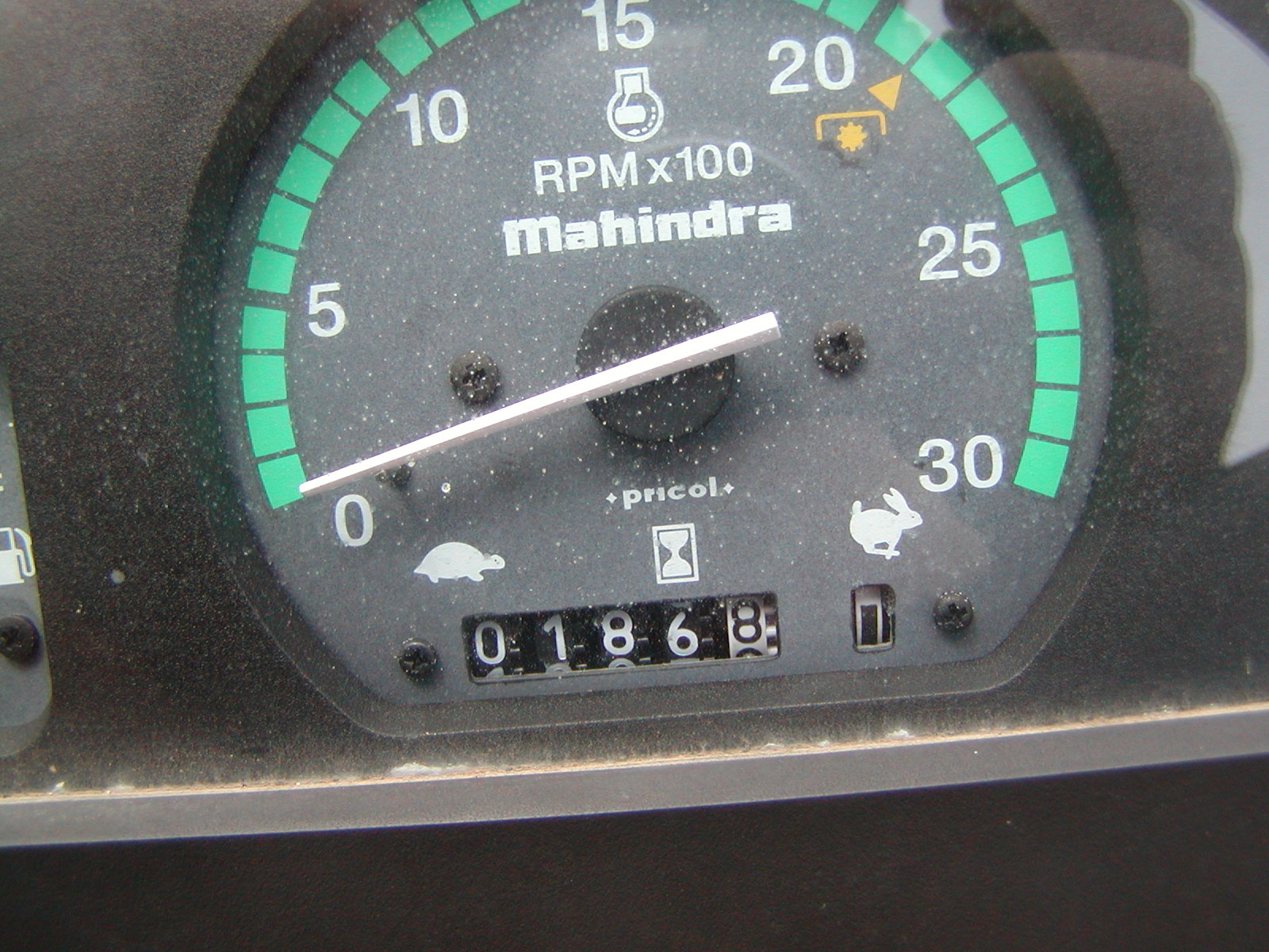

Here are a few pics taken this morning. ( I hope I am attaching them, my computer skills are somewhat lacking.)

Look at the picture I posted today. It shows the starter location, and the solenoid I had to replace. A small tree snapped back and came up inside the arm of the bucket and snapped it off.
I have only dealt with the dealer, but will try the website Ishvl73 suggested and see what help they can give. I did not contact the dealer when it started knocking, thinking it was only injectors, and I did not have the money to have them fix it then. Still don't!
I was wonderin' about that as it looked OK to me in the pic. I don't think the 4500 engine has changed in a bunch of years....I may be wrong, but its design is 3 of the 4 cyls of the 6000 model. I don't believe I've ever heard of a rod trying to switch cyls.....As I mentioned in my post in the Mahindra forum, I hope you can get it fixed...did you buy it new or used...?? PS: The Mahindra 4 WD 00 series units has an 8X8 shuttle which is (to me anyway) every bit as easy to use as a hydro.. Good luck...BobG in VA

I took the pictures to my dealer today and he is going to e-mail them to the Mahindra field rep and see what they will do.
