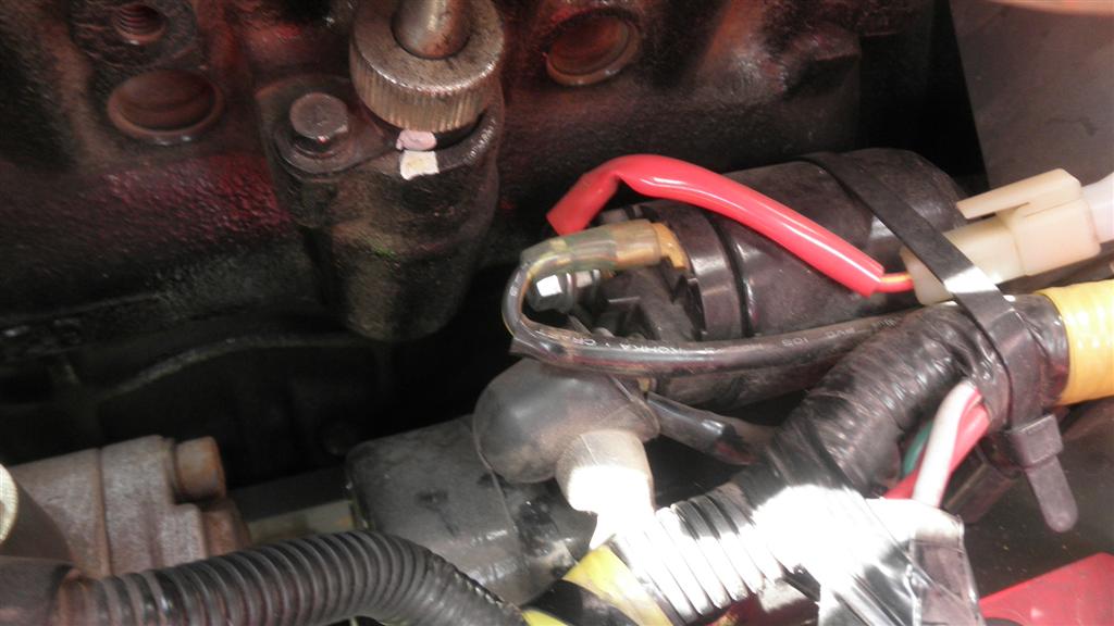

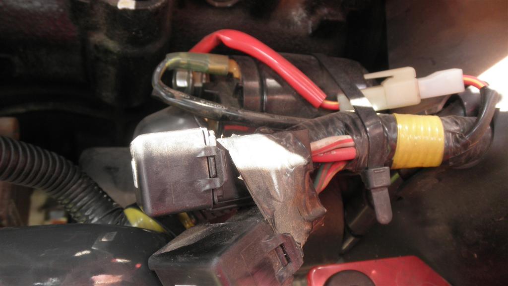

ok long story short starter has 5 wires going to it i know the main 3 but i dunno where the other 2 go.
long story;
so my dad is 60 and he wanted a tractor so he went and bought a mahindra2615 hst. he lets it sit for months at a time, and has to jump it off a lot. the last time it wouldnt start up, "im and automotive mechanic" i told him to go buy a battery and change it out, the original was 5years old been dead atleast 6 times, time for a new battery. so ignores me, pulls the starter off the tractor and has it tested, they tell him to go buy a new battery too. so he gets the battery now and doesnt know how to re wire the starter so he calls me, any car has 3 wires coming off the starter solenoid
one to the starter motor
one from the battery
one from the inition switch via starter relay
what are the other 2 for he said they were connected but doesnt remember witch terminals they were on.

if someone could just take a picture of there starter solenoid that would be awesome. our mahindra dealer shut down so theres none i can go look at thanks guys.

Sorry just went out and looked but my 3016 only has 3 wires. Going to go out on a limb though and say you have your activation wire, starter wire, and power wire. Those three should be easy enough to identify and unless you have a ground wire from the block the other two should go to battery terminal. Because I can't think of why you would want power only when your starter is engaged.
/ Mahindra starter wiring [helP]!!
thats what i was thinking too. i know one of them goes to the power terminal, i looked again and it powers the ignition, the other turns on a solenoid on the other side of the block (connected to the injector block) when its connected to power so im just not sure about that one. i just dont wanna burn anything up.
/ Mahindra starter wiring [helP]!! #7
Sorry, but I don't see 5 wires.

I not sure if this will help or not, the circuit diagram I have for my 2815 only shows 4 wires to starter, not sure why they would have 5 wires.Unless it was for a add on device and they just got power from the starter location.
/ Mahindra starter wiring [helP]!! #16
That fifth wire may be to "Pull" the fuel solenoid on. Try hooking it to the starter activation post see if it starts and stays running when you let off on the key.
