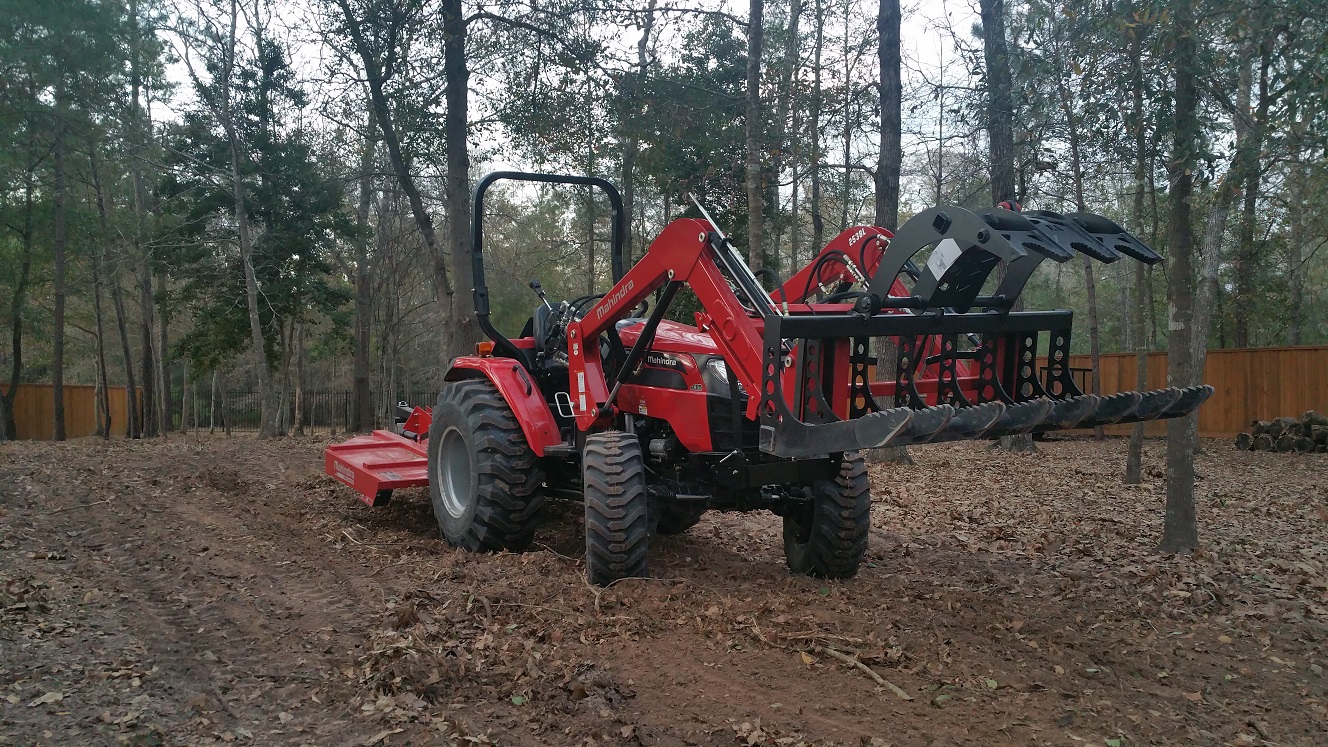

Yup - As noted above, Mahindra Implements = Kodiak. Not bad units at all for lower priced implements. I have a 6' Medium Duty cutter and it is a beast. 2"+ saplings and firewood size debris from logging cleanup with no problems. I should have got the thicker gauge HD, but I never would have guessed I would be able to hit such big material. The floating top bracket that Sysop mentioned is great, as well as clevis pins, slip clutch, extra bracing on deck and high HP gearbox. These are the differences from SD. Mine being a MD has some battle scars where logs and saplings have dented and dinged the deck and sides in a few places, but that is my fault for not getting the heavier gauge deck. It cuts grass and weeds like butter. Check out these great vids.
/ Mahindra rotary cutter #9
The videos above point out the features that pushed me to stay with the Mahindra branded Kodiak stuff. (Fully welded decks, single pieces of deck, smooth underbelly, strong tail wheels, etc...)
Good luck!
