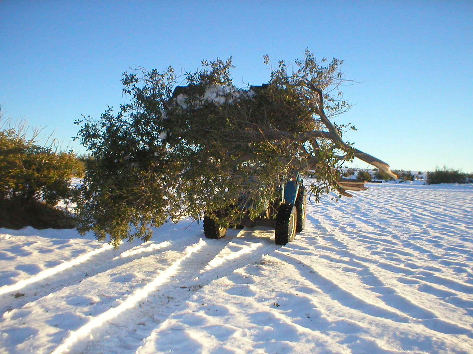

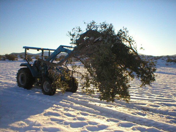

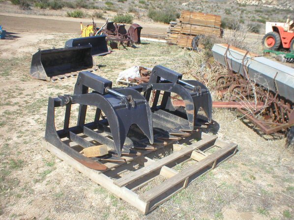

I'm sure that the Mahindra grapple will be fine. Very similar to the grapple that I use on my Mahindra 7520. You may want to shop price though. There are a lot of different ones to choose from. Shouldn't be more than $2000 in my opinion.
Good luck with all the new equipment. :thumbsup:

This is a fair price installed if it is a true 3rd function. If it is a diverter system, then it seems a bit high to me. Any chance that you would want to save about $500 and do this yourself? If you look at the Mahindra grapple, the lower tines are notched, why I'm not sure. This would concern me, but it probably would be fine. You need to be careful about what attachments and implements you get. Your tractor is heavier than most of that HP size and it is easy to destroy things without being very carful.

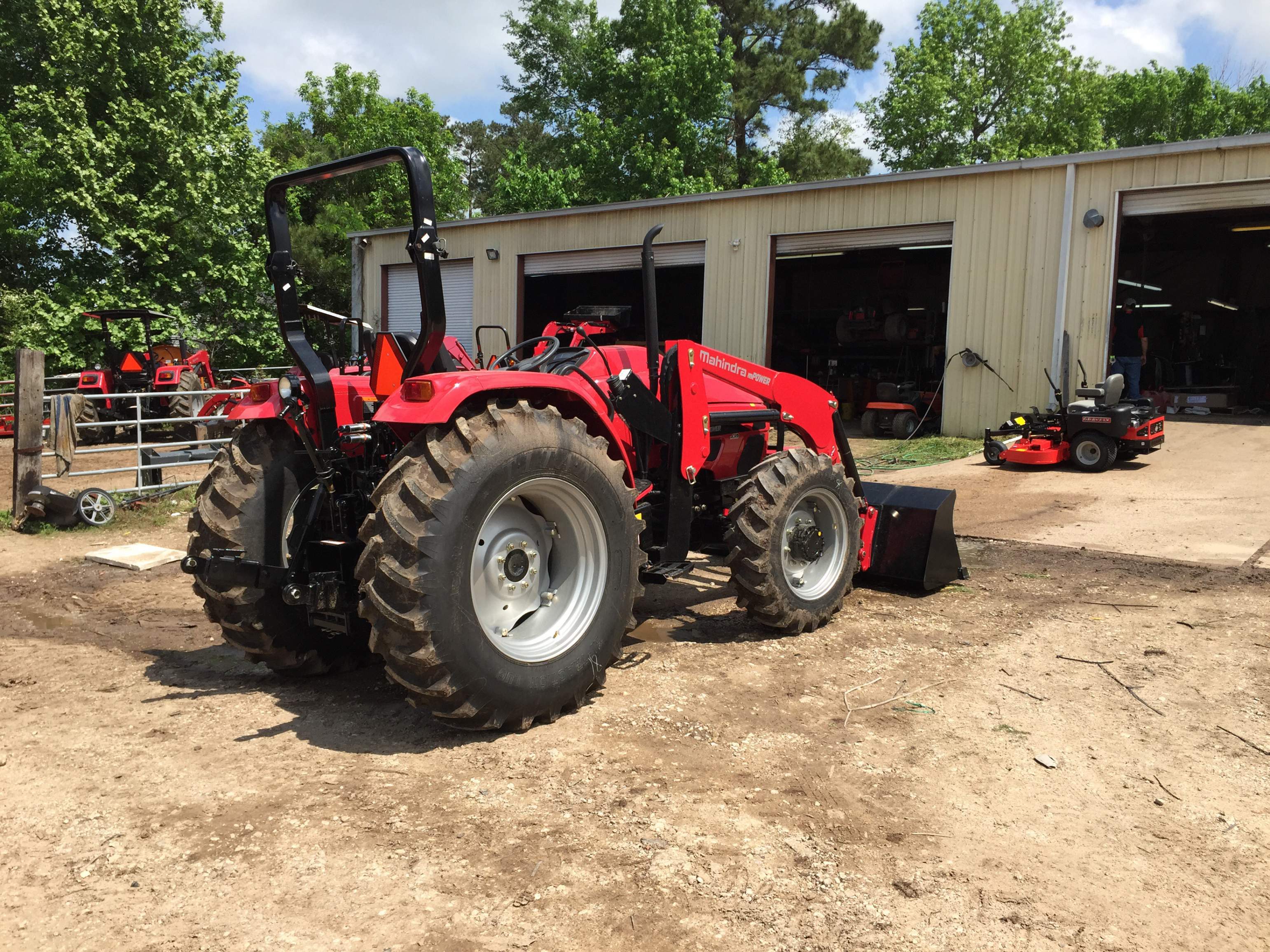

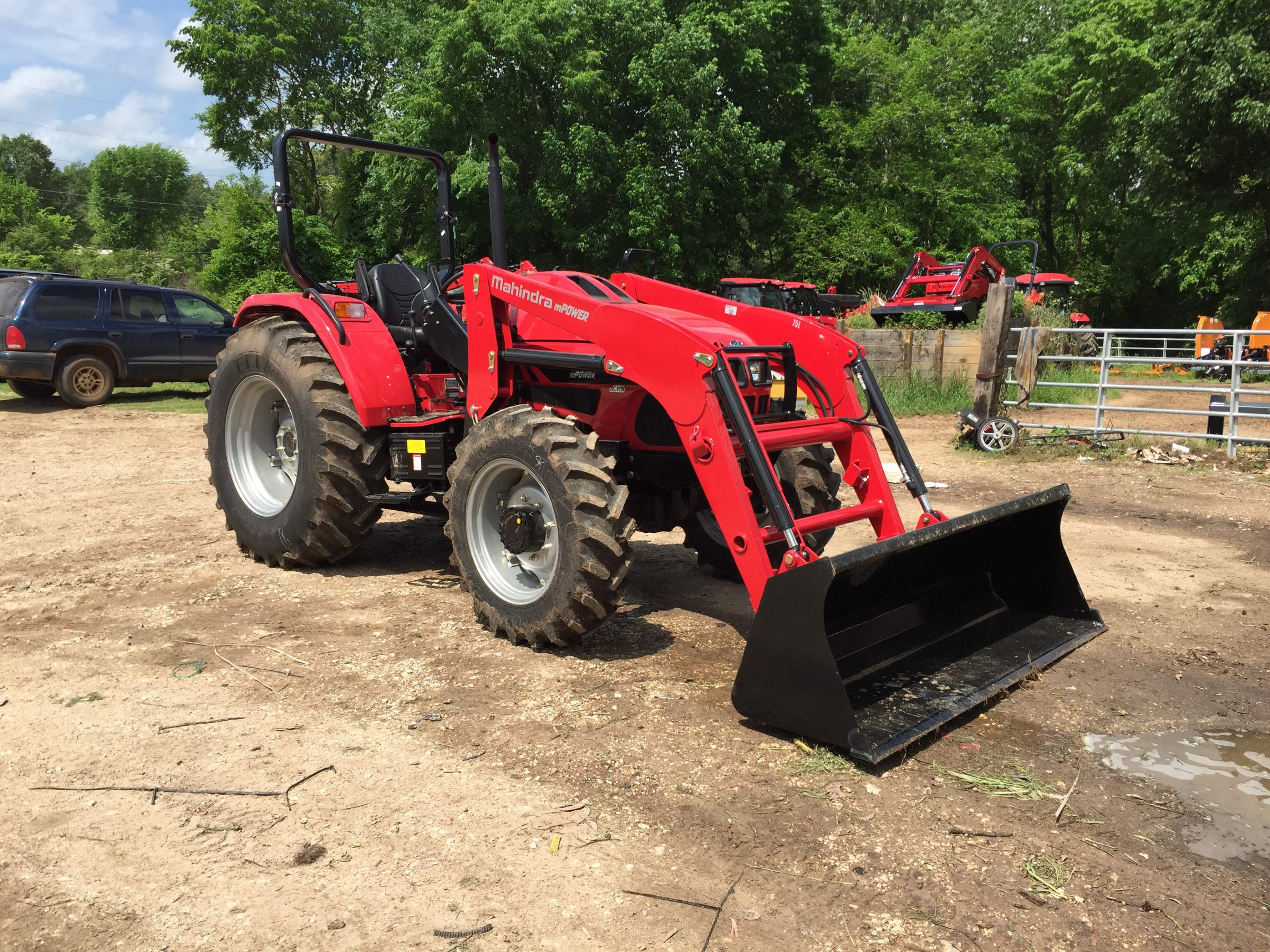

Here's a couple of pictures of the tractor. Hope this works.
/ Mahindra root grapple #14
<img src="http://www.tractorbynet.com/forums/files/attachments/421636-mahindra-root-grapple-image-jpg"/><img src="http://www.tractorbynet.com/forums/files/attachments/421635-mahindra-root-grapple-image-jpg"/>
It sure did work and that is a very, very nice looking tractor. Congrats!

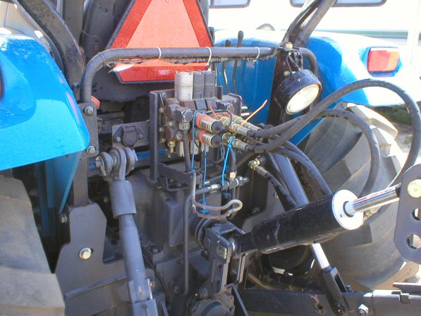

Diverters work fine, (actually better IMO) actuation control is in a button on your loader joystick and as Brandi mentioned, you use the curl function to operate the grapple.
My diverter valve is the gold colored unit at the top of the loader tower. You can also see the control grip on the loader joystick. Your hand never needs to leave the grip to control all functions on the loader. ;)
