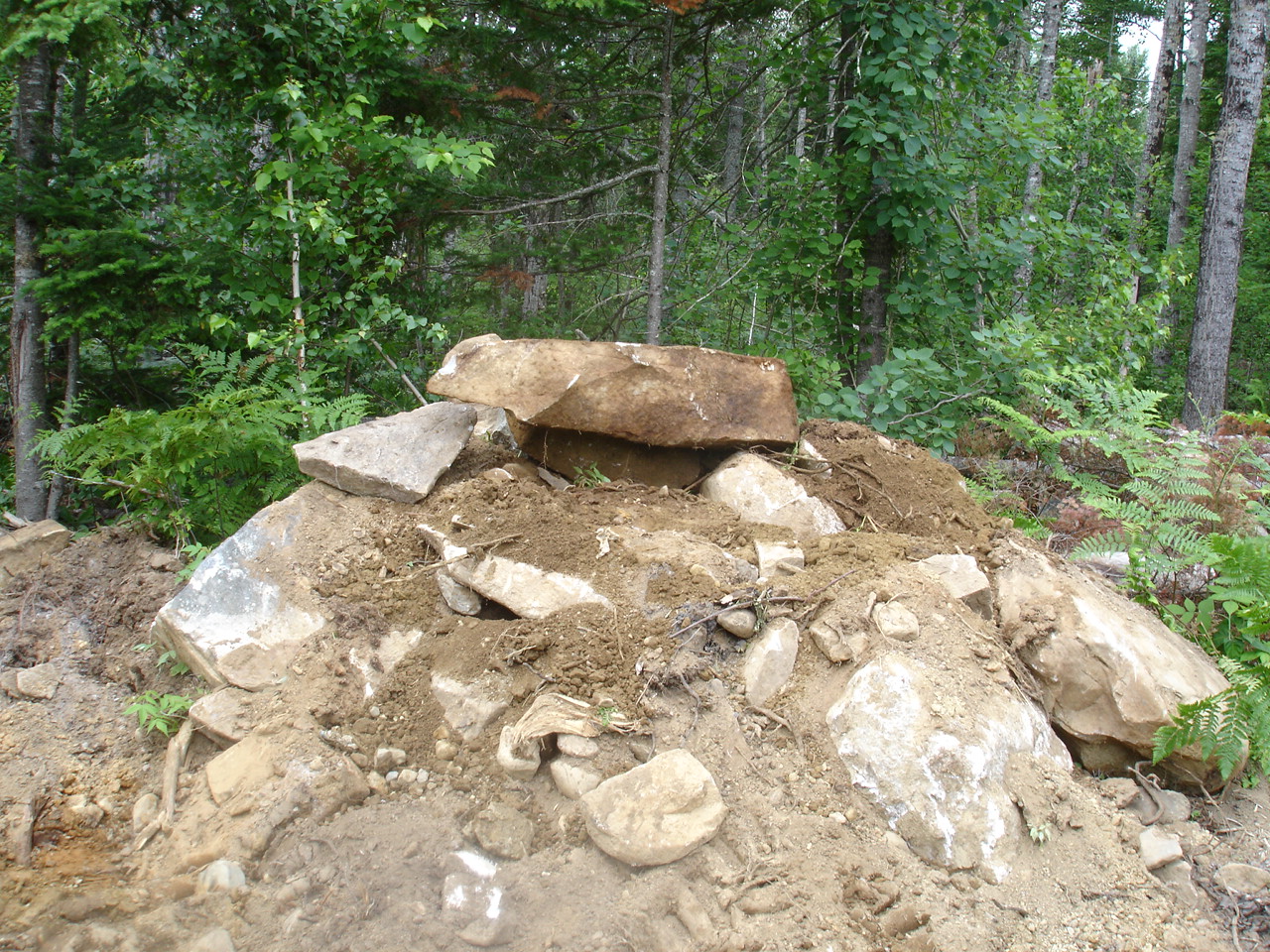

I've got a KMW M112e that I'm real happy with. I use it to load sand in my truck-mounted spreader in the winter and pull/load rocks in summer. Like knute_m, my top rail bent a little, but it digs and pulls rocks so big it brings the rear end off the ground. I haven't found anything it won't lift, yet. I was using a 55 gal barrel loaded with sand for a counter-weight, but had to take it off for the scraper. Here a couple of pictures of the rock pile so far and a rock it carried. Just after I took that picture, I got back on the tractor and it had lifted the rear end enough I couldn't get traction. Had to go to 4wd.
