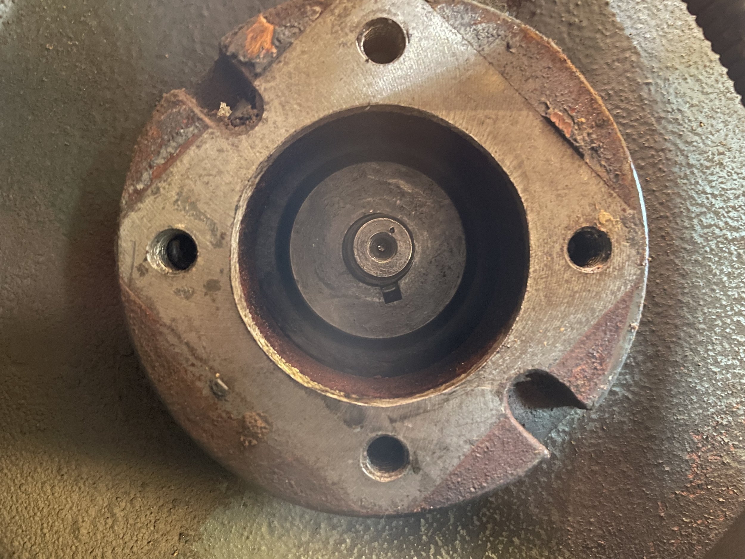

Hello! Thanks for the reply. There is this oil inlet plate that I can remove to expose the nut on the pump. Just not sure if that is enough room to get the gear off

U don’t take the gear OUT..
As a safety precaution, degrease the face of the gear and run a magic marker to the other gear or somewhere YOU KNOW how the gear goes incase it falls out of place..
Other manufacturers put NUMBERS on the gears
U SPLIT THE 33 with the 3 on the other gear..and that’s about it..
Pay attention to the mounting ear on the pump.. it should have a timing line on it to match up with some others..

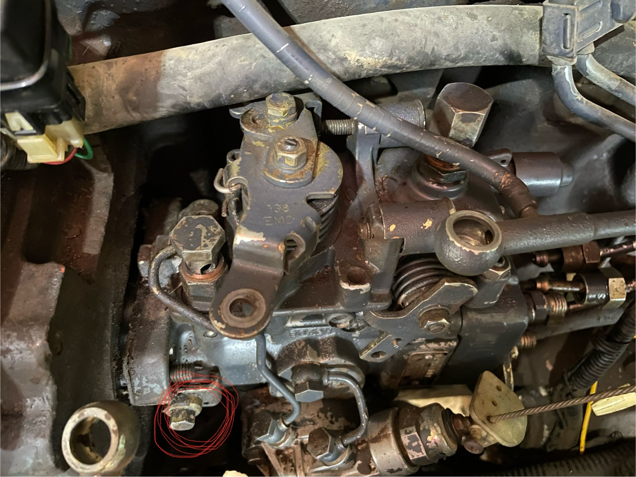

It’s very possible that the shaft IS NOT KEYED..
Whatcha gotta do it find TDC and lock the pump drive shaft..
U see that 10mm headed screw with the washer under it.??
Once u find TDC, loosen the 10mm screw and remove the washer..
tie the washer to the pump and tighten the screw against the drive shaft..so it won’t turn.

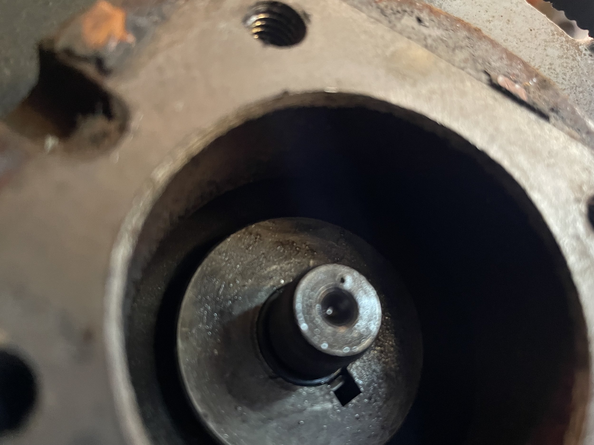

Would that be this one I have circled? The original post of this thread said the tdc hole was behind the starter but I have yet to find it. Can you explain what you mean by tie the washer to the pump? Basically so it doesn’t get lost?
I included shots of the shaft as well. Thanks for your help in this.

So…I found out I had to pull the starter to expose the tdc pin hole, which I did. I positioned the engine into tdc and pinned it. I removed the “U” washer from the 10mm bolt and tightened it down to lock the shift of the pump (I am assuming). But it still will not move beyond what it has been.

Have you popped off the gear on the front of the pump/engine.??
/ Mahindra 7010 Injection pump issues #17
I have not. I can’t get to it from the front through that smaller hole that gets me access to the nut on the shaft of the pump. I have a few pictures of that in a previous post
