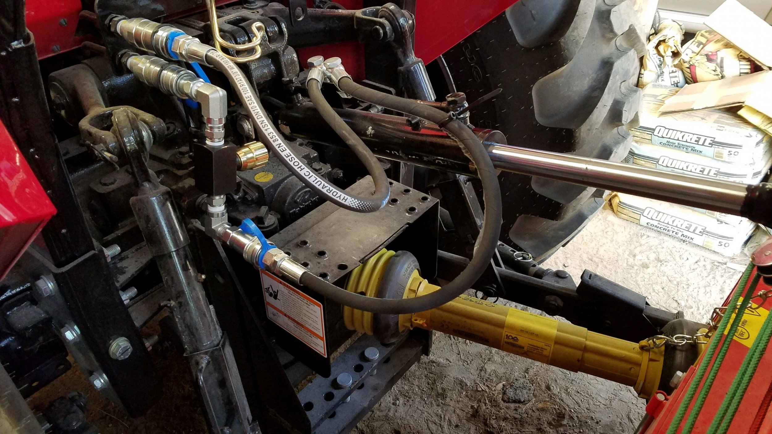

Here's my setup for a logging winch on the back. Top link with hoses from Amazon. Measured the OEM top link and came as close as I could with the hyd one. Also put in a control valve (gold knob) to slow down the movement. Seems you would need another set of remotes to also have a hyd side movement or a "switch" to change from one ram to the other.
Hydraulic Top Link Cat. 1-1 with Locking Block 20 7/8” - 31 7/8” with 2 x Hose.
Hydraulic Top Link Cat. 1-1 with Locking Block 20 7/8” - 31 7/8” with 2 x Hose.View attachment 761309
Do you mind posting a link to the gold control valve?
