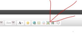

I have a picture of it, but cannot figure out how to add it on here. It is coming out at the very bottom of the joint.

I do but I can't figure out how to upload it.
   / Mahindra 3510 leaking at front steering joint #8
