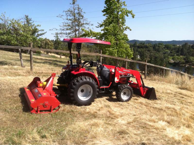

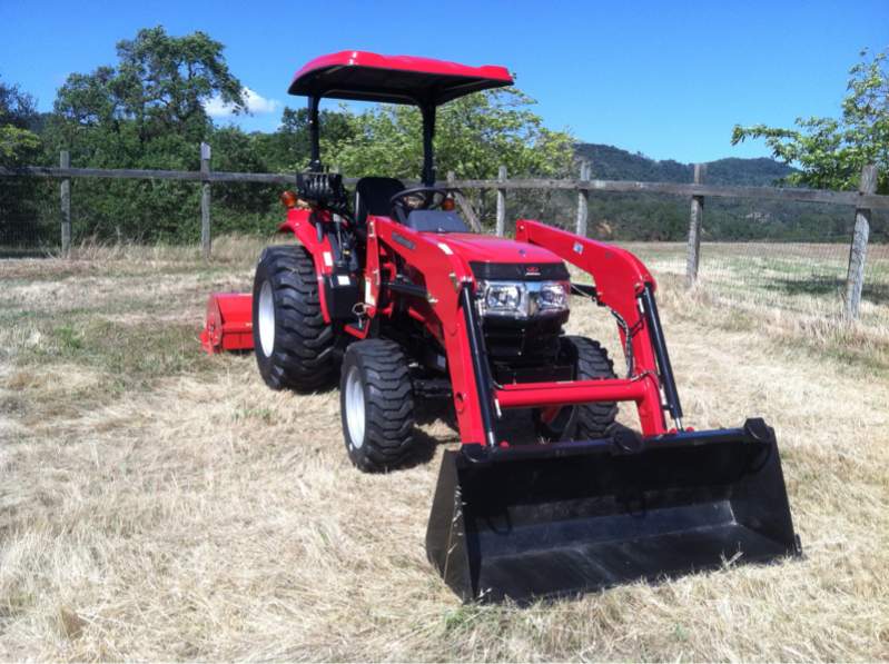

MtnViewRanch. Yep I'll get some pictures posted of my new equipment. I've got a couple pics here following my first two hours ever on a tractor. I thought I'd start with something simple like flail mowing the inside of an unused horse paddock. the grasses were about five feet tall and my first impression of the whole operation was how simple it was.
I don't have pix of the backhoe yet but I'll post those later. I'm really impressed with the layout and simplicity of the backhoe. My first time I was able to un-mount the BH from the tractor in a few minutes. Couldn't be easier. I'm very happy with the decision to buy the BH.

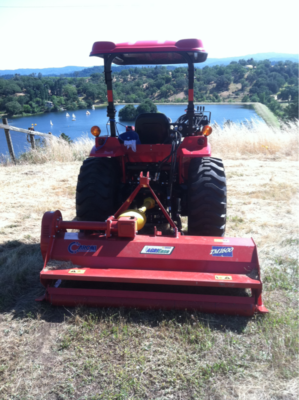

Looks like this thread has turned into a conversation about loading tires. I'll bring it slightly back to my Mahindra 3016 with 28 hp. If I load those tires and add how ever many pounds of extra weight will the tractor have a problem getting all that weight up a 30 percent slope while mowing five foot tall grass with a five foot flail mower? I'm attaching a photo of my hillside. After 10 hours of mowing I've learned that it goes downhill great and uphill in reverse real nice in low range 4WD in 2nd gear. Although the extra weight will be good for grip I'm now worried about enough hp to go up in reverse with the added weight.

I believe that you will be fine with loaded tires. It's not like you will be mowing in high range.
Just my :2cents:
