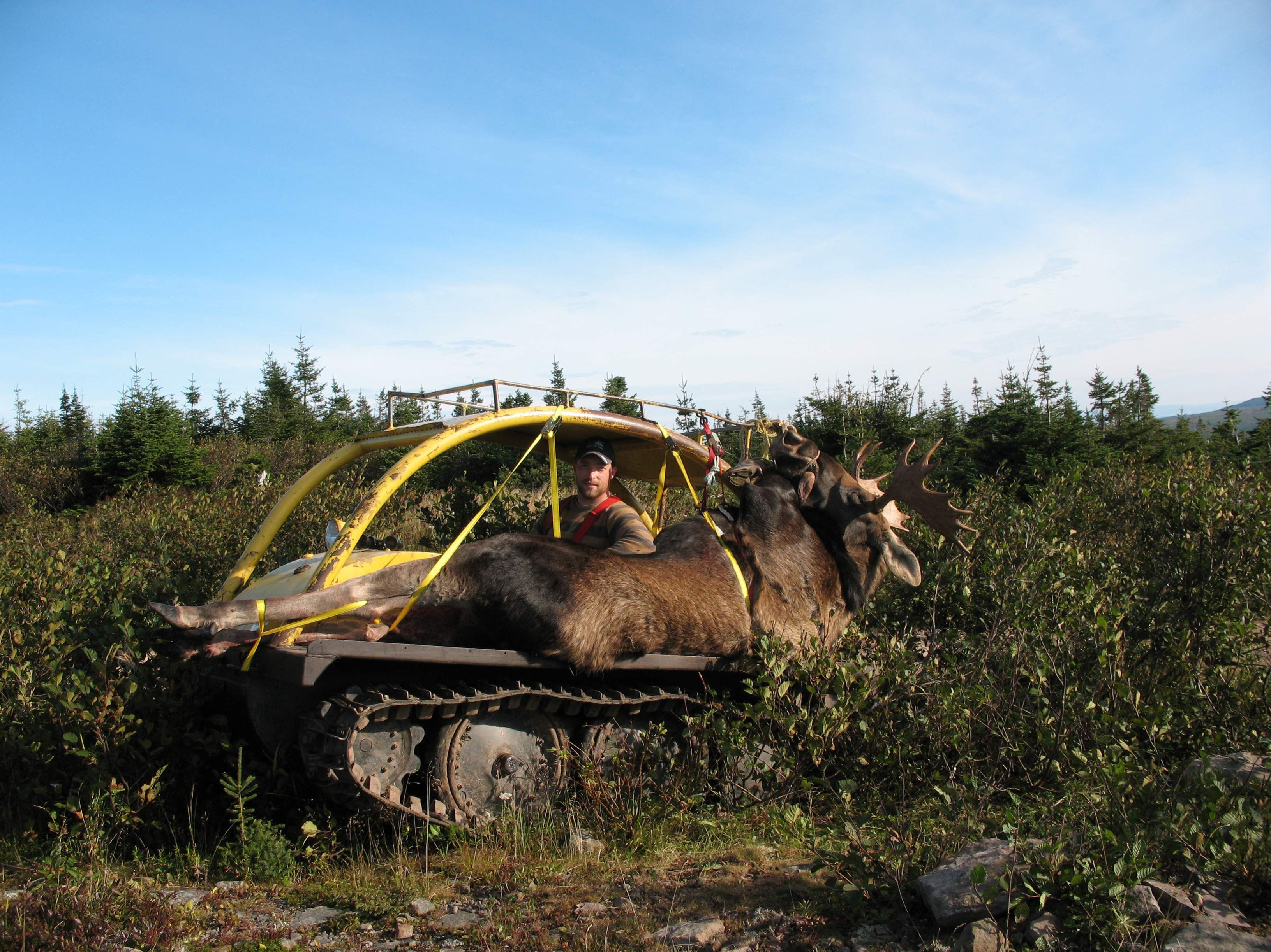

Vroom, Is that track machine in the picture a timberjack?

I don't care what the tracked machine is I want one when I grow up!!
Tom
/ Mahindra 2816 #6
That is a J5 bombardier. The smaller brother to the Muskeg bombardier. It has the same engine though. 115 hp chrysler dodge 251. They had them in the power wagon I believe. Its geared low, in fact...we hardly ever use first gear. we have 4 speed and 3 speed gear box. two steering levers with break bands bathed in oil. Some kind of limited slip axial differential. Cannot stop one side, only slow it. Which is the best way to go. It seems nice to be about to ski steer equipment, but for off road use you don't want people to be able to do that..it takes tracks off, bearings etc....this machine with new bands will still turn a little larger then an 4x4 tav. It will manoeuvre in trees as good or better. Its all metal, we have 1/4 plate on the bottom added on. Steering bands last dozens of years. Engines are 35 plus , no issues.. Turns slow, long stroke. Quiet. The metal cleats wear through from tires and will break. We welded rebar and flat bar in worn ones to use again. We replace the wheel bearings often as we use them for game retrieval for tourist and don't want any trouble. They will run into a wall and stand up, if they can't climb it...they will stand up on their end and spin. I recently got an argo...but this is a plastic little chain driven buggy...its not in the same category and all. But its nice to ride 3 or 4 people around on flat marsh and bog. But when the going gets rough and there are much blow downs and rocks and stumps and brush, trees....we take the J5 to pic up the animal.IMG_0830.jpgIMG_1204.jpg

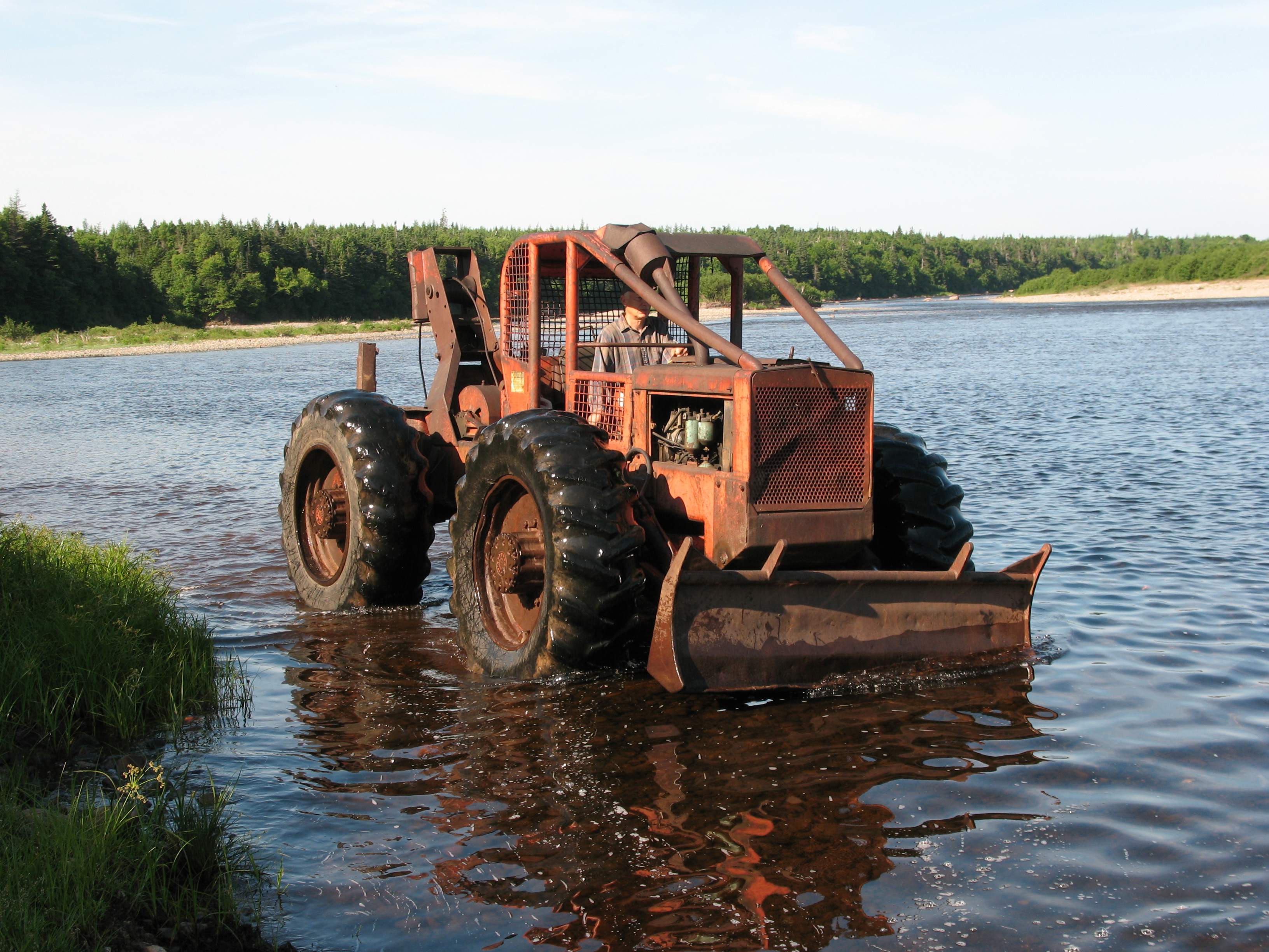

This pic above is of a Timberjack skidder. The other is of a tracked machine j5 bombardier. Same hp, the timberjack in this pic is a 230 detroit, 353 screaming jimmy. 2 stroke diesel.
The j5 uses a gasoline, 251 chrysler flathead 6 .
