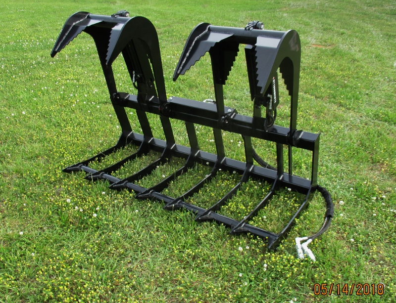

New to the group. I was having a hard time finding a thread where they talked about a Mahindra 2545. I would appreciate opinions on them. I was at a dealer today looking at a 2538. As I was talking to the salesman he said I have a 2545 that you can have for less. It was a loaner with 10 hrs on it...shuttle/loader/cab...$26,000. I have to pay cash. I'm thinking that's a lot of tractor for the money. More power...more flow...more breakout and heavier.
Decent dealer...30 miles away. Unless I'm missing something, this is a great deal?? I don't mind shifting at all. Is the clutch up to the task on these tractors? Are you happy with them? Am I correct in assuming that they don't offer a mid PTO and they have no rear remote. I want to run a grapple and a small round baler. Anything that you have to say will be appreciated.
