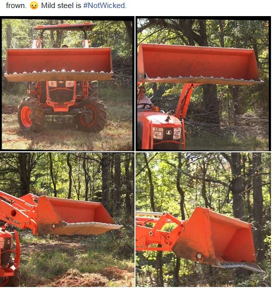

Then put a toothbar at the bottom to make it more rigid.
I agree a good toothbar like the pirahna will make your loader much better , i have a 2538 and the bucket is 66 inches
   / Mahindra 2538 loader bucket #12
Really! That can't be "massaged" back into place with a sledge hammer.... ;)
I would ask him to pay for the repair or a new one, family or not.
+1 on a metal fab/shop, any good place should be able to get it back in shape, but check pricing either way
   / Mahindra 2538 loader bucket #13
I think it could be straightened, and then add a Wicked Toothbar to make sure it doesn't happen again!
We know first hand that a piranha isn't up to much punishment..
Travis
   / Mahindra 2538 loader bucket #14
I have bent them far worse than that. Straighten it the best you can and get a 4" wide by 1/2" plate welded across it. I would have to go back in my pics to see the worst one I did :). Yours looks good.
   / Mahindra 2538 loader bucket #15
Travis
Really , my pirahna has been used pretty hard and itis still like new, Im sure your product is good but to trash someone elses whrn there are lots of people on here with pirahnas and love them is wrong
   / Mahindra 2538 loader bucket #16
Beat it out with a 13# sledgehammer and put at tooth bar on in it, call it done!
