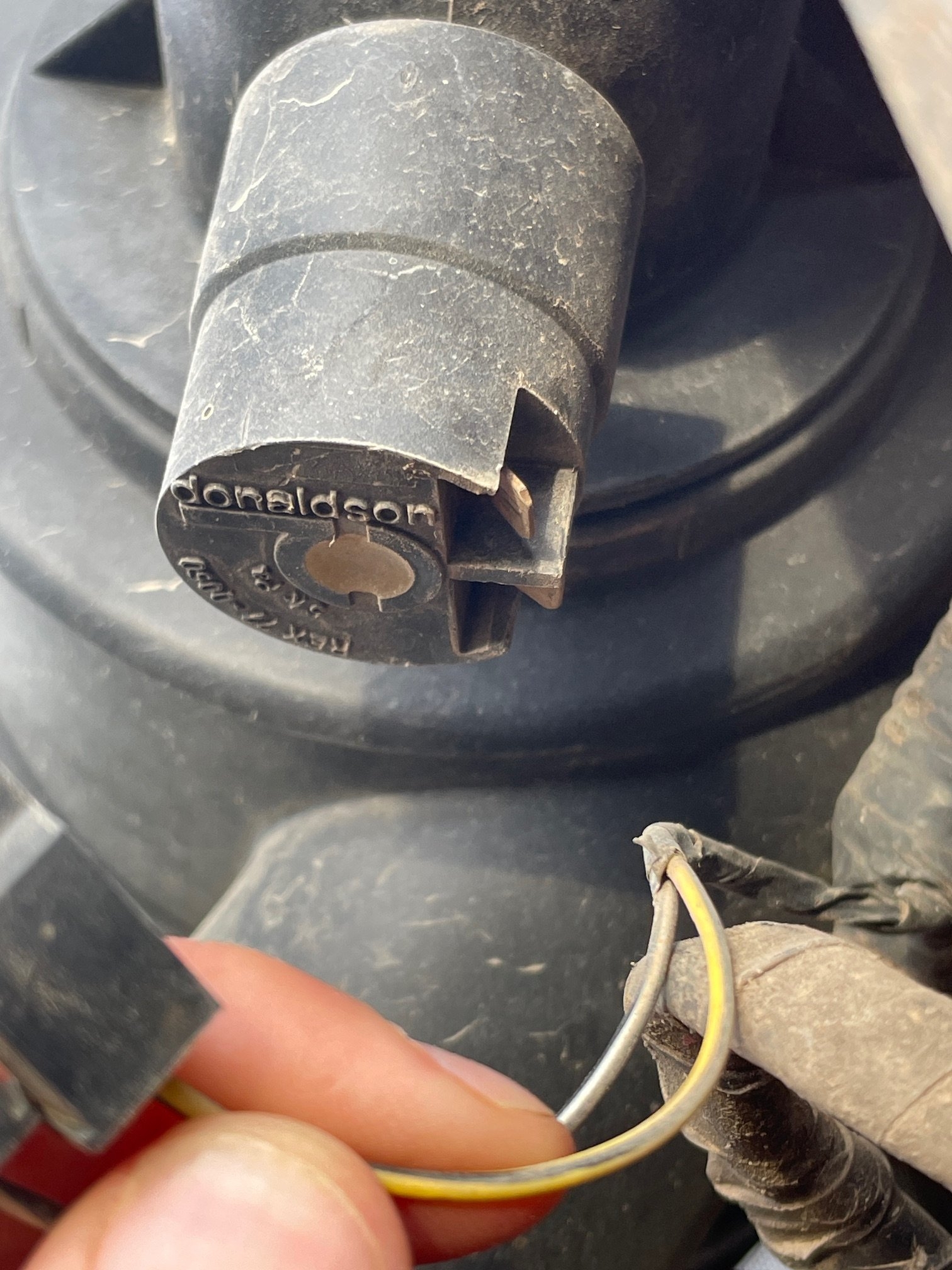

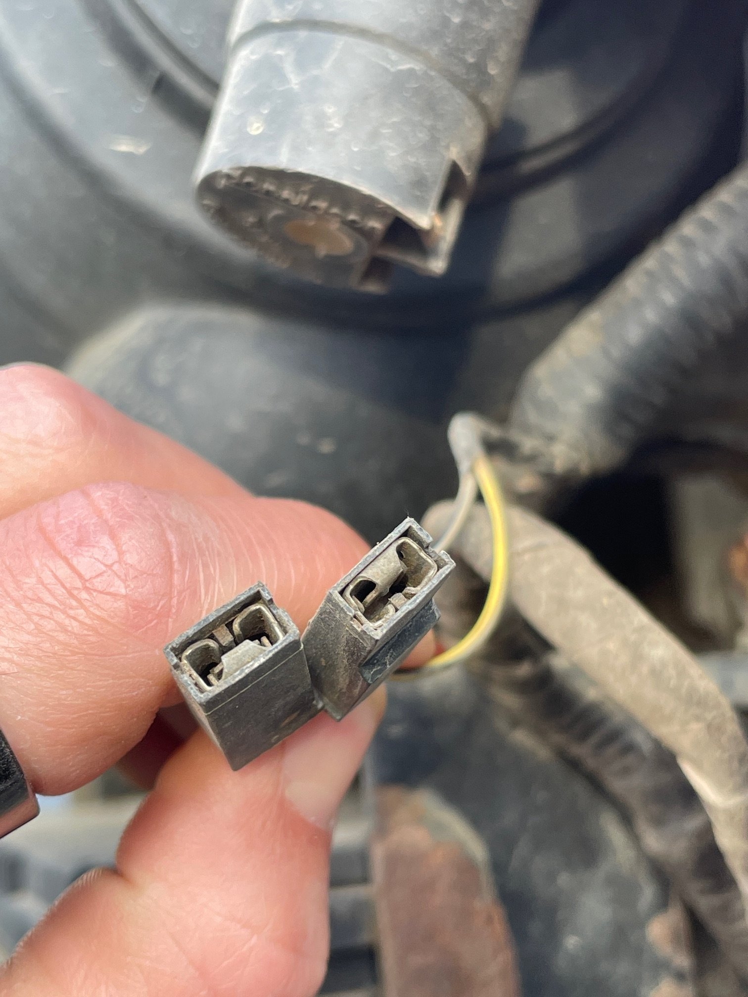

I thought it might be because I found the plugs for the air intake indicator were unplugged. I also wondered if maybe the Check Engine light could be on because I bought it from Oklahoma, and the tractor is now at elevation at my house near Steamboat, CO (8500').
I tried plugging the wires back into the air intake indicator, but was unsure which prong the positive & negative wires were supposed to go to. I tried reconnecting them, and the Check light still displayed after turning the tractor back on. I tried swapping them, but still no luck.

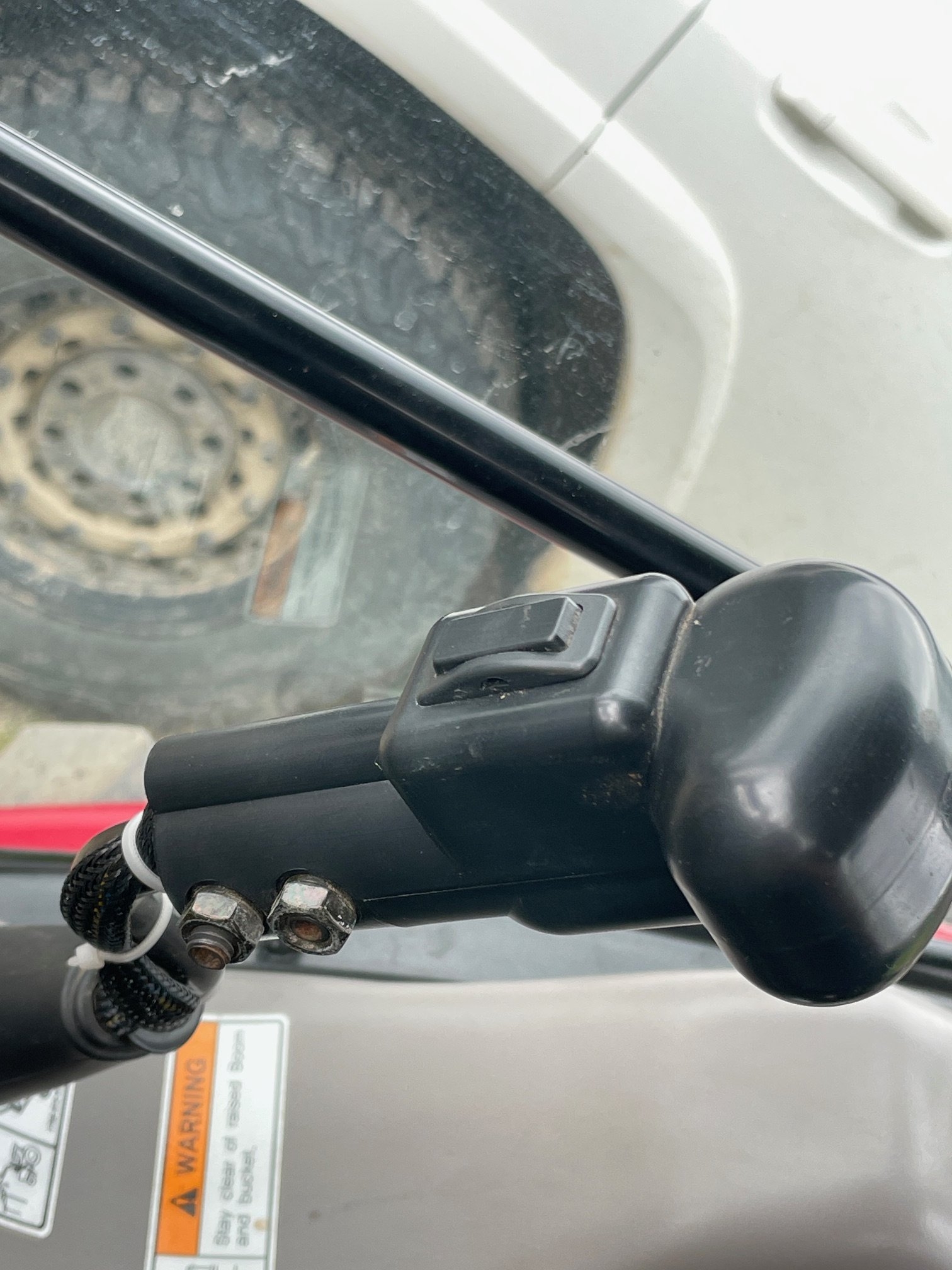

The last question is, what does the switch do on the joystick? I can toggle it up or down, but not sure what it's doing.

I don't have a cab version, but normally the button on your (joystick/shifter???) is for a 3rd function hydraulic implement like a grapple on the FEL (front end loader).

Confirmed that the switch on the joystick is definitely for the extra hydraulic lines for a 3rd function hyd implement.

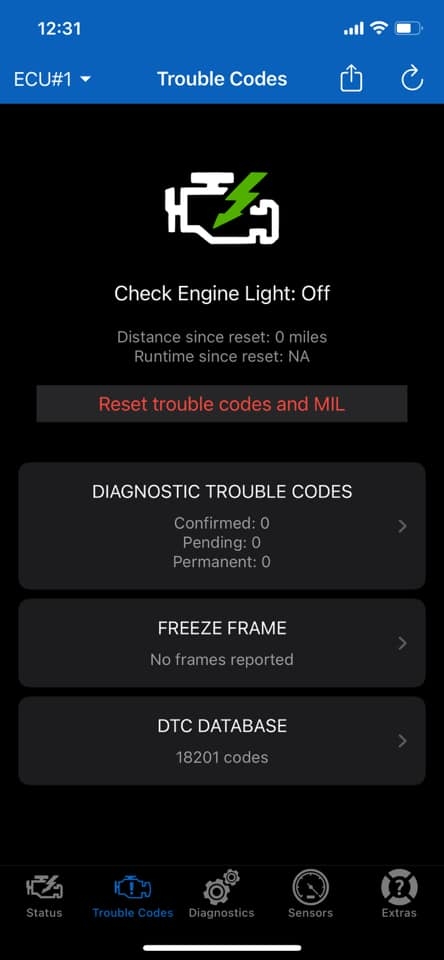

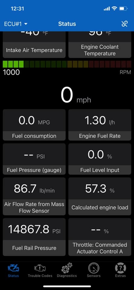

I just got my ELM327 OBDII scanner and hooked it up. I used the OBD Auto Doctor app (I have an iPhone / iOS, so I can't use Torque, which is the more common one I see online).
It's actually telling me the Check Engine light is not on... Am I misinterpreting the light on my dash? When I turn the key On, before starting the ignition, I do see the MIL light, CHK ENG, and a few others that all disappear after I start the ignition. However, the CHK ENG is the one that stays on, not the red MIL. Here's some diagnostic pics. Any advice, or anything that stands out?

It looks like on your OBD reader you have the opportunity to "reset" the trouble codes. I read that as an opportunity to clear them. It could be that the code that triggered the Chk Eng lite is no longer valid (kind of says that on your OBD screen).
Try erasing the codes. Shut down the tractor, let it set for a couple of minutes and then restart and see if the Chk Eng lite goes out.
