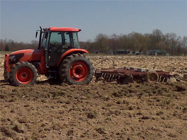

I really can't say. I have since added additional rear weights for traction control when plowing. Also when loading hay to go out I no don't have to have one on the rear anymore. FYI with the added weight the vibration has completely stopped. The dealer said it was the NEW wearing off the tractor. (Not sure I believe that, but it has stopped.) Here is a pic of the rear weights, I was discing, sorry for the low quality phone pics.
I was wondering if lt had anything to do with the tires needing to wear in a little. It you dont mind me asking what did the rear weights cost and how heavy were they? I noticed in a earlier post you said the front and rear tires were filled are the tires still filled and you added the weights for additional weight?

Did it do it in 2wd? If 4wd only the front lead and sharp new treads could be the issue.
Could be sharp edges on tires i guess. All four tires are loaded, also 4 150lb weights, 600lbs total (2 on each side of rear) $500 in black with mounting hardware.
larry
It did it in both 2 and 4.
