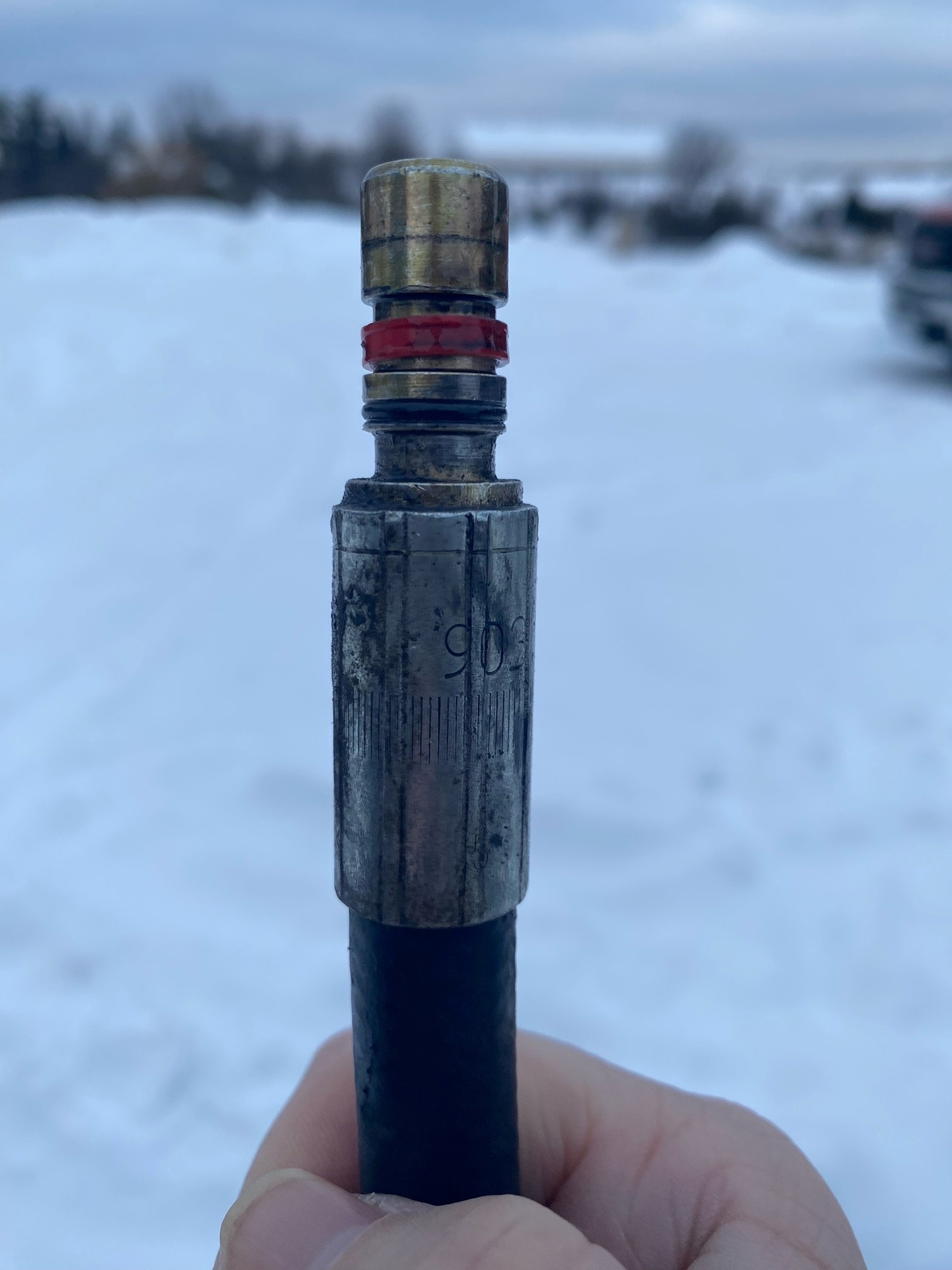

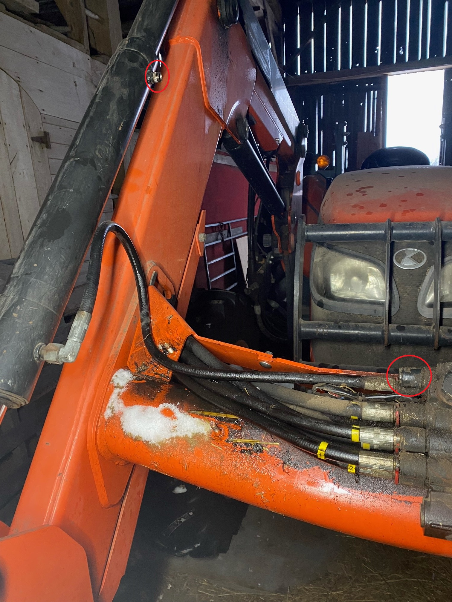

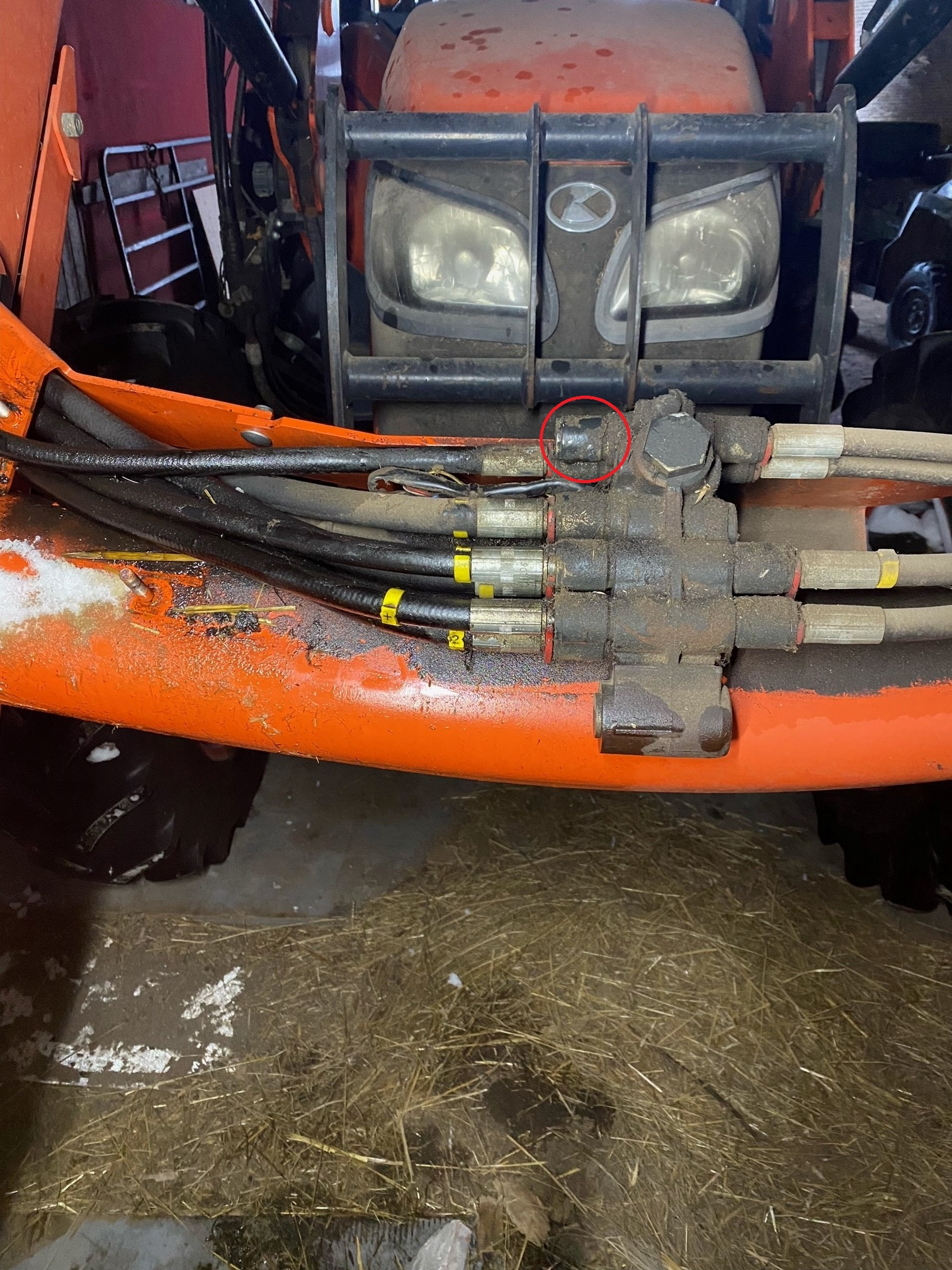

My M35 loader rubbed a hole in the hose on the upper right hydraulic cylinder for the bucket curl. Can’t get a custom hose made because one end of the hose is proprietary (uses a red plastic circlip to hold the connector! Anyone have a part number for this hose?

Wow, the M35 in your manual looks very different from mine. I don't have any steel lines on my M35 at all. Anyway, on further inspection, the so called non-standard connector had a number stamped on it: 9031142. Google has it as a New Holland 9032604 (which supersedes 9031142). The picture of the New Holland part matches the hose too.

Wow, the M35 in your manual looks very different from mine. I don't have any steel lines on my M35 at all. Anyway, on further inspection, the so called non-standard connector had a number stamped on it: 9031142. Google has it as a New Holland 9032604 (which supersedes 9031142). The picture of the New Holland part matches the hose too.View attachment 785649View attachment 785650View attachment 785651

That's indeed a special fitting. Looks like a swivel joint that allows the hose to swivel easily under pressure. A really bad choice as far as serviceability goes, in my opinion.
Hopefully you can find a replacement for it.
